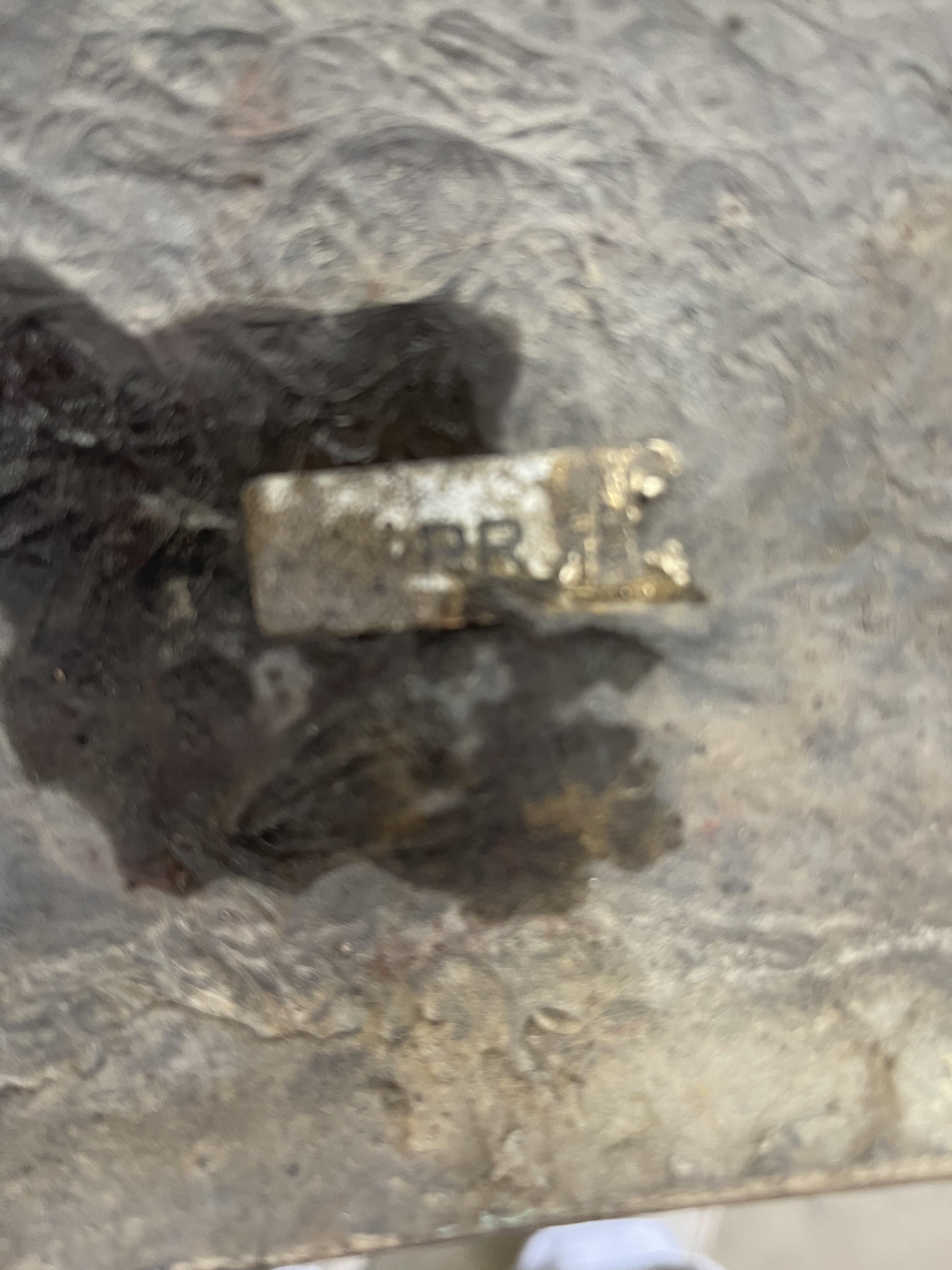

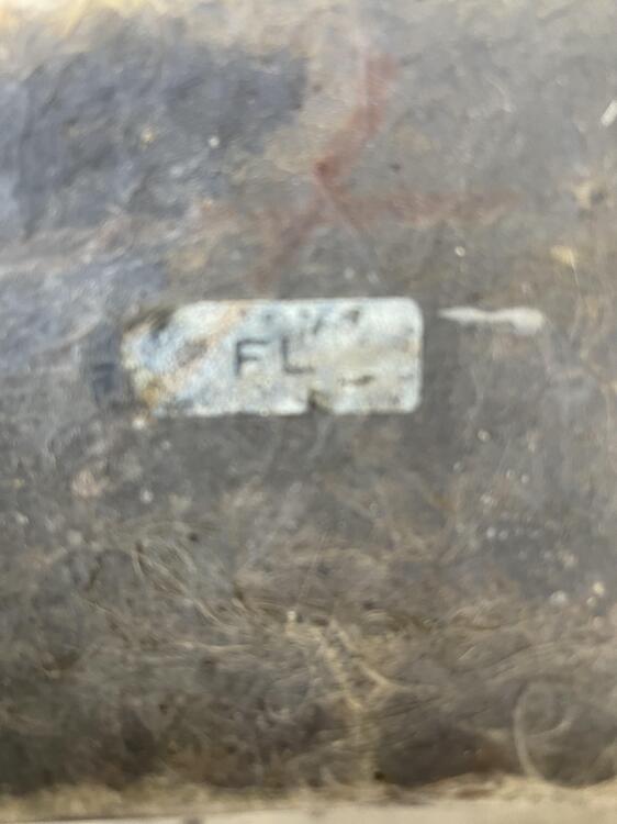

We have already removed the “flares….over fenders”    There is corner identification, but it is more on a small white or  silver tag like marked with 2 letter for corresponding corner.     I’ll have to look in morning to give better idea, or picture.

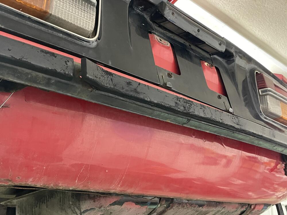

A rear bumper for HZG, please note the color of the bumper.
It is not the same color with the tail light trim panel. It is a little bit glossy.
And the bumper has a center rubber piece along with the center bumper.

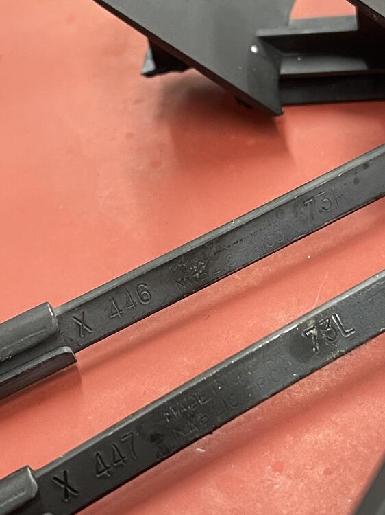

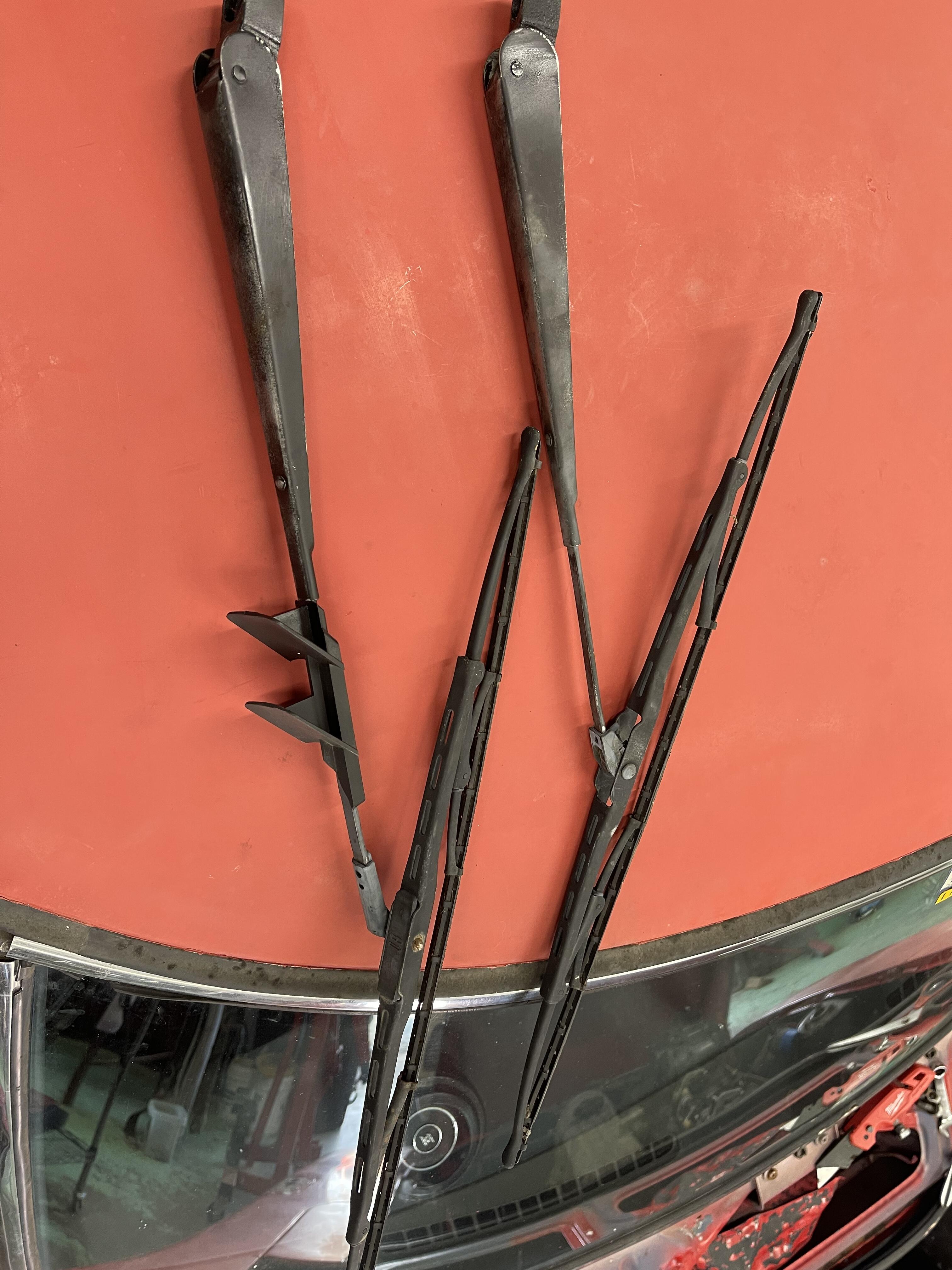

And Fairlady 240Z-L/ 240ZG have black wiper blades and arms.
Kats
Rubber strip on rear bumper does go a cross three piece.
   Have look at wipers  -and rear bumper color….. maybe a tough call on that….

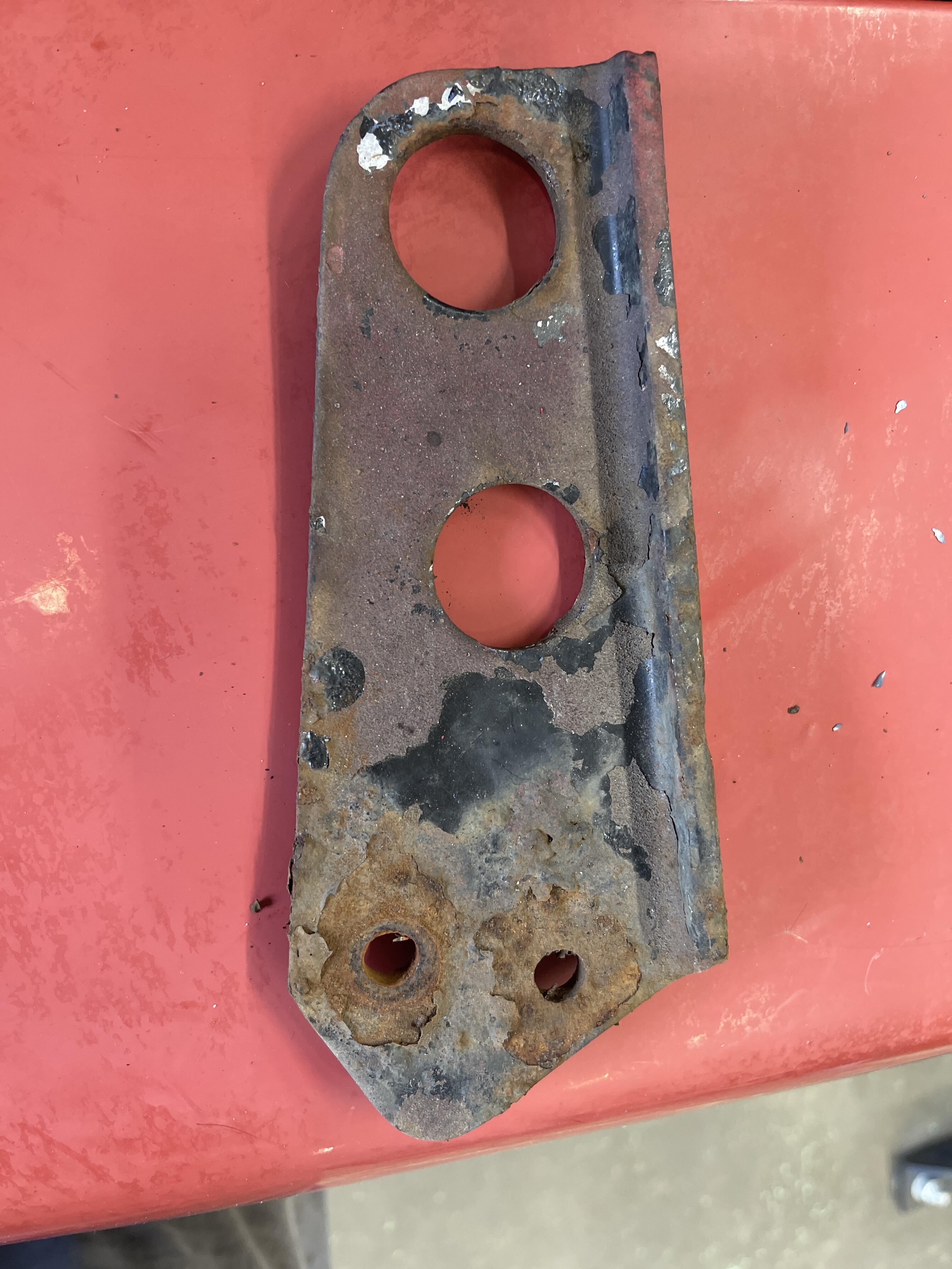

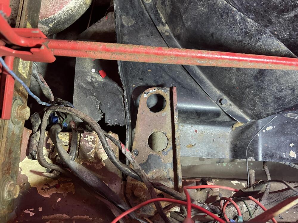

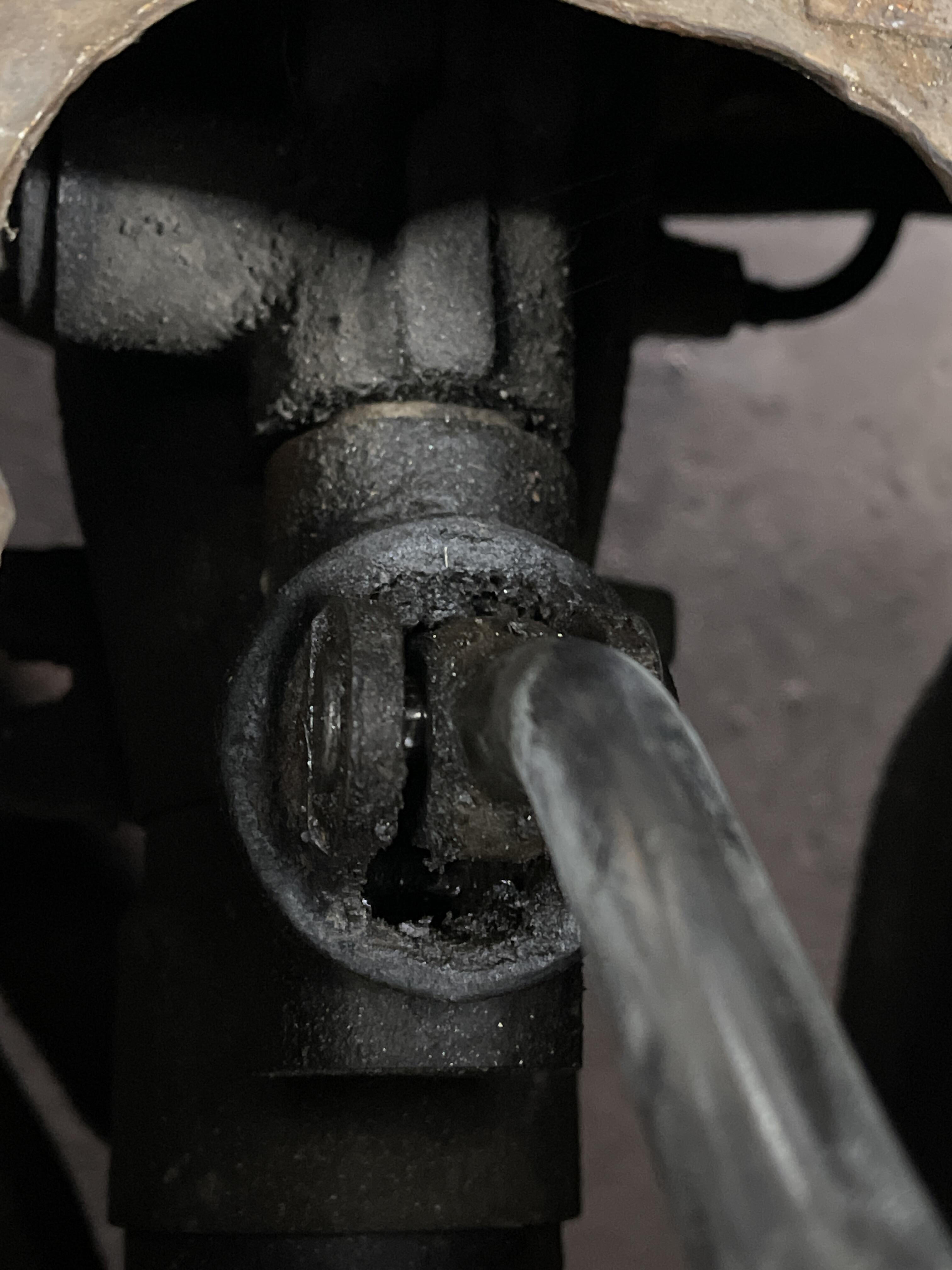

4091CC90-19E9-4BCC-89F7-3FF4C5F8D110.jpegTook couple of pictures of tow hook, turned straight and turned diagonal as your pictures show without the ductwork in the nose.  Strongly built tow 🪝
Thank you so much for taking many pictures, they looked genuine except the wiper blades. But, your wiper blades must have been provided from Nissan. At some point Nissan provided your wiper blades to customers when they got received the parts number of HZG and HZL. So, can I say that they are Nissan genuine wiper blades but shape is different?

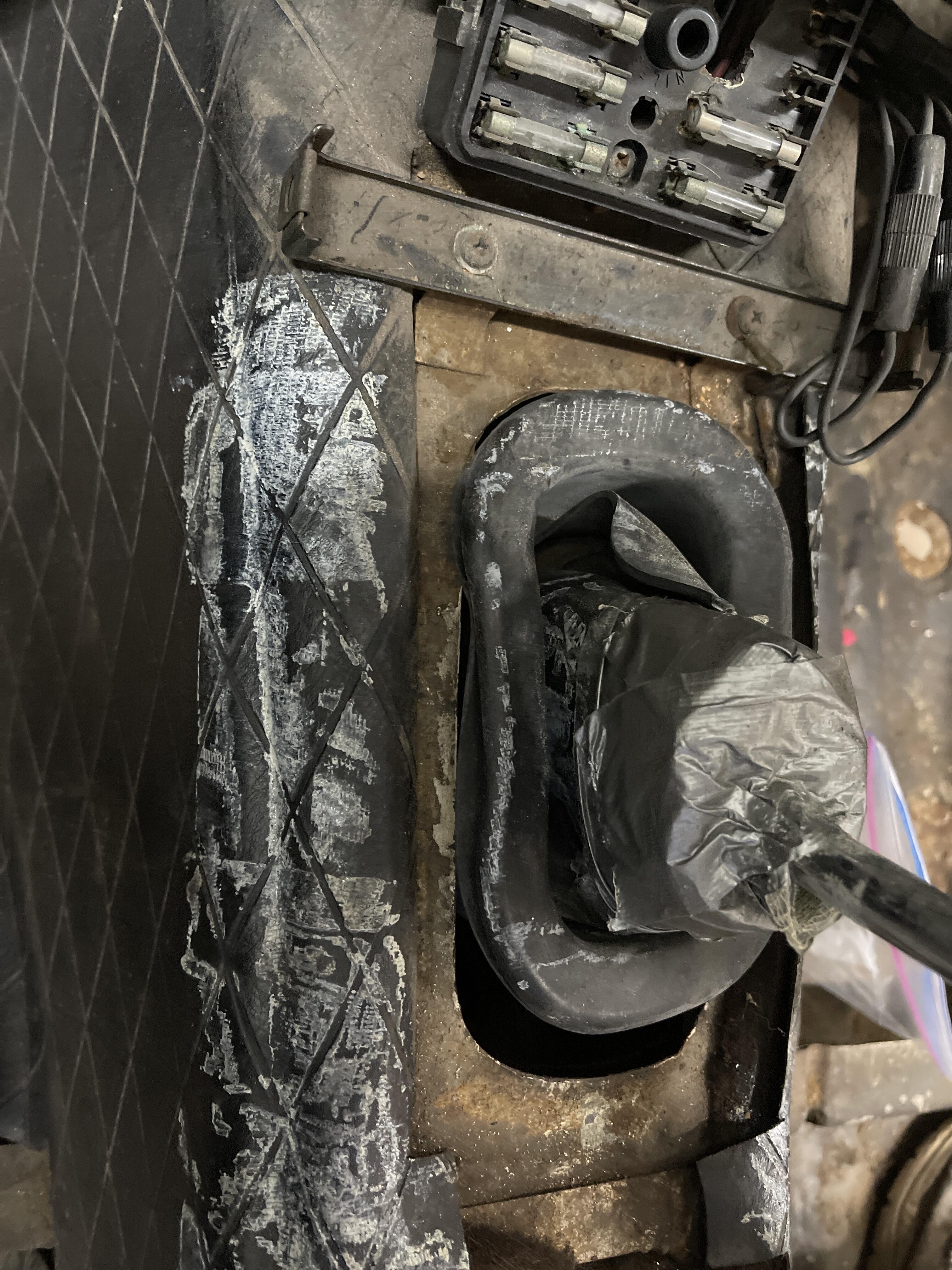

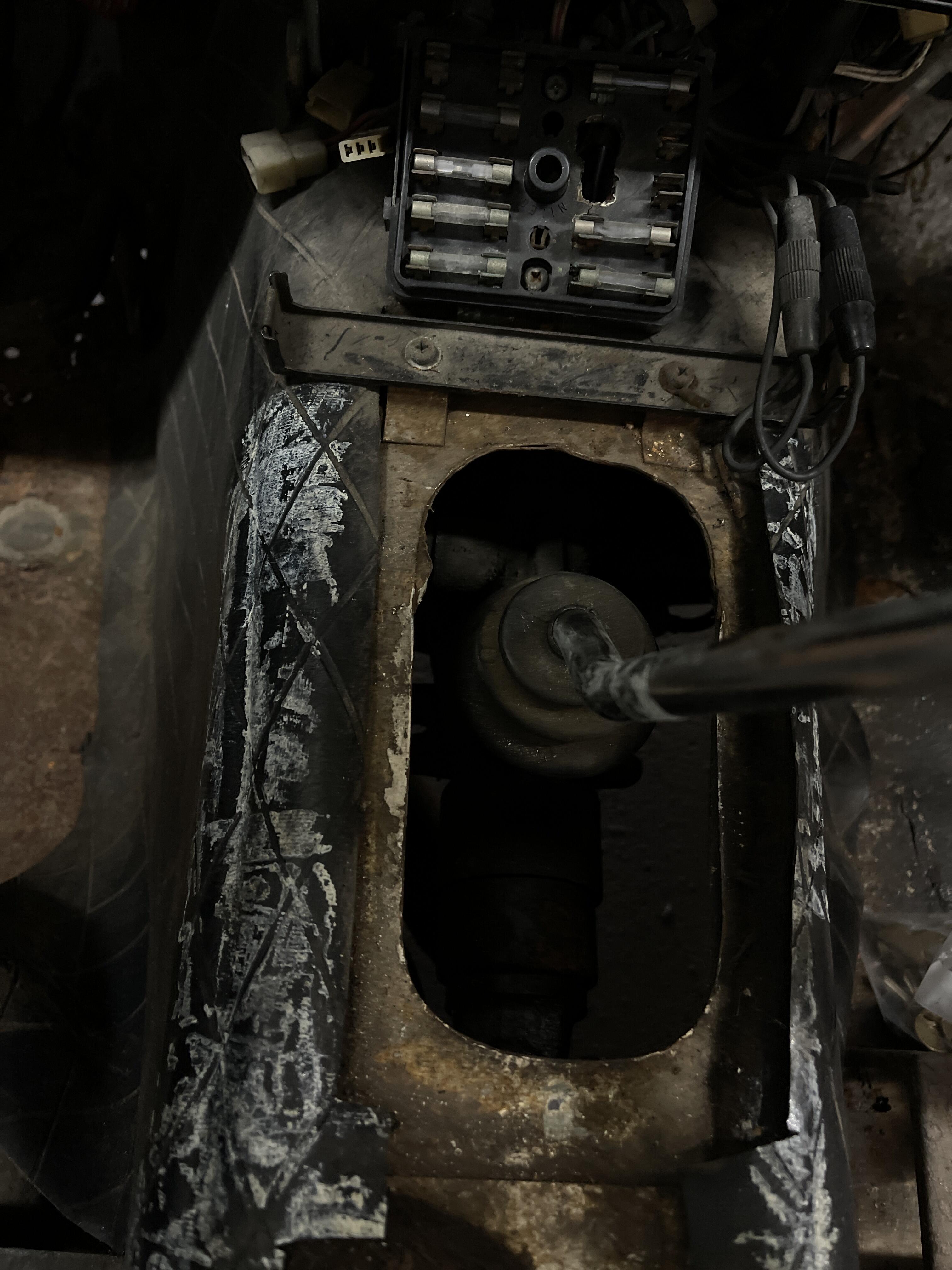

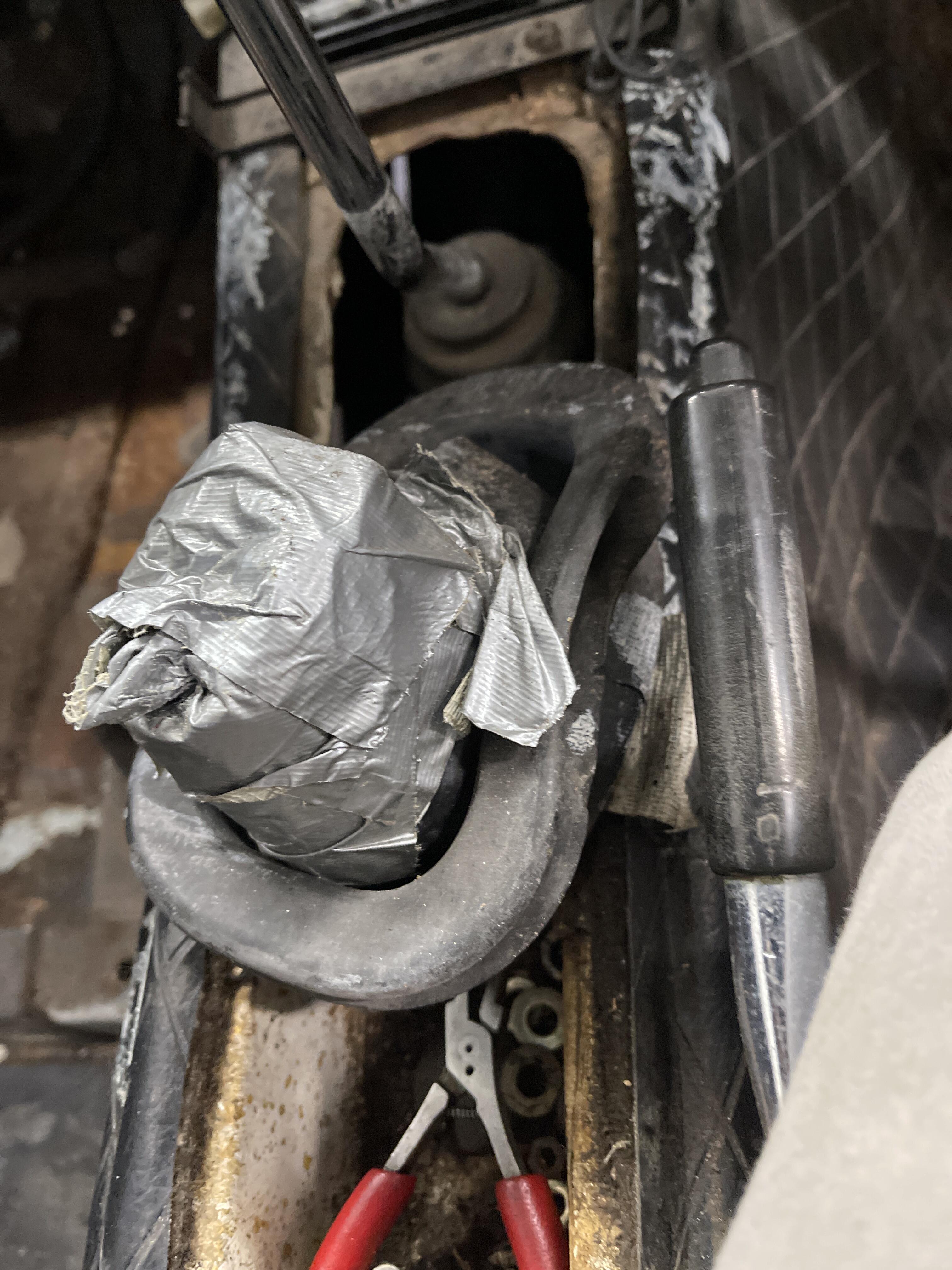

About the transmission, could you please take a picture of a little wider view of the cut out for the shift lever. I am assuming the cut out will be the same for FS5C71A.
Very interesting!
Kats
Original rubber boot wrapped in duct tape to help close off the enlarged hole in tunnel to facilitate the “newer” 5speed.    🥲
Wiper arms off the HS30 show 73R and 73L  compared to the 4 sets of spares I have that are 55R and 55L……35DAC398-D381-4853-9B1E-D09A60459C2A.jpeg

The rear bumper has been painted a gloss black to match the front and of course the rusty rockers.   A quick peak on the inside “facing car”  of bumper shows a maybe silver gray color…. Not chrome.  There are no marks we’re bumper guards would have been attached… on second thought did any of HS30 car have bumper guards?
       Rubber strip is present in center of bumper  although in poor shape.
