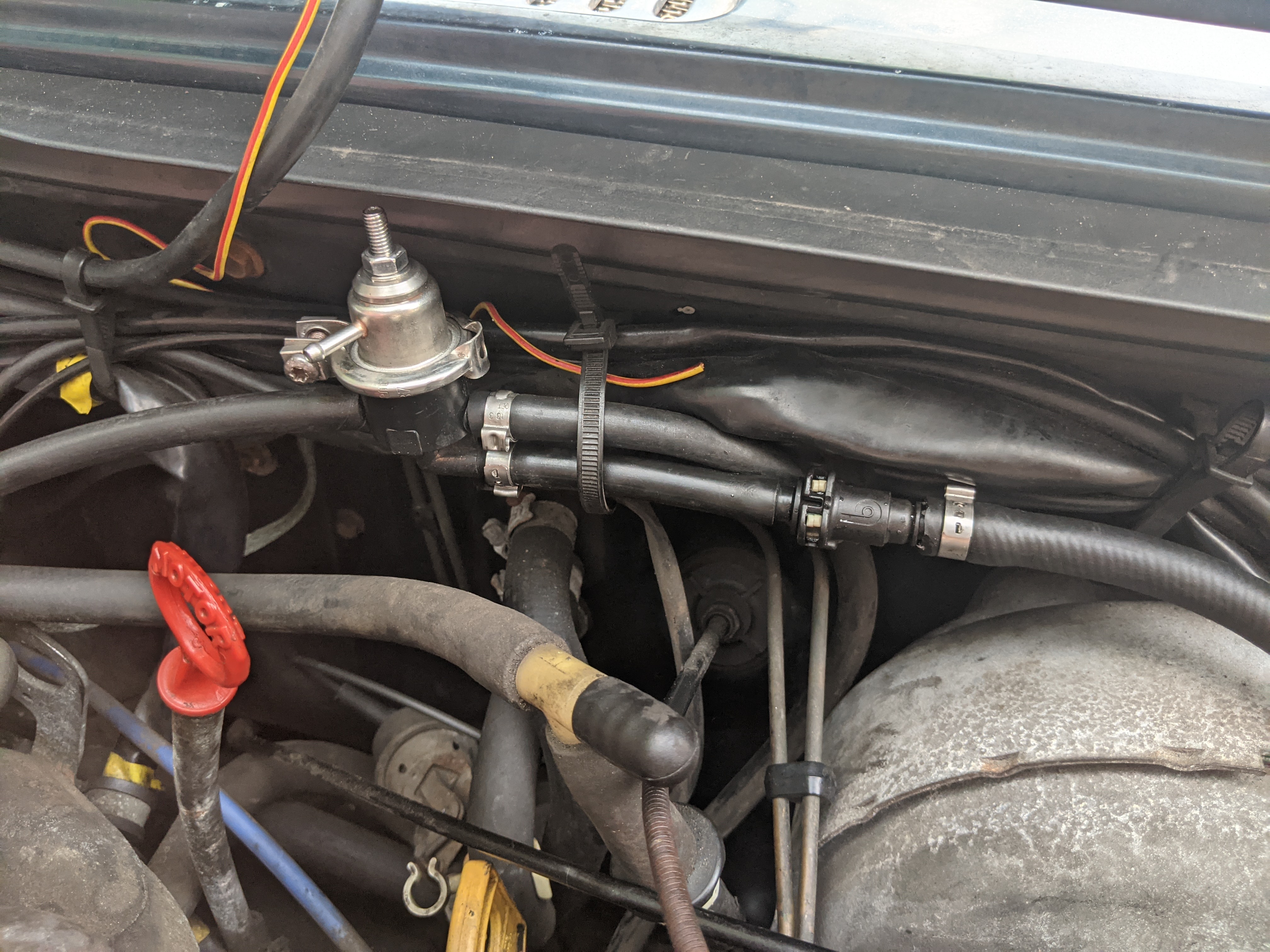

Do you have some internet links or part numbers?  I've found that many of the older parts that would be valuable for the Z's are not actually available anymore.  I built a vacuum reference adjustable FPR for my engine but now you can't get the FPR that I started with.  NLA.

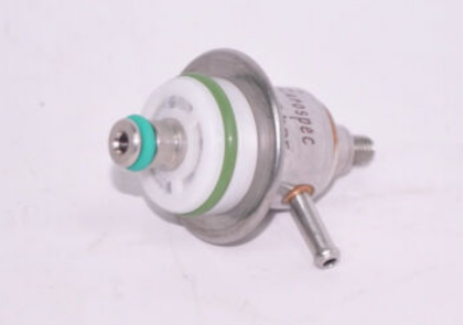

The adjustable regulator is this one: EuroSpec Sport. The standard (non-adjustable 3bar) FPR in the 2nd pic is what all Volvos & VAG came with. The black plastic pod that it sits in is a separate part that was only sold with the feed & return lines attached, so pretty much the only way to get it is to cut it from a parts car.
The Volvo 3bar FPR is PN 9404583 for reference. They don't go bad, so if you were going to use one, I'd get it used.
EDIT - VAG # 037133035C  Bosch # 0 280 160 557

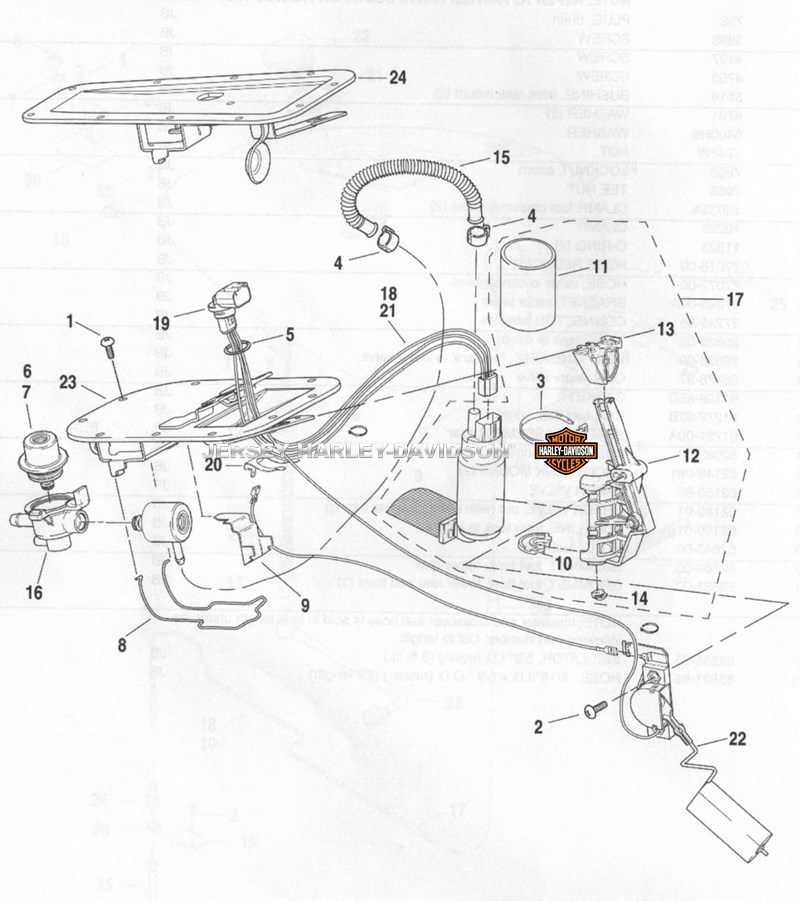

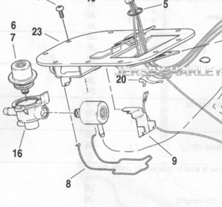

https://www.denniskirk.com/v-twin-manufacturing/fuel-pressure-regulator-housing-63773.p1802126.prd/1802126.sku

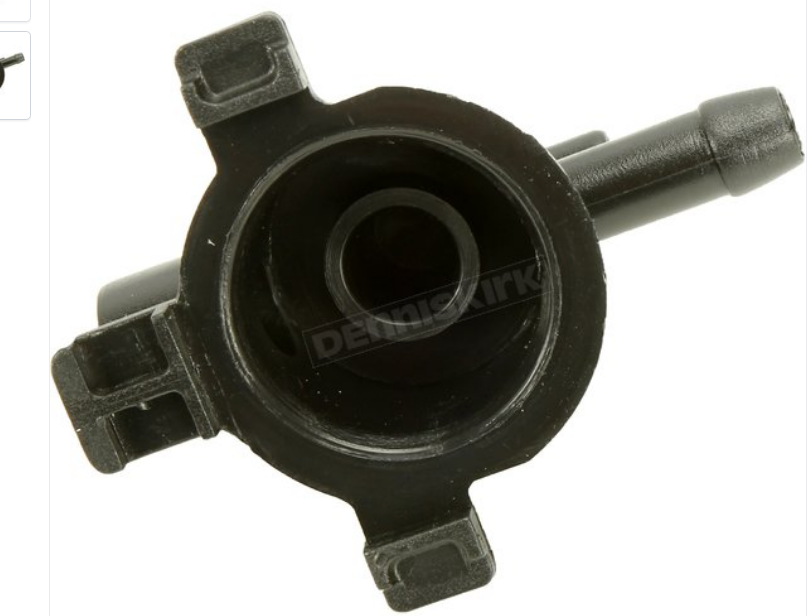

Trying to find a schematic - typically the bottom-most port is the return - the I/O are in line with each other in the larger housing, so that female side may take some sort of push fit line, I dunno.
EDIT - yeah the female is the inlet, looks like the have a designed filter pressed into that
