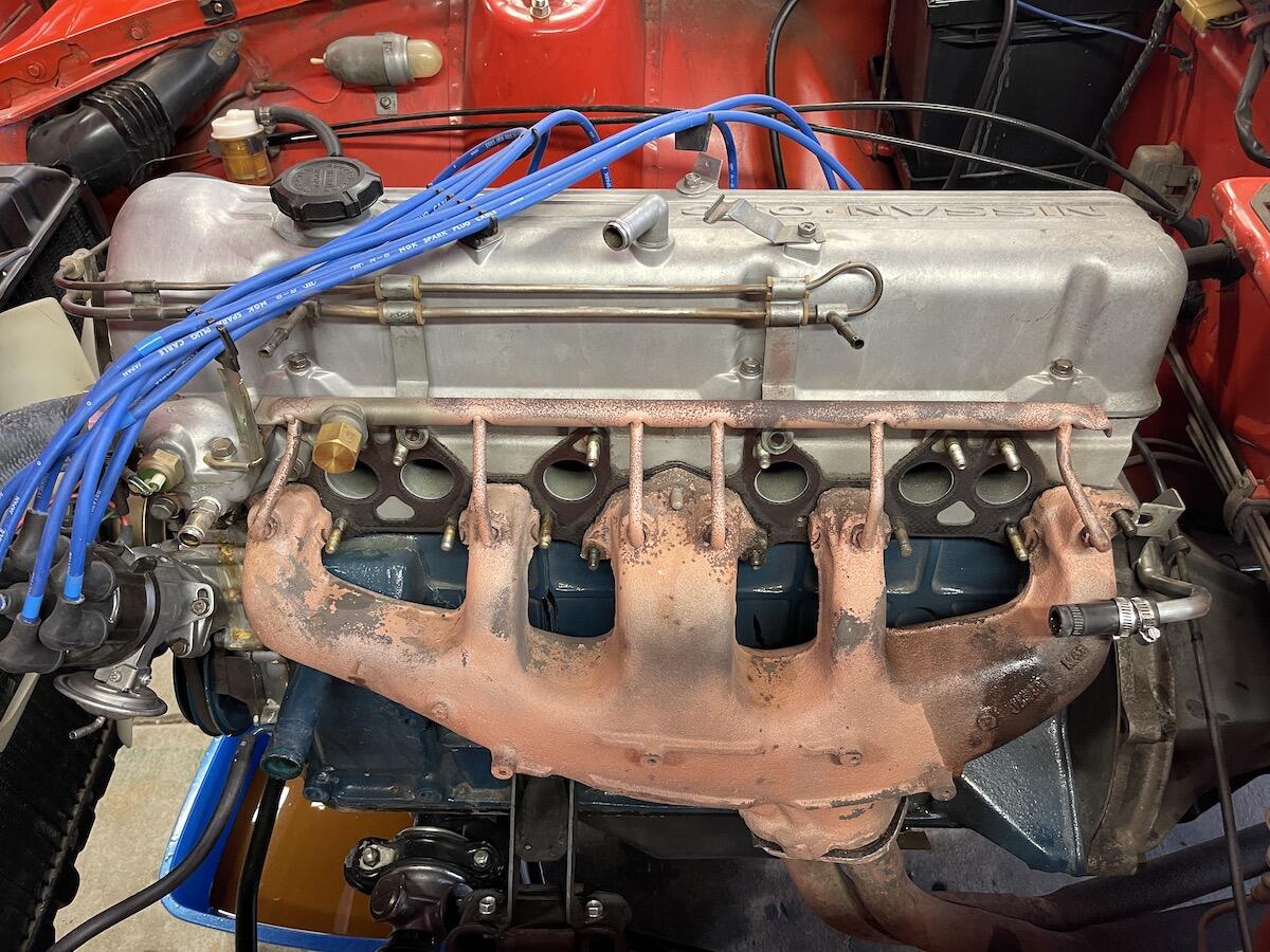

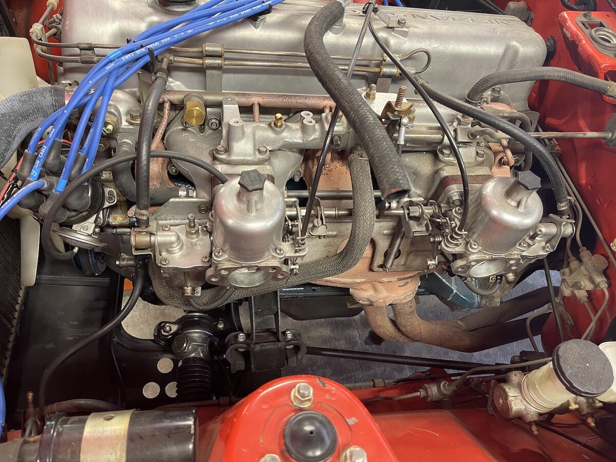

Here's what I'm starting with, which all has to come off:
Here's the monstrosity to be removed.  I've tried to keep this car pretty much stock, but removed the smog pump a few years ago which helped it run better.  So now a header, since the exhaust pipes are getting a few pinholes.  Figure if I'm doing the exhaust, may as well go the header route now.

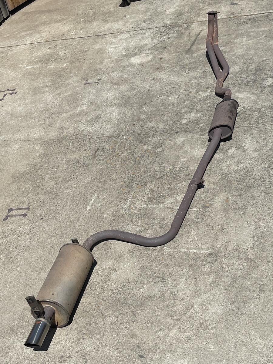

Here's the old Nichara system dated 1984.  Mufflers still seem solid, just the pipes are getting bad.  Anybody wants it come get it.  🙂

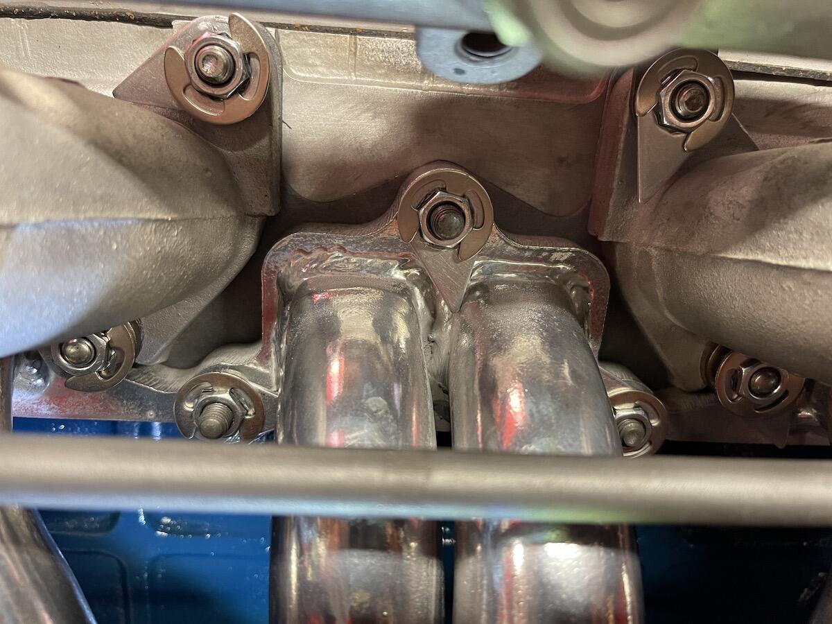

Already had the MSA studs installed when I rebuilt it a few years ago.

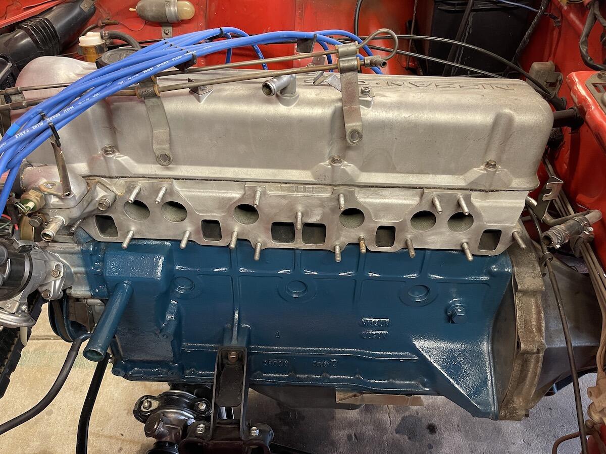

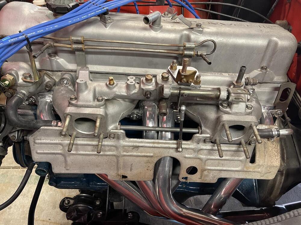

Dry fit to make sure it clears everything, thermostat housing, etc.  Did have to remove that tray like thingy-ma-jig bolted to the oil pan bolts, not sure what its purpose is.
I did use the Stage8 locking nuts, we'll see how they work.  I may regret this if I need to re-torque nuts.

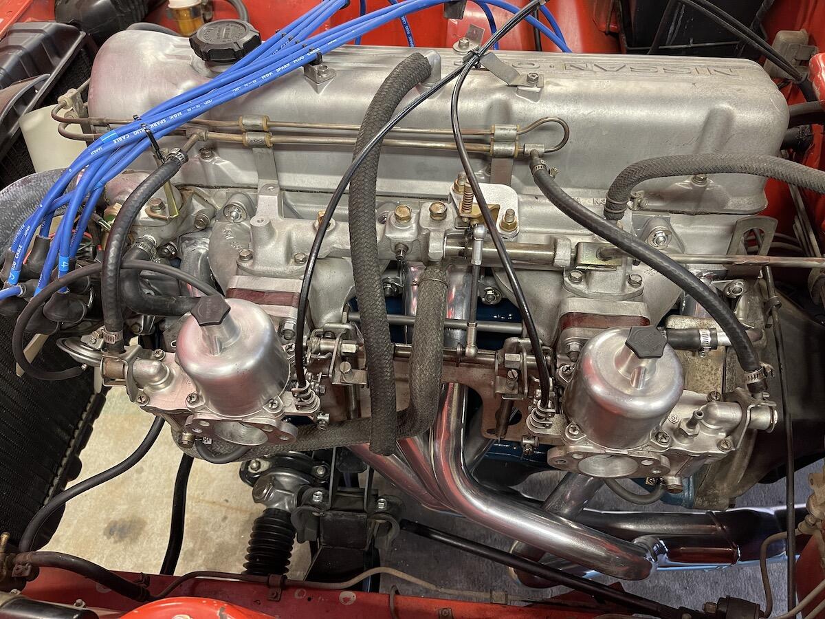

The shield fits nicely.  Love the thick flange on the header, and not having to mess with stepped washers for the 6 studs between exhaust and intake.
Finished with header.  Overall, pretty easy job.  After adding new coolant, started it up.  It's going to be a noisy drive to the shop tomorrow!

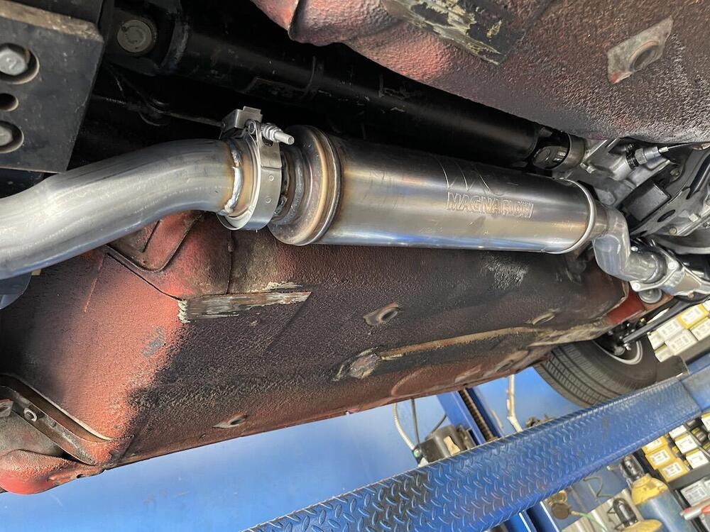

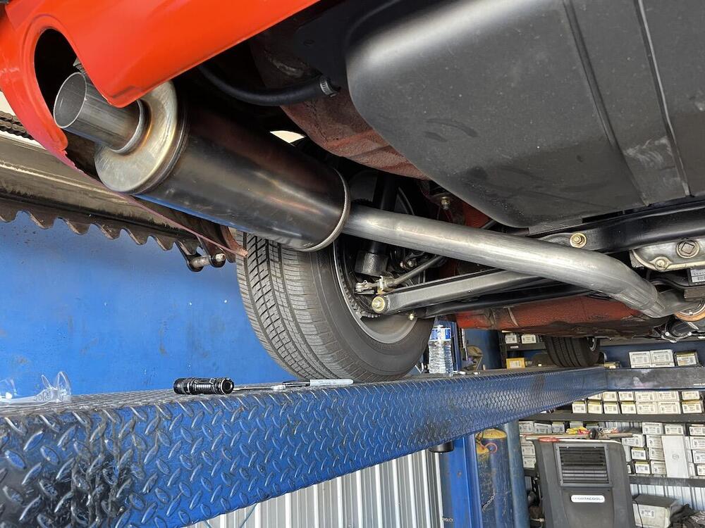

I got the exhaust finished this morning.  Went with 2.25" pipe to keep a little bit of the low end torque. Plus this car will likely never have side draft carbs, bigger cam, Robello, etc.
Used the Magnaflow 10425 in the middle, with a V-band clamp behind it.
I was going to use an oval turbo style at the rear, but the guy talked me into using a 6 inch round 14" long MagnaFlow 12615 instead.  Said it would be a little quieter and wouldn't have to mount it at a weird angle.
They didn't have much of a selection for old school tailpipes, but ended up with this stainless tip, which they found in their old stock.  And no U-shaped clamp showing out the back.  👍
It sounds awesome!  Not a tinny sound, but deeper.  Pretty loud at the high end, but pleasantly quiet at cruising speed while being able to enjoy the radio.  Perfect for an old guy.  And it does seem to pull harder going through the gears with the header, at least by the seat of my pants.  I may have to upload a driving video.  😉
