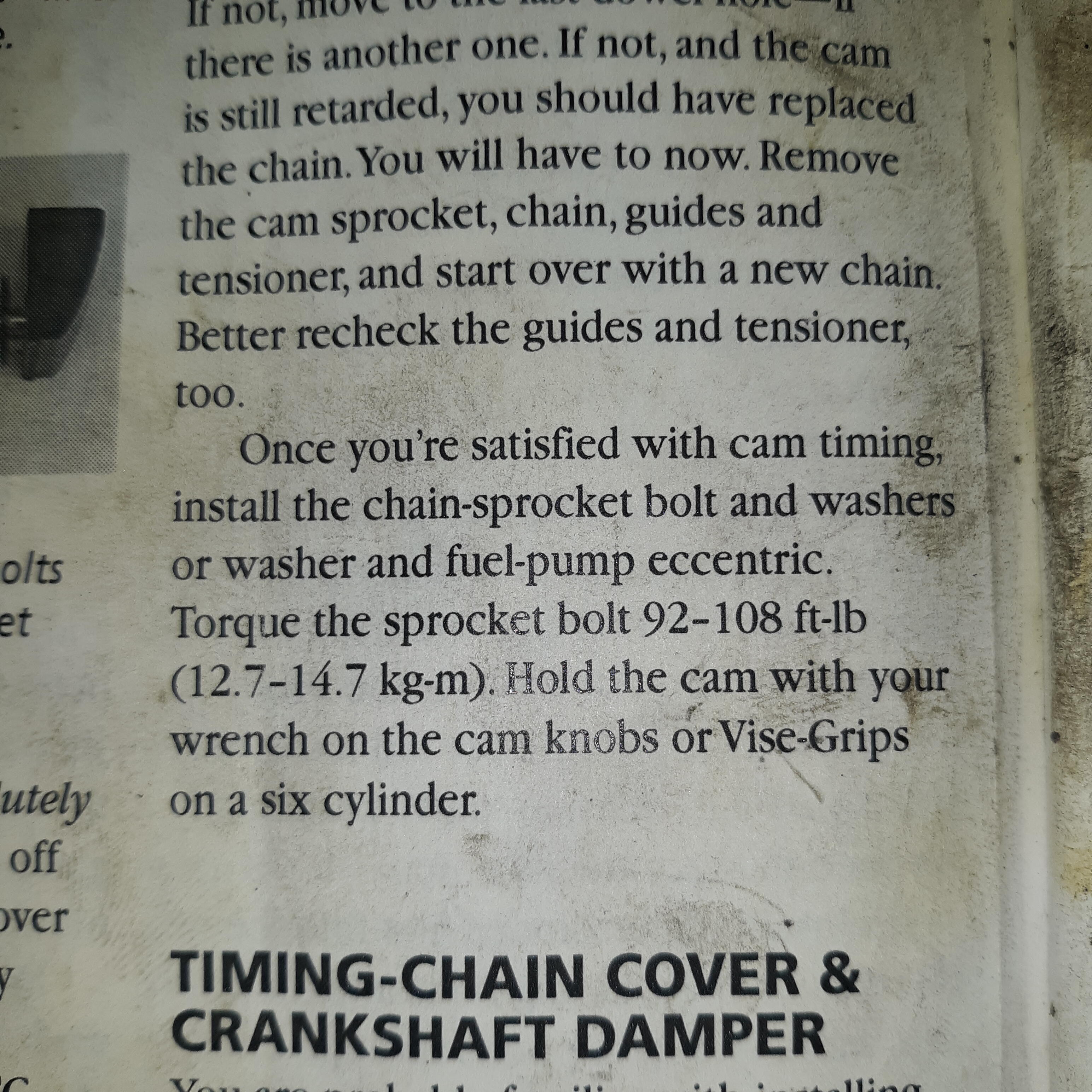

I know you said you don't want to get on the cam but I've put vise grips on the rough section between the lobes with the straight arm of the grips against the driver's side of the head many times to torque mine. Never had anything but good results. 80 ft. lbs too.
