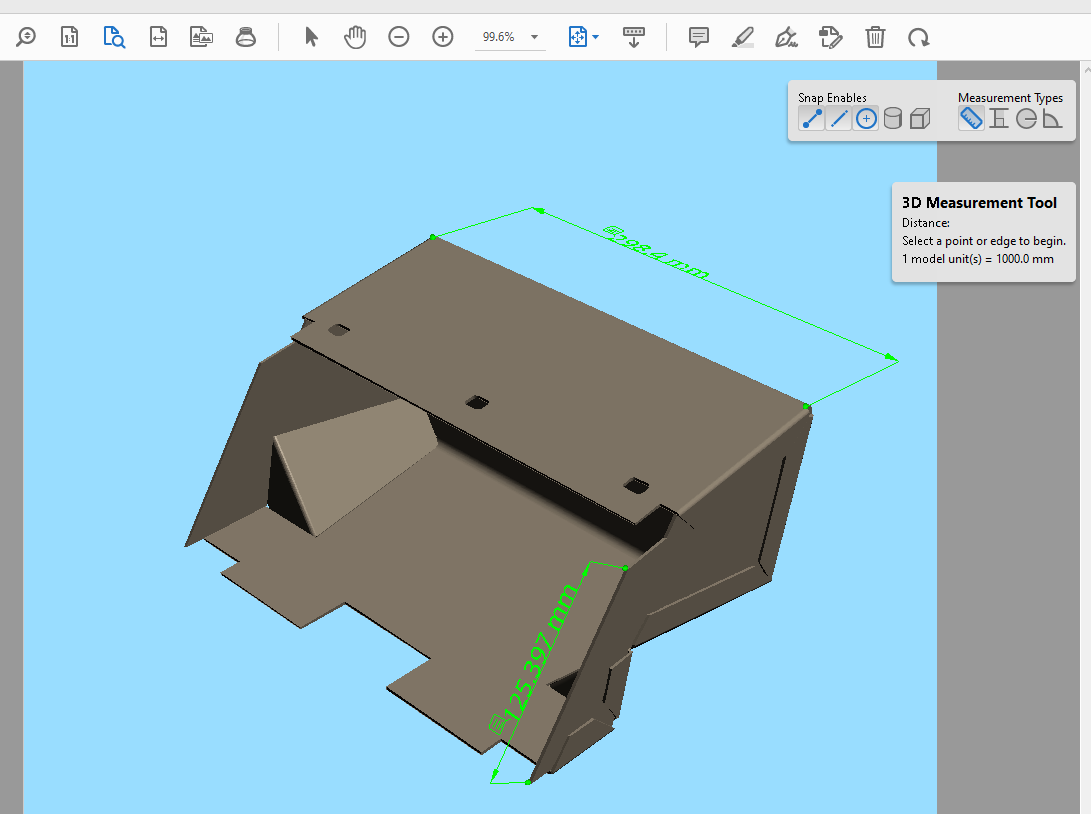

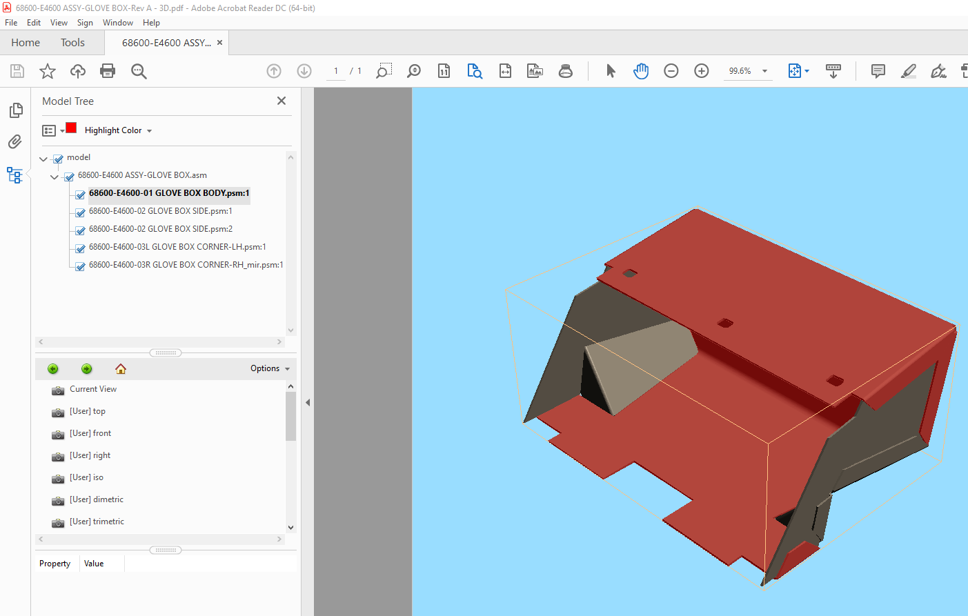

FYI, In the files I uploaded I also included a 3D pdf file that can be opened with any recent Adobe Acrobat Reader. The 3D pdf viewer allows you to rotate, pan and zoom etc. and also to see a model tree and isolate individual parts.
You can even use the measuring tools by right clicking to see the options,
