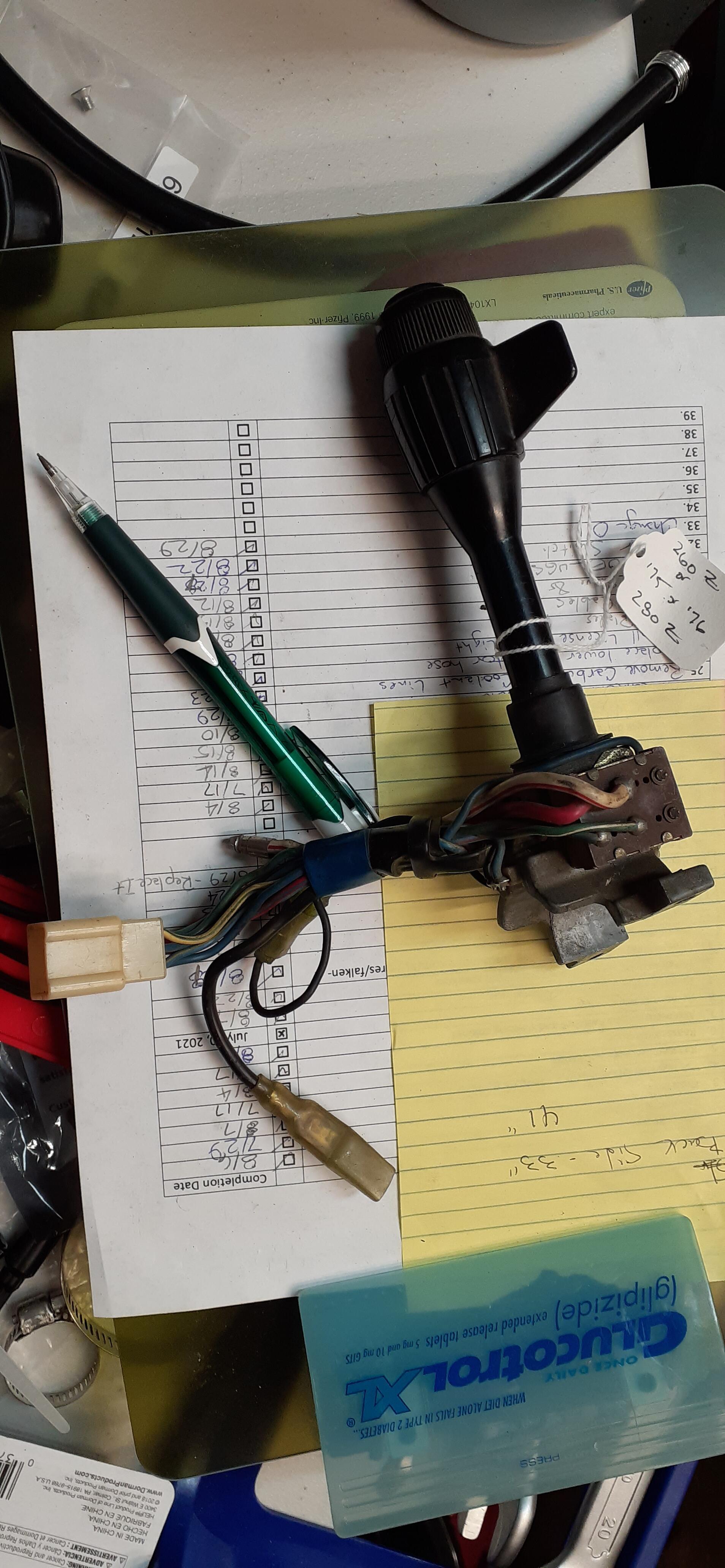

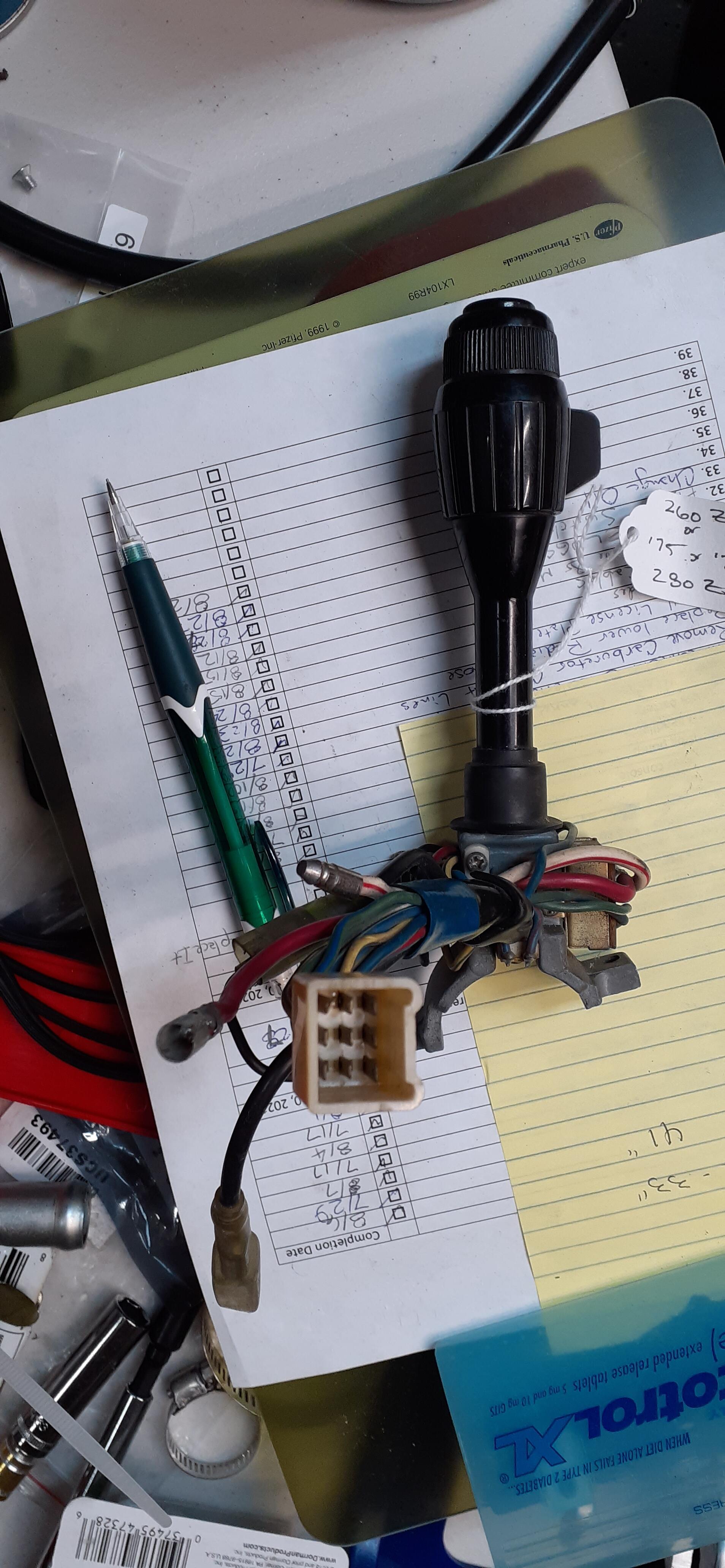

The 9 pin connector looks like this:
The 6 pin connector is much flatter and wider.
