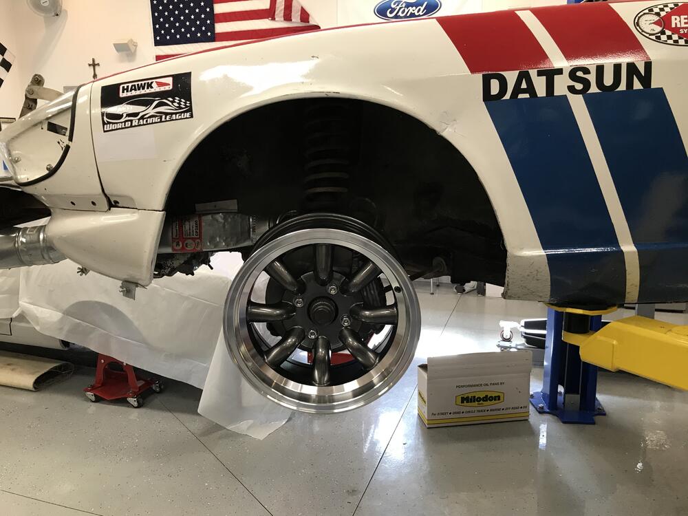

I am in the process of building/installing vent/cooling hoses to the backing plates on my 73 240Z race car and noticed at full wheel turn the tire will contact the hose quite a bit. I have seen them flattened but wasnt sure if that was the best way to go?
I use aluminum dryer vent and flatten it.  It's not pretty but it does the job.  I have better pics, but not on this computer.IMG_2180.JPG
