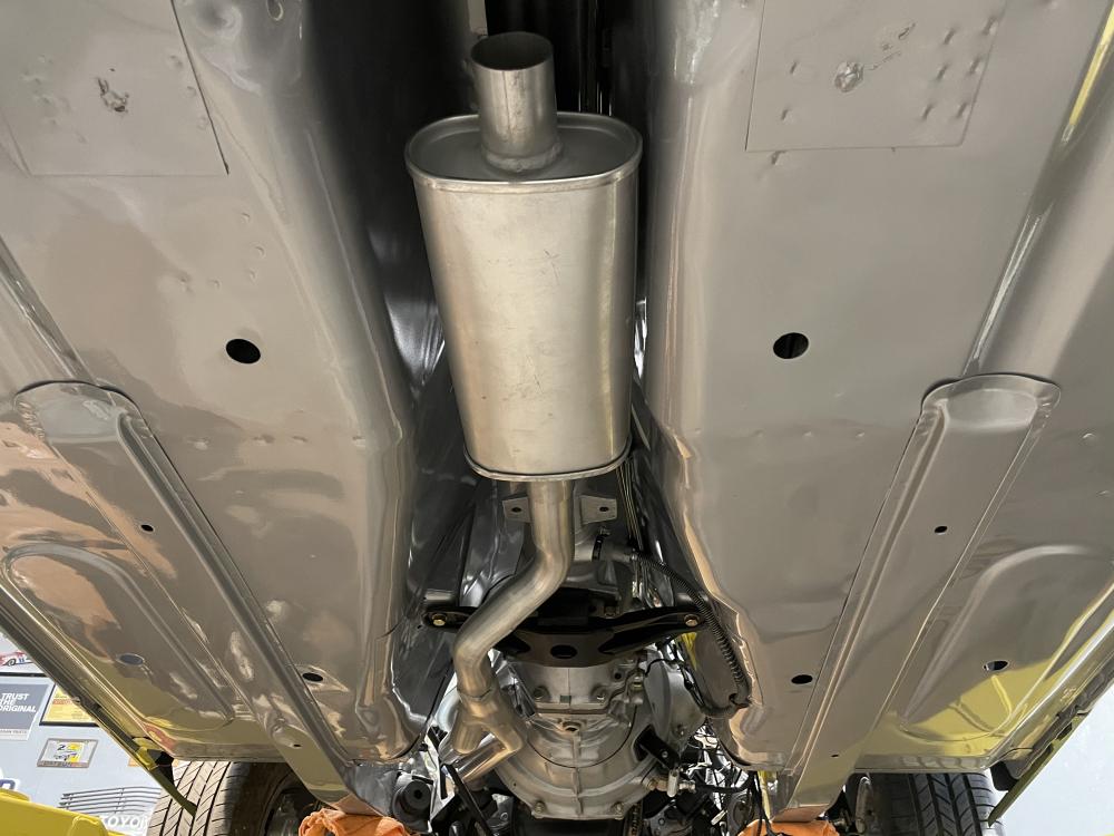

June 7, 20214 yr Author comment_622925 Fit looks great. Ideally it would be an offset inlet/outlet. I can cheat the downpipe over a tad and have plenty of room on the RH side Link to comment https://www.classiczcars.com/forums/topic/65418-search-for-an-original-240z-resonator/?&page=2#findComment-622925 Share on other sites More sharing options...
June 7, 20214 yr comment_622951 Chase, Great solution. Please provide a link to muffler supplier. Thanks, Keith Link to comment https://www.classiczcars.com/forums/topic/65418-search-for-an-original-240z-resonator/?&page=2#findComment-622951 Share on other sites More sharing options...
June 7, 20214 yr Author comment_622955 33 minutes ago, zed2 said: Chase, Great solution. Please provide a link to muffler supplier. Thanks, Keith Keith! Hope all is well on your side. Link to the muffler: https://www.performanceexhaust.com.au/p/5-X-3-OVAL-12-LONG-1-3-4-C-C-GLASS-PACKED/A318GP For some reason the website checkout will not allow for a US based address. Shoot them an email and they'll send a Paypal invoice over directly. Took only a few business days to get to my door step. Now if I can get the section of pipe between this and the rear muffler bent up I'll have a complete setup. Link to comment https://www.classiczcars.com/forums/topic/65418-search-for-an-original-240z-resonator/?&page=2#findComment-622955 Share on other sites More sharing options...
June 7, 20214 yr comment_622956 Chase, thanks for the link...I had this one on my radar: https://apexhaust.com.au/5-x-3-x-12-inches-long-cc-1-75-inches Keith Link to comment https://www.classiczcars.com/forums/topic/65418-search-for-an-original-240z-resonator/?&page=2#findComment-622956 Share on other sites More sharing options...
June 7, 20214 yr Author comment_622957 6 minutes ago, zed2 said: Chase, thanks for the link...I had this one on my radar: https://apexhaust.com.au/5-x-3-x-12-inches-long-cc-1-75-inches Keith I came across three different shops (including the one you sent the link from) in Australia selling a 3" x 5" x 12" oval canister muffler. I would bet that they are all selling the same one, under different names. The one I received had no part numbers stamped on it, and actually came in a Mangaflow box (PN on box was for a completely different muffler). Curious where these are being supplied from. Link to comment https://www.classiczcars.com/forums/topic/65418-search-for-an-original-240z-resonator/?&page=2#findComment-622957 Share on other sites More sharing options...
