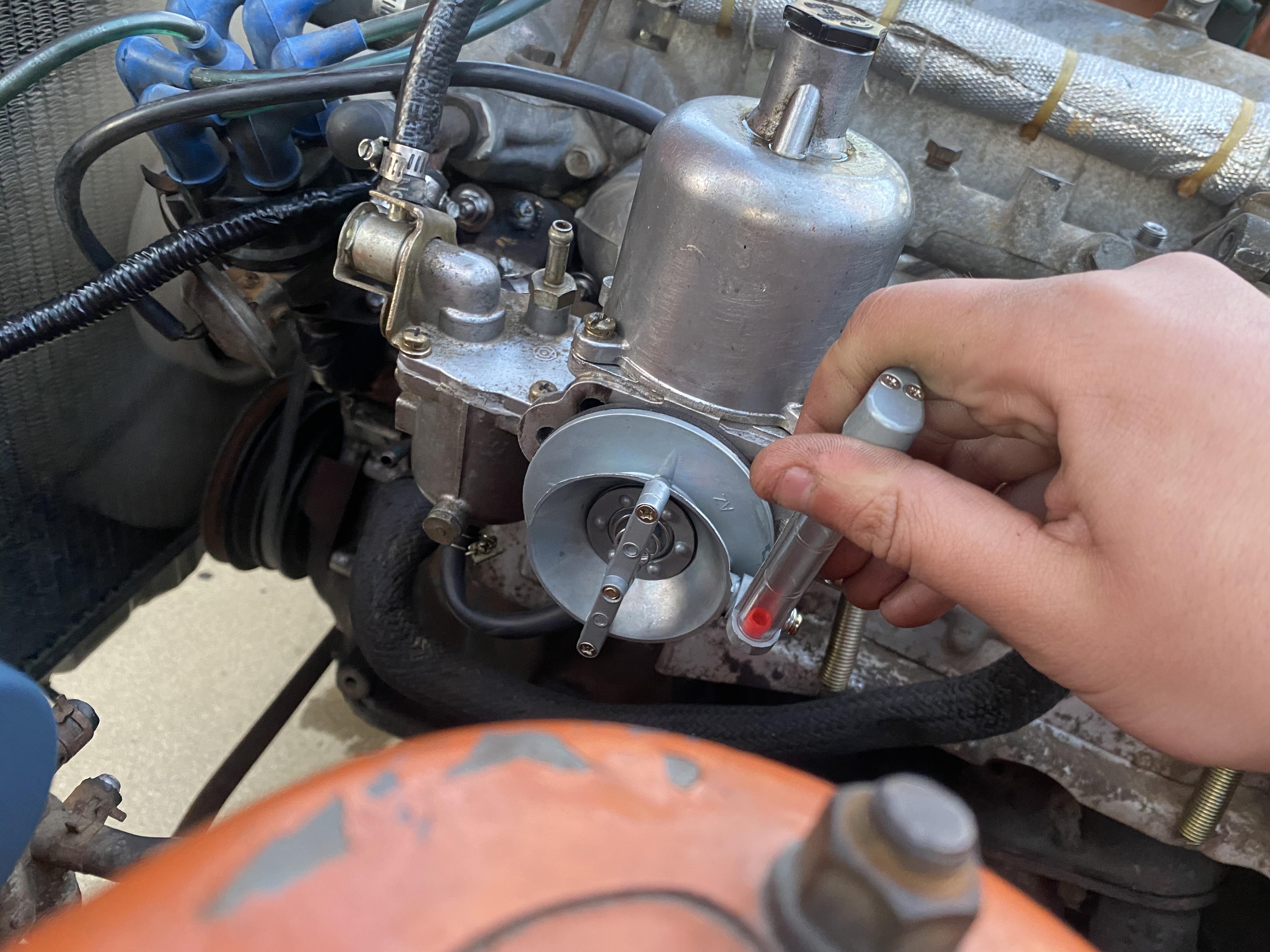

Thanks for the advice. I opened the banjo up to find a bunch of garbage in there filters looked fine but there was a lot of crud in there. I cleaned it up and later today I’ll see if it does anything thanks.
I got the car to idle 700-800 only when the Jett nut is all the way down. The front car feels like it isn’t running at all. No matter what I do with the flow meter the red ball doesn’t move on the front. She backfired a lot because it’s running way to rich

58 minutes ago, siteunseen said:
After thinking about it the reason I bought the Empi flow meter was that it lets you open up side air input letting it breathe without choking out the carb.
Aw I see. What do you think the Jett issue stems from?
I'm just guessing but with the needle dropped all the way down you have a fuel starvation problem. Clogged lines, tank, pump the whole $^!# and caboodle. I'm not able to point one thing out but posting your problems will help the guys get it figured out sooner or later hopefully. Any details you can remember will help. It's frustrating for sure but you have to go through the crap piece by piece to get it right. Sorry but there's no breaking line on this stuff. We'll hit the problem sooner hopefully than later. Hang in there. More details will help I promise.

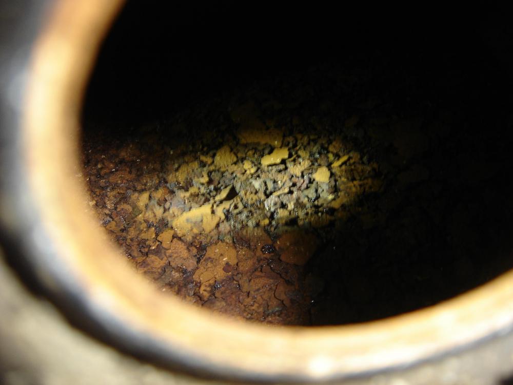

Lucky for me I have a low psi electric pump from my boat motor that I've used in tandem with a small Jerry gas can up front to bypass all the fuel BS and run 3.5 psi to my carbs. It ran good so I worked my way backwards. Rebuilt carbs, dropped the tank and cleaned it then coated with a fuel resistant liner Red Kote and it's been perfect ever since.
