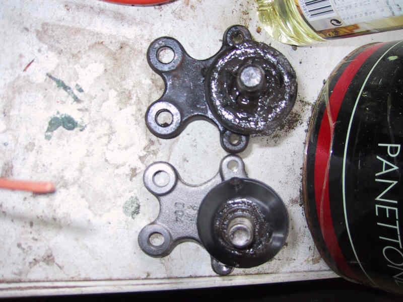

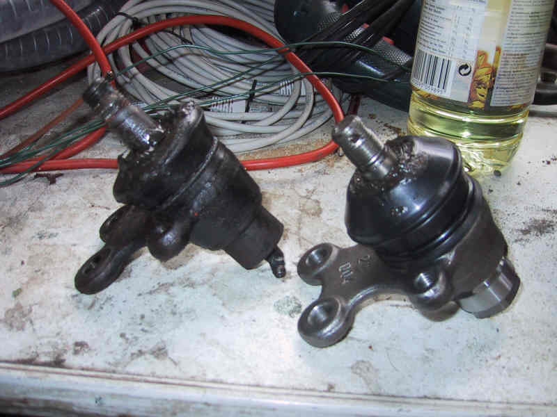

May 22, 200322 yr Author comment_38404 Here’s a picture of the two ball joints The old and the new one. Fact is, my car is august 1970 Z. I bought new ball joints with the parts number 40160-A8625. These are the same as the old ones except for the thread which I mentioned earlier! I did not have any problem with changing Link to comment https://www.classiczcars.com/forums/topic/6239-ball-joints/#findComment-38404 Share on other sites More sharing options...

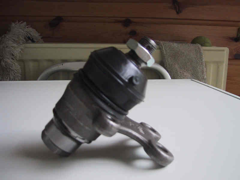

May 22, 200322 yr Author comment_38405 the new ball joint and his nut Link to comment https://www.classiczcars.com/forums/topic/6239-ball-joints/#findComment-38405 Share on other sites More sharing options...
May 22, 200322 yr Author comment_38406 another view Link to comment https://www.classiczcars.com/forums/topic/6239-ball-joints/#findComment-38406 Share on other sites More sharing options...
