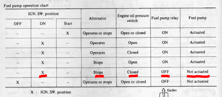

Kind of sounding like you might have some fuel pump relay problems.  The pump should not get any power until you turn the key to Start or the engine is running.  Relay testing is shown in the FSM.

Edit - ive been looking through the FSM and your chart and am a bit confused - it says 3 out of the 4 situations where the key is in 'on' have the pump being actuated without putting the key to 'start.'  Am I missing something here (I'm not the best at electrical)?
Edited by chaseincats
The other three happen when the engine is running.  Either oil pressure or alternator current need to be present.  It is a confusing chart, because Nissan doesn't really describe that oil pressure causes the switch to open.
