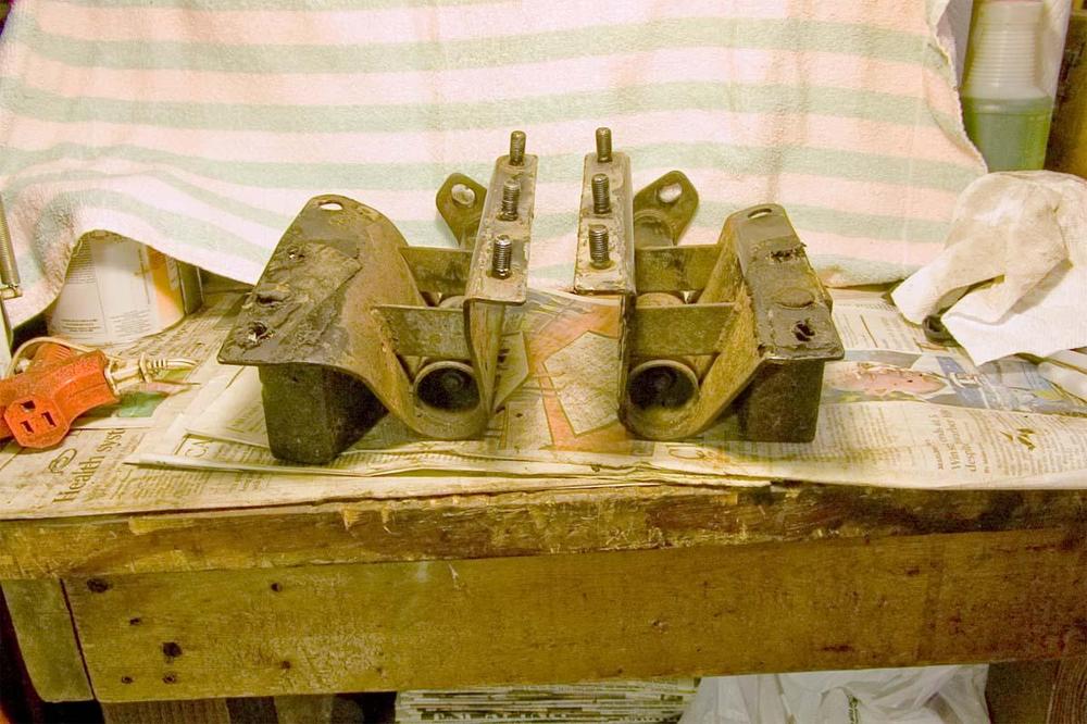

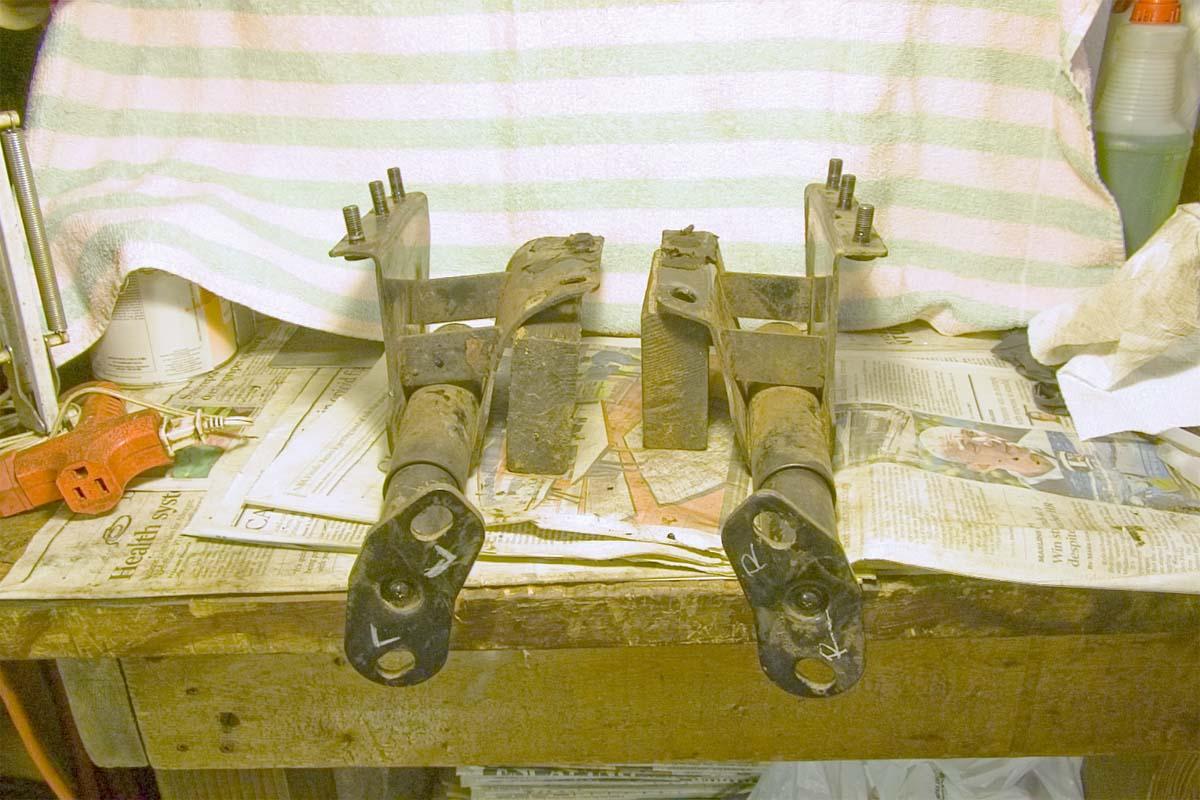

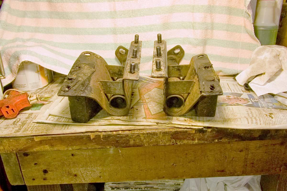

I am working to straighten out the effects of a long-ago rear-ender, and the issue comes down to the "before" configuration of the rear bumper rams on a '77 280Z (see fotos) .
I think that the right (passenger) side ram bracket is the least deformed, and therefore is the closest model of original configuration, but it would help a great deal to have an unmolested unit on which to base remedial actions.
So, can anyone out there offer a comparable shot of a pristine rear bumper ram to provide a model for restorative action?

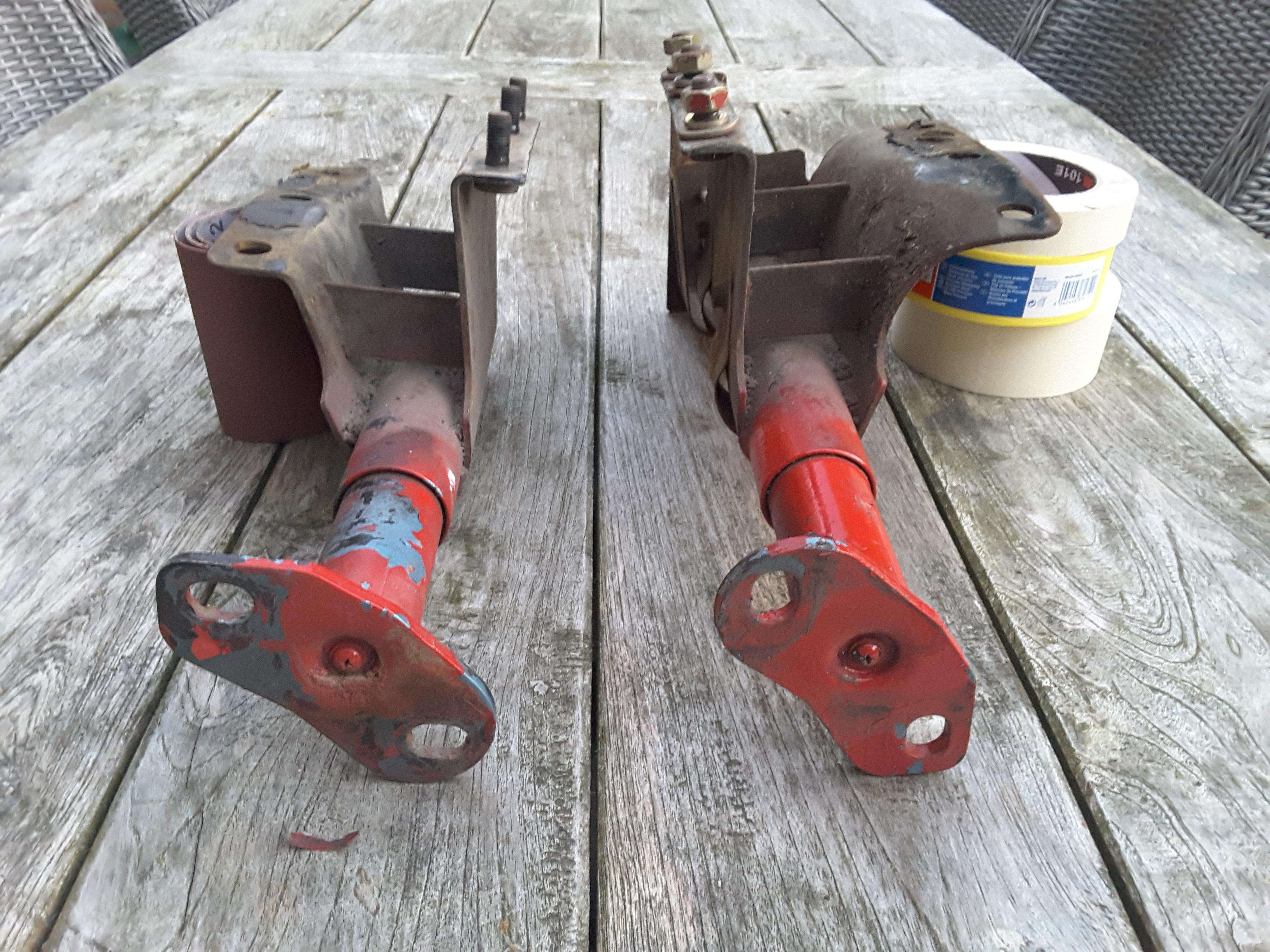

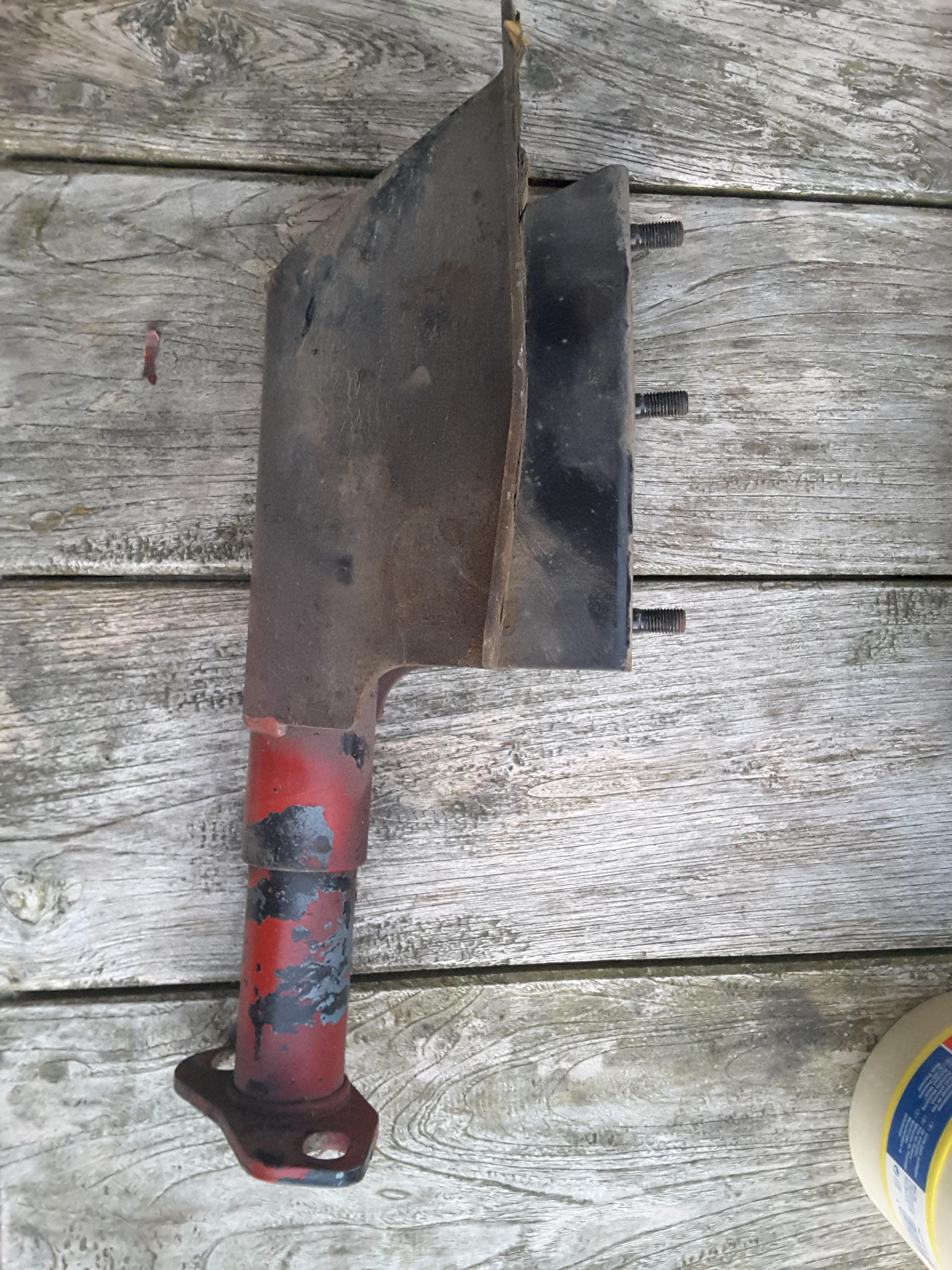

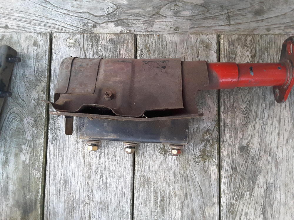

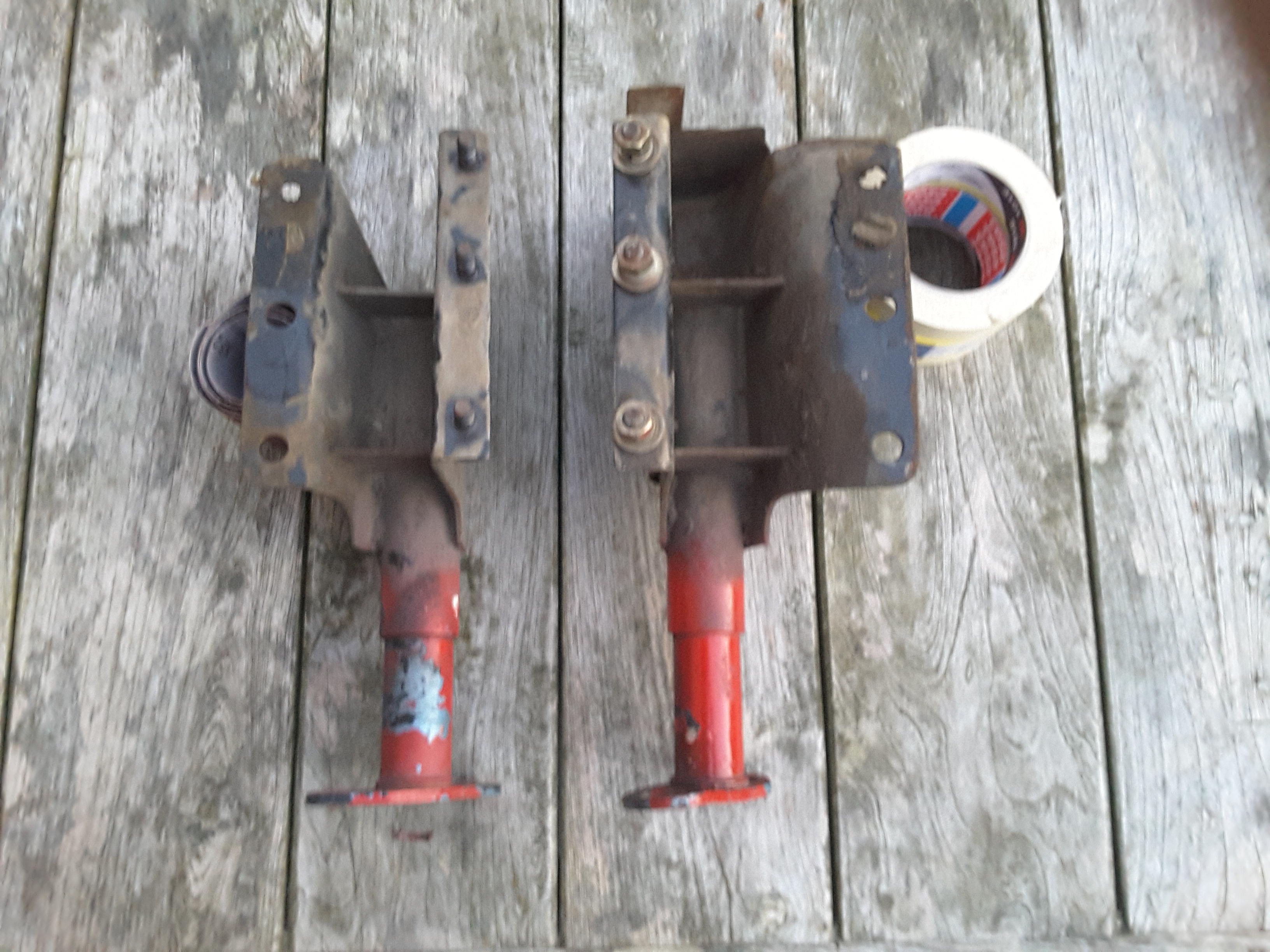

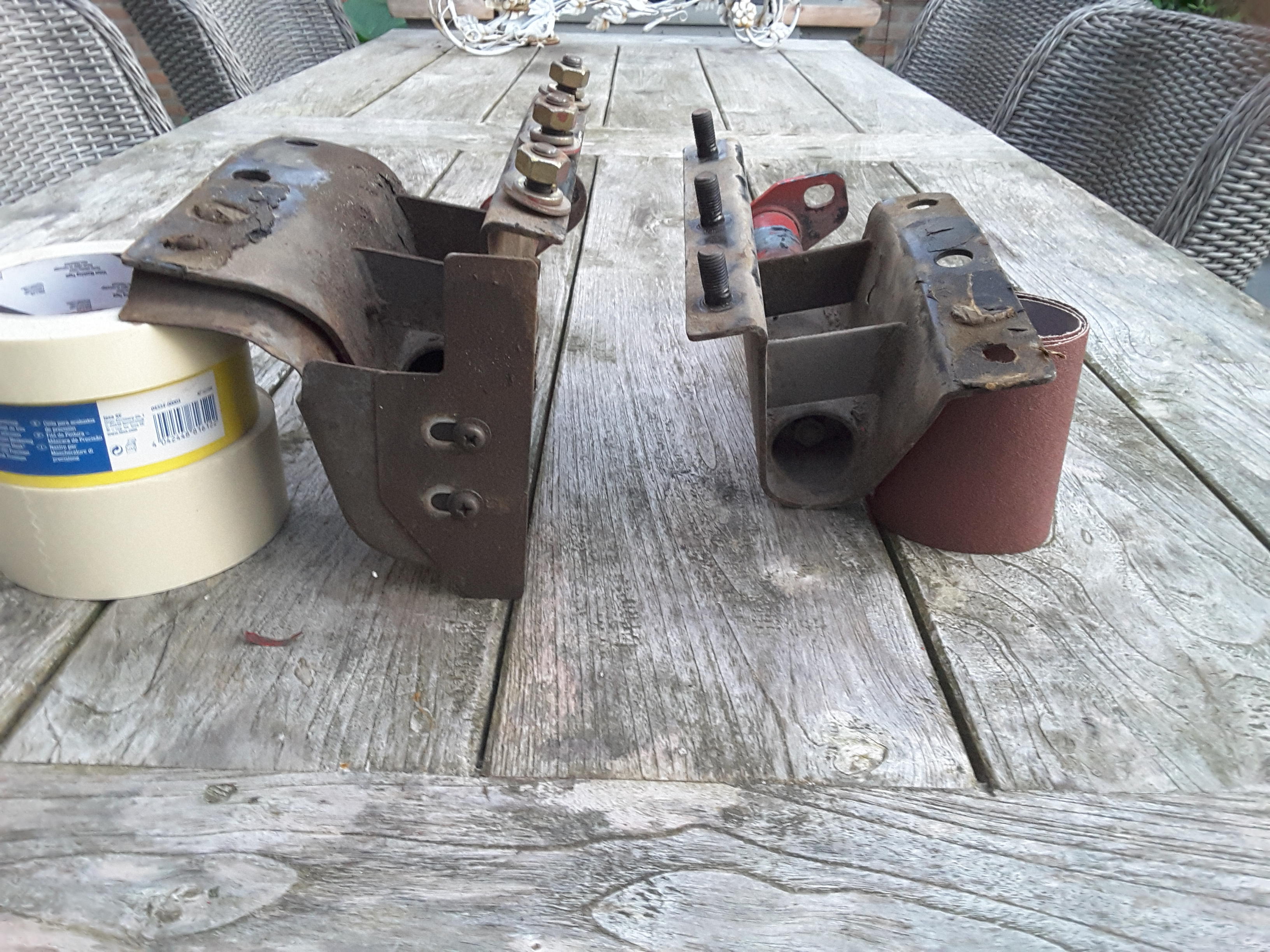

I have two rear bumper shocks in pristine condition. Ill can take two photo's like yours, when I get home, so you can compare. The left one in photo does look a little deformed.
These shocks came out of my 77 280Z. Comparing them with your units, they don't seem that bad.

Mr.EuroDat:
My good Sir; your thoughtful shots are exactly what I need to effect repairs. I can't thank you enough for taking the trouble.
The left one (which has a different bolt-row spread, and thus, different wall config as your fotos clearly show) was the particular issue of concern to me. And the flange edge shots are particularly helpful.
