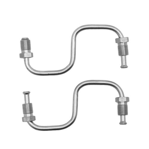

Hey guys, any tips on making these brake tubes, I’ve tried to make one but I just couldn’t figure out how to make the bends properly. I have a pipe bender but it does not make sharp enough bends. Any other ways? I have a vise
Actually the vice handle works pretty well as an anvil to bend tight curves around, put anything in the vice that will allow the handle to tighten up in a horizontal position  and bend away.  Try a few test bends first to get the technique down.
