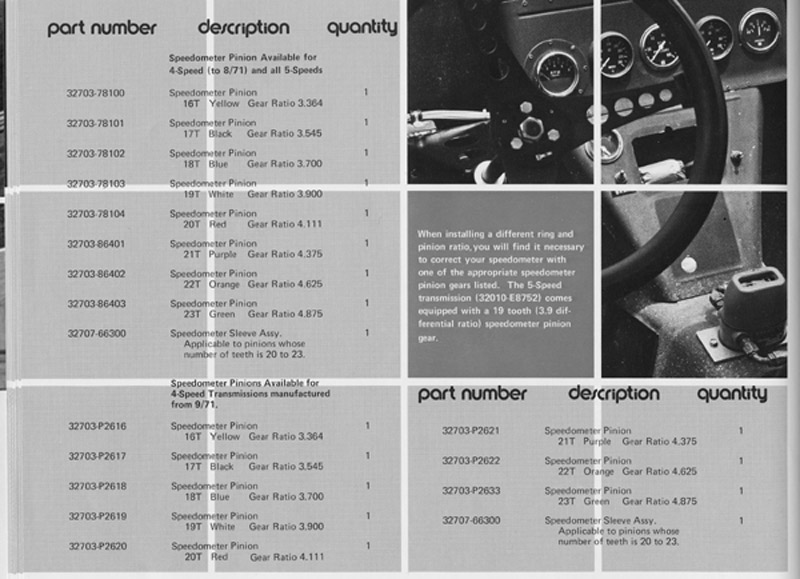

May 2, 200322 yr comment_35878 OK - I've scanned a page from an old Datsun Competition parts catalogue which seems to have most of the information ( and even in English ). I hope that the numbers will be legible from this scan. Alan T. Link to comment https://www.classiczcars.com/forums/topic/5949-speedometer-gear/#findComment-35878 Share on other sites More sharing options...

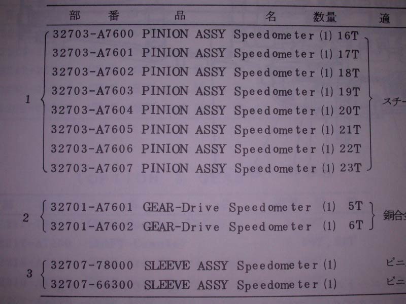

May 2, 200322 yr comment_35879 Here's a page from the Nissan Sport Service ( Factory race and rally parts manual ) manual for option transmissions. Notice that the numbers are different, but I think they are in many cases the same parts; Alan T. Link to comment https://www.classiczcars.com/forums/topic/5949-speedometer-gear/#findComment-35879 Share on other sites More sharing options...

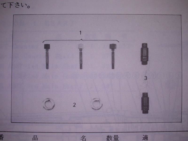

May 2, 200322 yr comment_35880 And here's the diagram of the parts that the numbers relate to; Link to comment https://www.classiczcars.com/forums/topic/5949-speedometer-gear/#findComment-35880 Share on other sites More sharing options...
May 2, 200322 yr comment_35881 So it looks like the part number that you need is 32703-78103 for the 4-speed up to 8/71 in USA and all the 5-speeds, or 32703-P2619 for the post 9/71 in USA 4-speeds.It would have been a lot easier if they called a spade a spade and just said "A" or "B" type - but there you go.Those Japanese manual numbers are probably different because its a really early edition. The Datsun Competition manual numbers will probably be more help to you if ordering in the USA.Alan T. Link to comment https://www.classiczcars.com/forums/topic/5949-speedometer-gear/#findComment-35881 Share on other sites More sharing options...

May 9, 200322 yr Author comment_36829 Alan, The Japanese part no.(32703-78103(S30) was the correct no., and I was able to look it up on the Courtesy Nissan site and find it immediately. I then called them to order, and it was no problem. Thanks alot for the research. Victor.Michael, Thanks for the offer, but Iwas able to order it as above. Link to comment https://www.classiczcars.com/forums/topic/5949-speedometer-gear/#findComment-36829 Share on other sites More sharing options...
