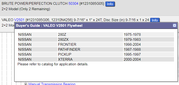

That seems to be the current scenario.  There are few 225 mm flyhweels out there.  People will have stories of the place they bought one at 3 or 4 years ago, but when you go back they're NLA.
I think that the reason there are 240 mm flyhweels out there is because they were also used on various truck and SUVs. We'll all have to convert eventually.
