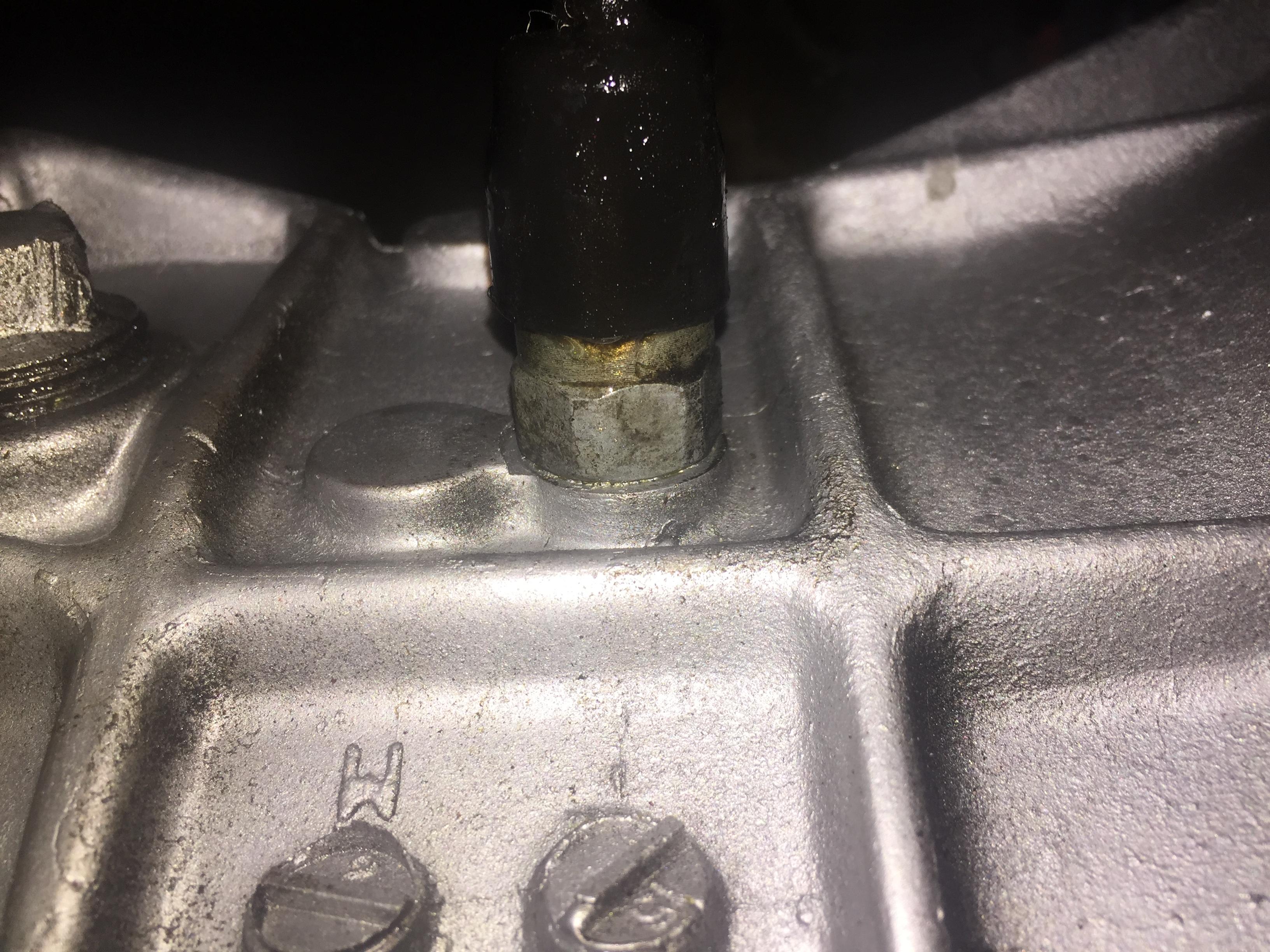

I have developed a small leak in my transmission.  It appears to be leaking from this point, the wires are wet, so I assume it is leaking internally and not from the threads.  Has anyone else seen this and if so how did you address?  Thanks!
It's a common leak.. like the oilsensor it has a plastic part inside that leakes after 35+ years..  a new one was Always my solusion..
