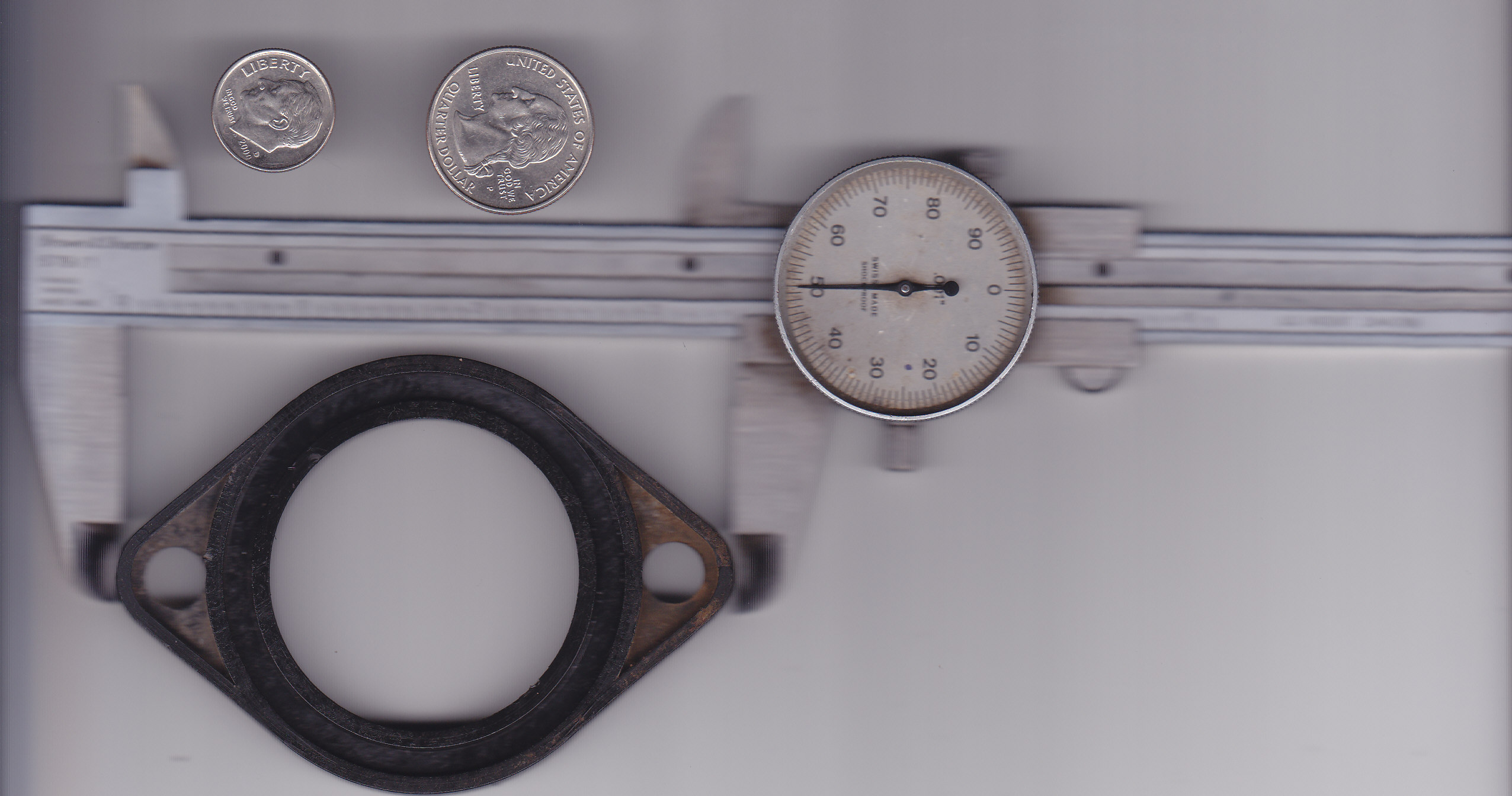

can you scan it with a ruler or something like a quarter next to the gasket? that would give me a size reference to work with.
here is a scan of 2 dimes that i scanned and saved as a jpeg, then attach as a photo. it should print out to actual size

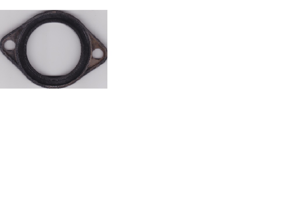

I'm about to scan it with a micrometer in .001"s.  I did this last night, it's exact on my computer but there's no telling how it would look on here.  Much too big!!!
I'm going to turn on the scanner now.
3.5"Wx2.45"H.  The hole is 1.75"s.  Center to center on the stud holes, 2.8"s
That's 3.5" on the calipers, blurry on the scanner?

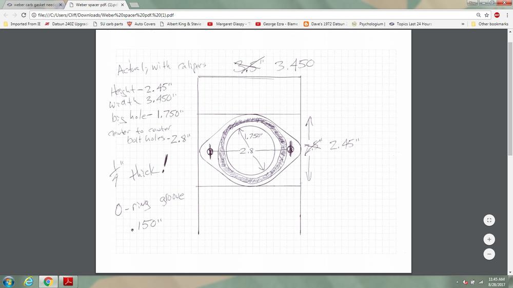

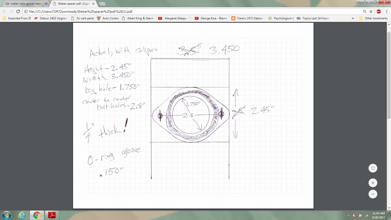

Here's what I measured on a quarter piece of graph paper.
Weber spacer pdf..pdf
