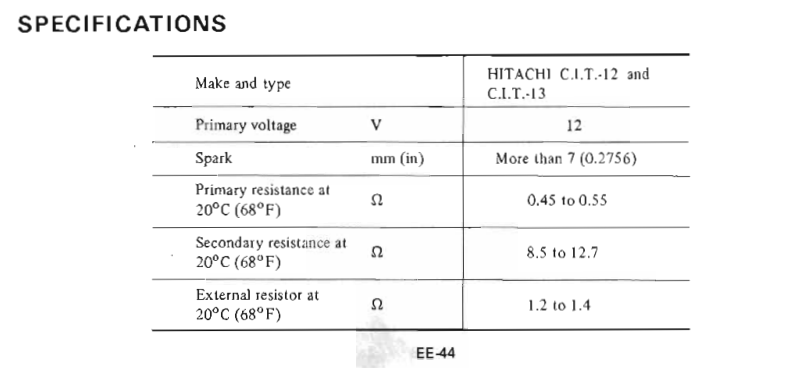

Do you have a meter?  You can check the specs against factory.  I'm guessing that you're on a budget?  That's not one of the Rock Auto products for the 260Z.
Here are the specs for the 260Z coil and the resistor.  Looks like Datsun was shooting for about 1.5 to 2.0 total.  I can't find specs for the C-632 out on the internet.  Amazon's site says it's not a fit for the 260Z but without specs, who knows.
