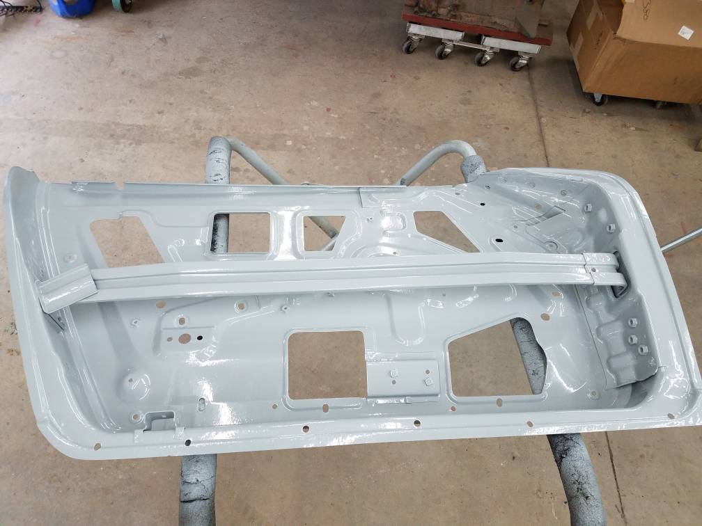

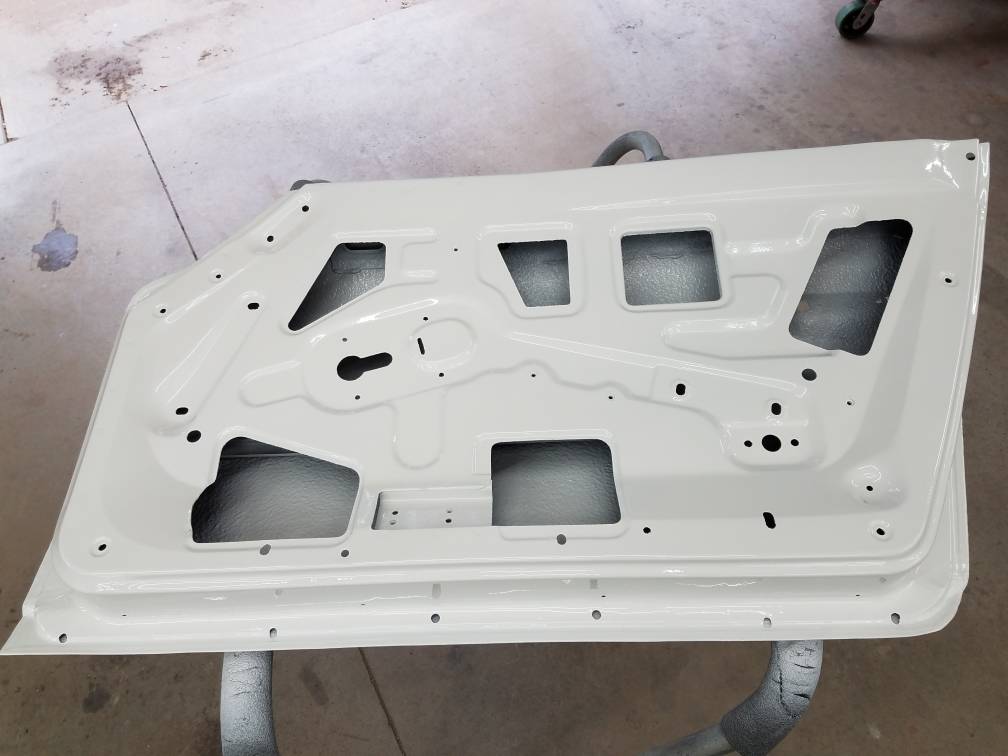

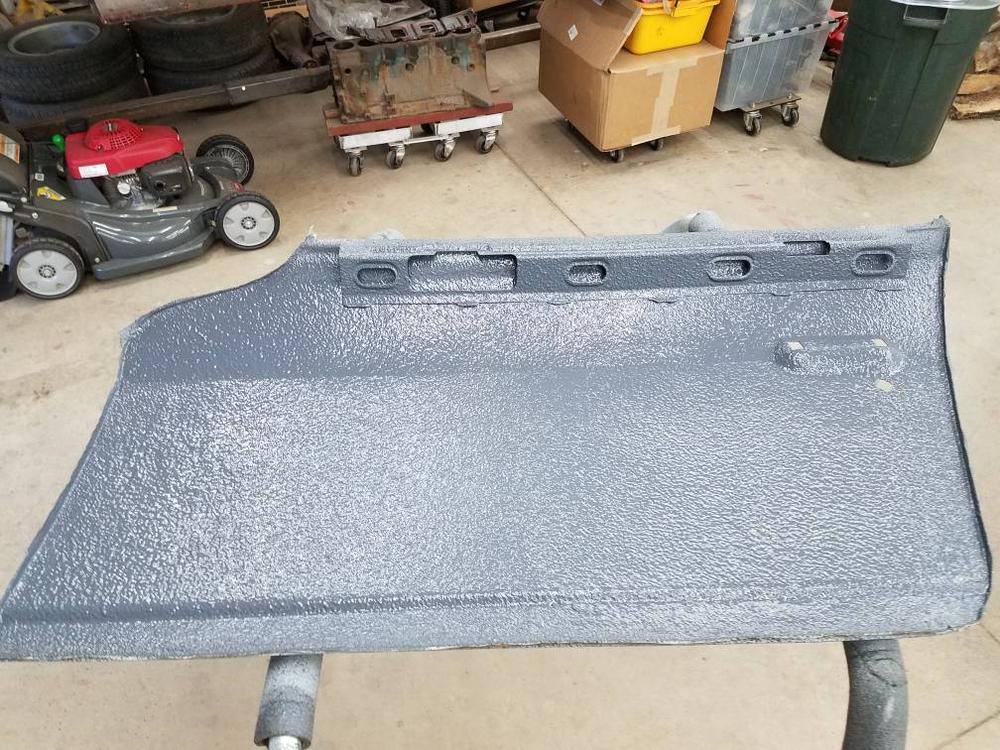

Great day, temps in the upper 60's. Got the door sprayed with expoxy primer once dried late this afternoon I strayed the Lizzard skin sound control. Tomorrow I will spray the ceramic insulation. If all goes well next weekend I will get time to put the door skin back on.20170826_190147.jpeg20170826_190134.jpeg20170826_120946.jpeg20170826_120934.jpeg
Sent from my SM-G930V using Classic Zcar Club mobile

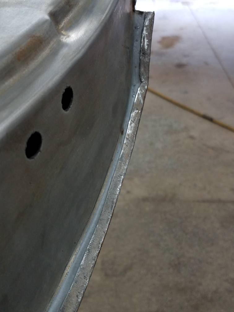

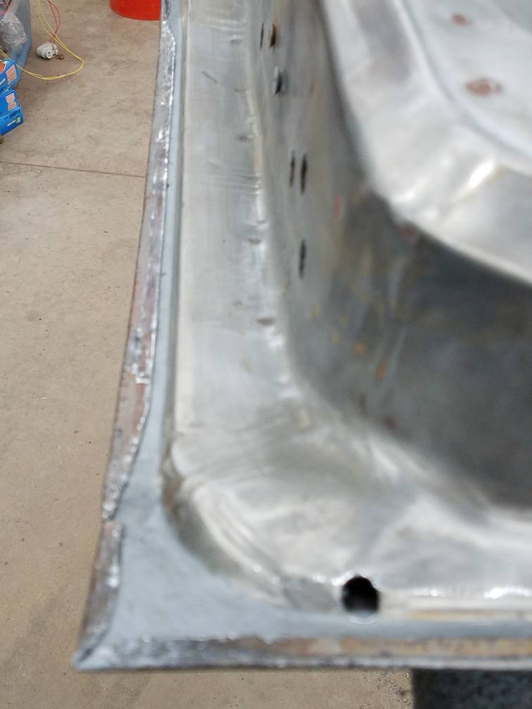

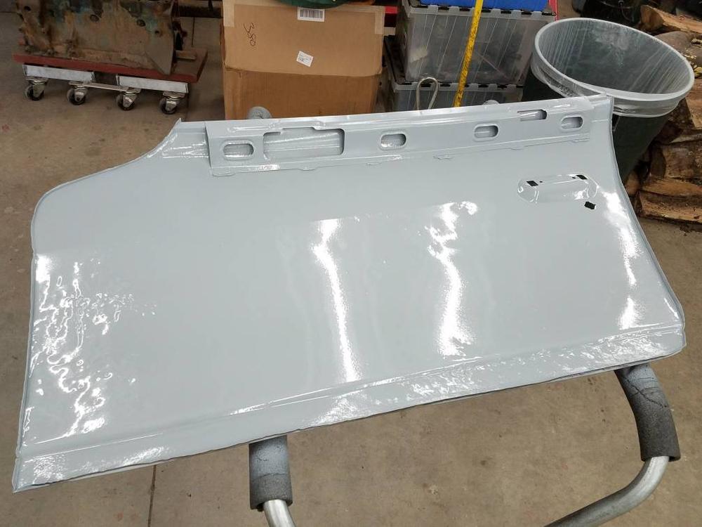

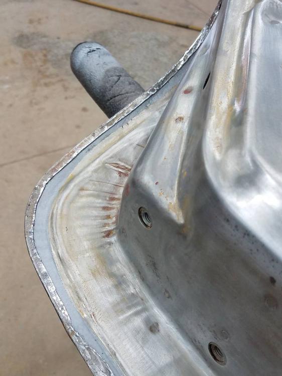

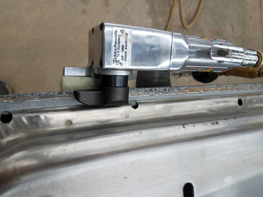

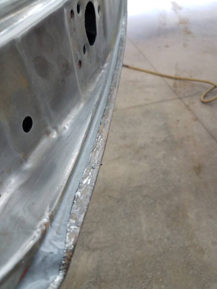

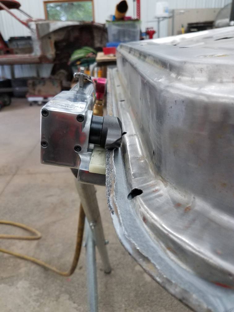

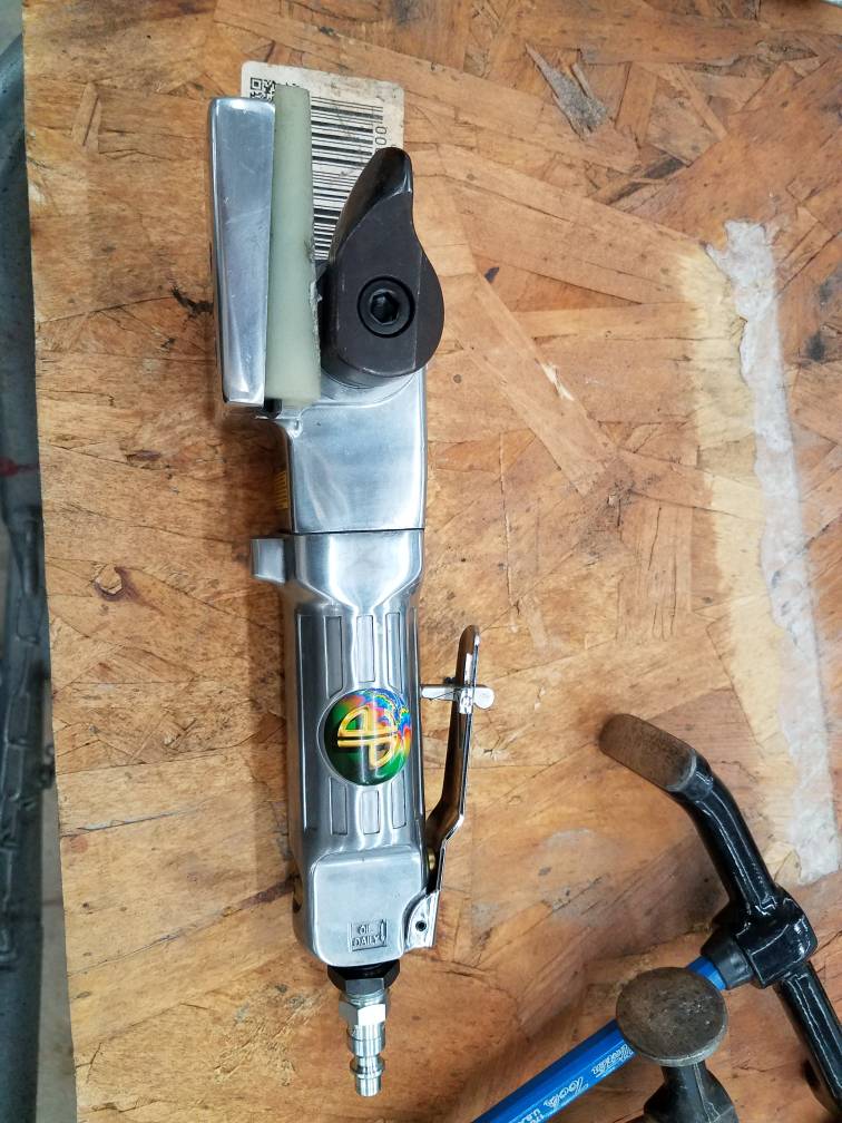

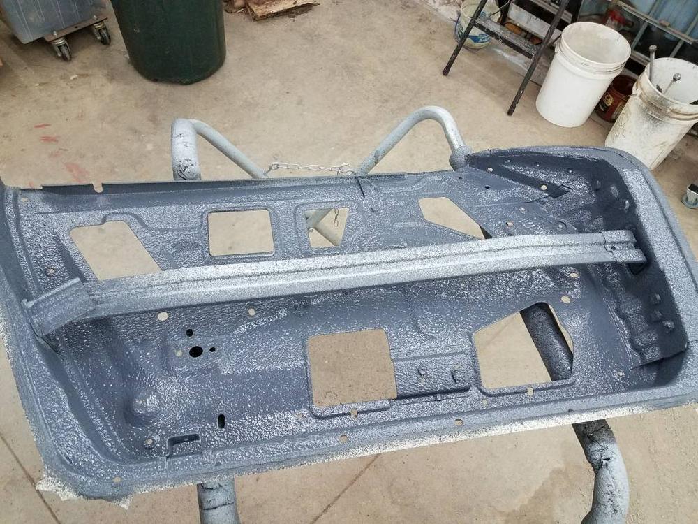

finally got another day for the door and new toy. Did test fit of the door skin. Clamp the skin to the door frame tacked them together at the top. Then got out the door skin hammer and dolly to fold the skin crimp over. Finally what I have been waiting using my pneumatic skin crimping tool. WOW! Was that quick and slick! To finish the day off I shot the Interior side of the door in epoxy primer. Will do the skin next and then onto finishing the door and peel the driver door apart!
Enjoy the Laborless Day weekend.20170902_145413.jpeg20170902_144924.jpeg20170902_145503.jpeg20170902_145643.jpeg20170902_145650.jpeg20170902_144932.jpeg20170902_145513.jpeg20170902_165810.jpeg
