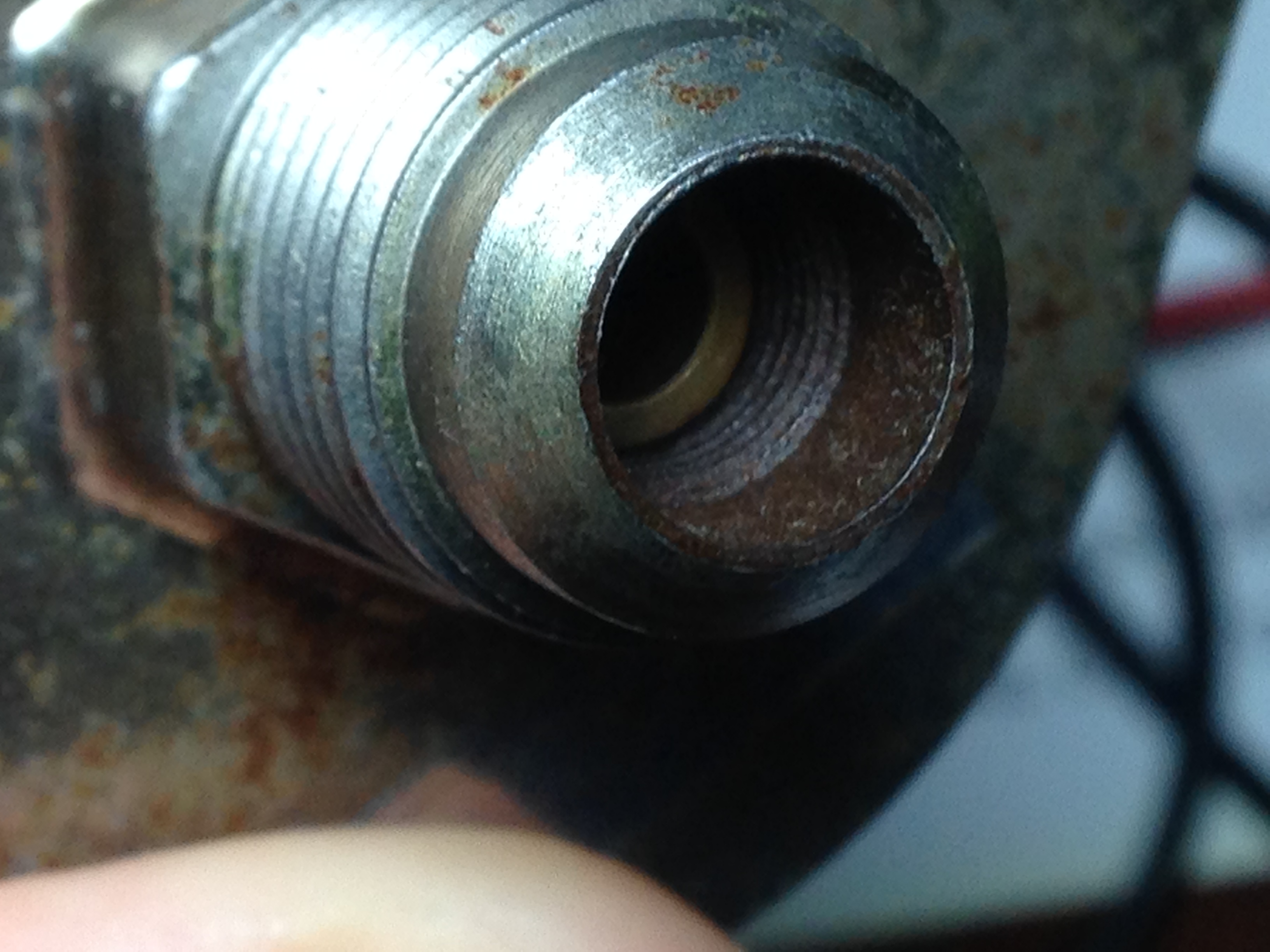

I picked a used evap/expansion chamber from a junk yard. The system had been open for a while as there was rust on the hi pressure switch, and junk in the expansion valve inlet. I removed the valve from its body, and flushed the evap with cleaner. This is the setup that has 3 separate cooling coils, all feed from the evap valve body (3 small and 3 large tubes).
Anyway in my zeal to clean the rust out I removed the brass fitting inside the inlet of the valve, got the spring out (covered in rust) soaked it in evap o rust. cleaned the area around where the spring rest with some q tips. Not sure how much more it can be disassembled to get access what I presume is a needle valve arrangement.
Anyway now the problem I foolishly did not measure (or count turns) before removing the brass spring retaining nut. I ended up guessing by looking how far the spring can collapse and then turning the brass retainer enough to about 1/2 that much.
IF any one has one of the types of expansion valves (look in side and you will see a sloted brass disk with a hole in the center. Please give me a measurement from the top of the inlet to the brass disk. I will get some pics later to better illustrate.

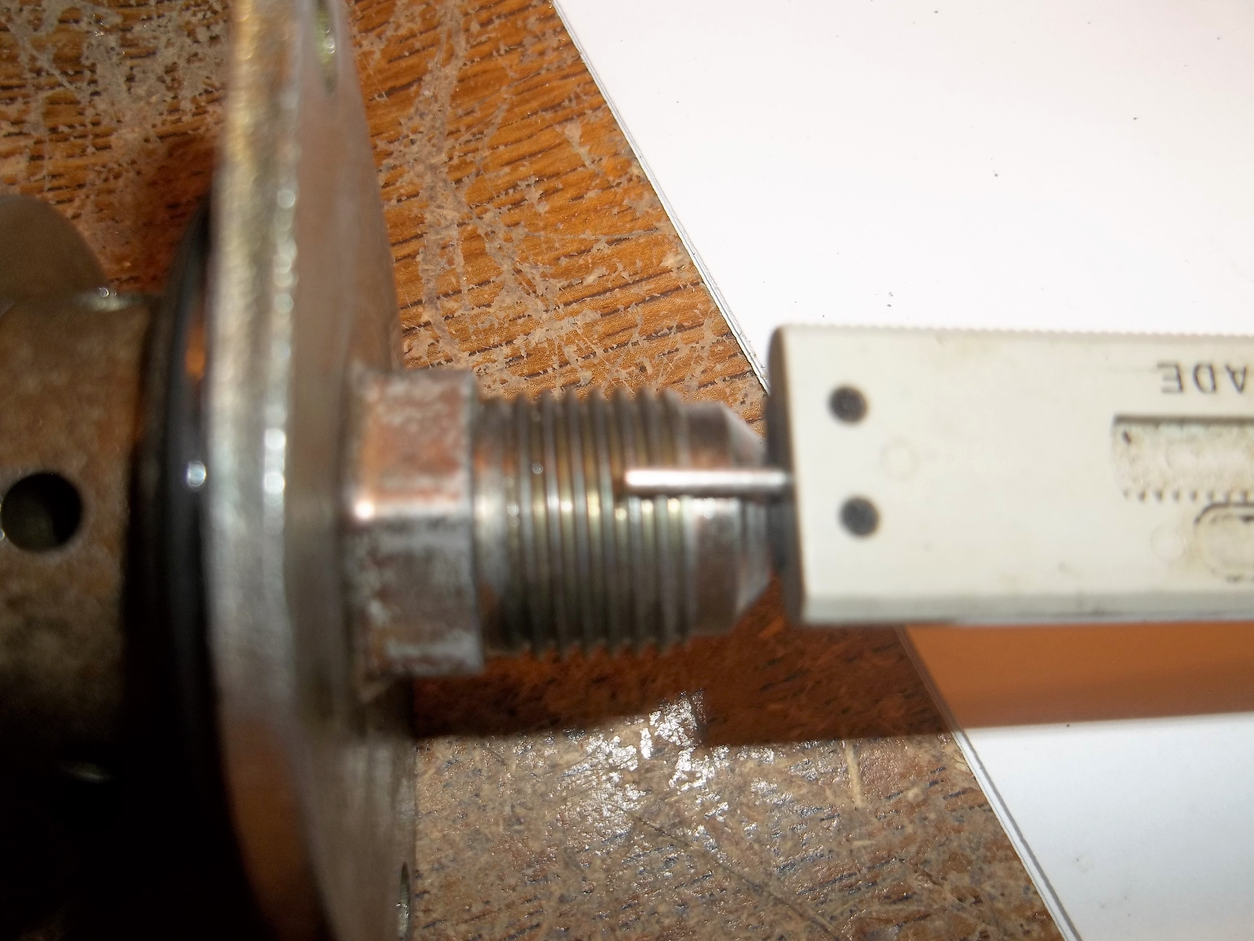

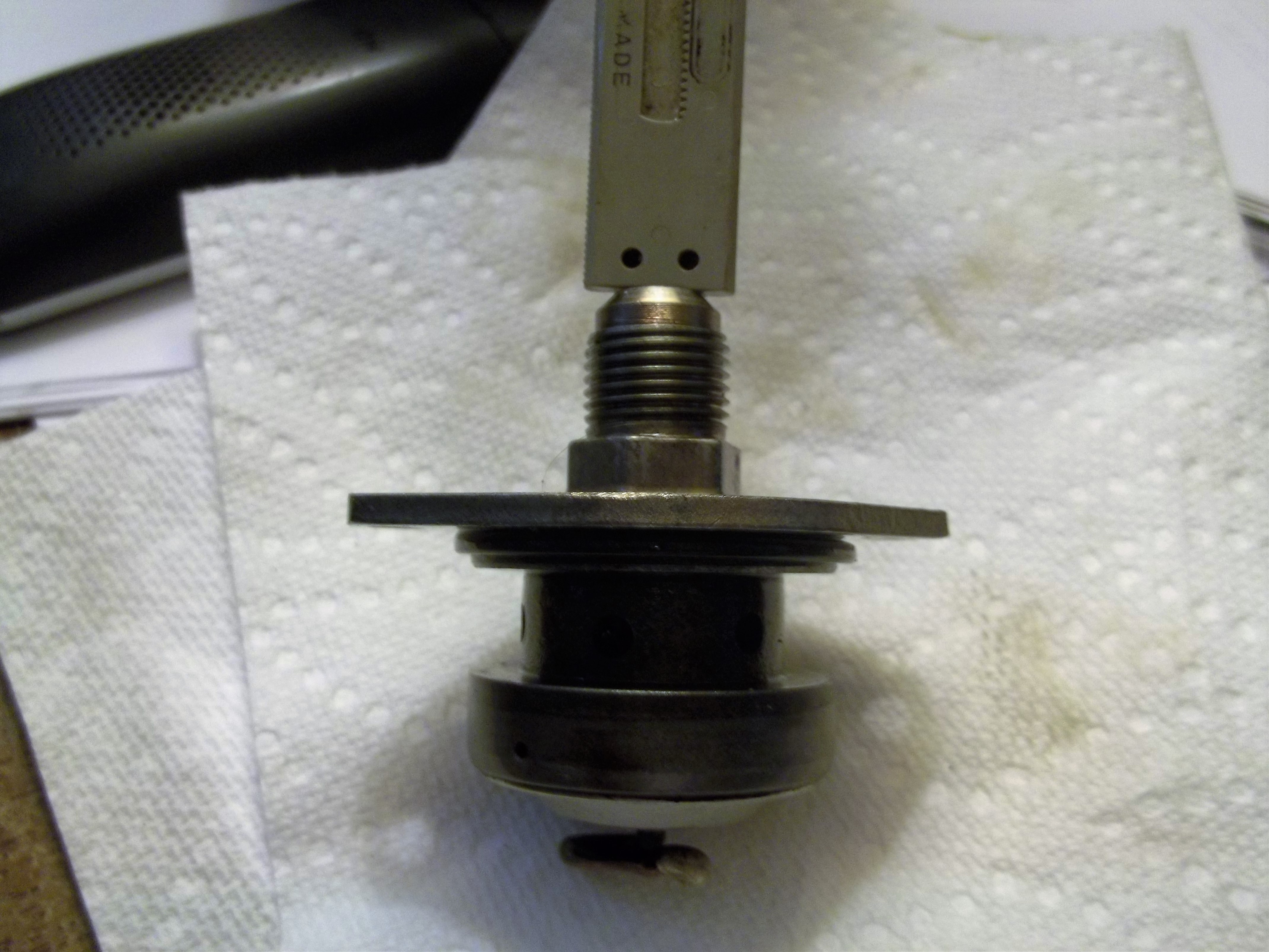

I made a rather long video that will be posted later tonight. Bottom line is I have the top of the brass spring retaining nut approx. 12.5 mm up from the base of the flare fitting connection to the plate that is bolted to the canister on the evap unit.
This was done after measuring the distance on another exp valve (but later think for a ZX). It was not the same pn it has a longer inlet snout but I took that into consideration. The new ZX unit has the top of the brass retainer about 12-13 mm up from the plate, so I used that as a ref. It looks right from what I recall of how many threads were showing before I disassemble it. (thread showing above the brass retainer that is).
I don't have a caliper like yours but i think  counting the threads would just as accurate.  I counted 5 threads and its adjusted down to be right on the top of the 6th thread.

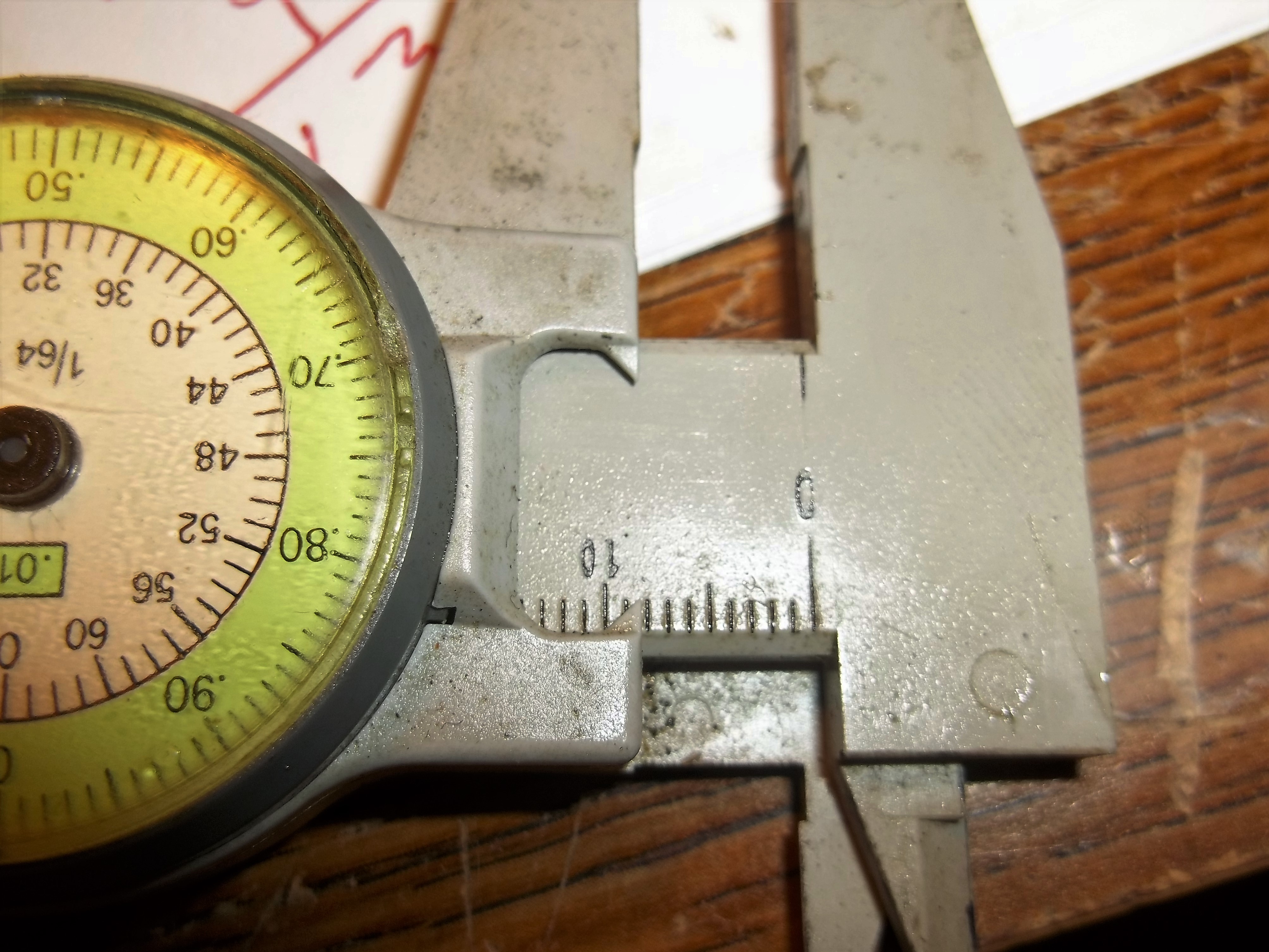

I used your photo, that is exactly 9mm down. I tried the freezer test, I could not tell any diff in the air flow when blowing thru it between 77f (room temp) and 0f (freezer), at least not real noticeable. I am going to try it with the new one as well.
Ok update, the new one responds to the freezer (will shut down completely) the old one seems to have no effect, so that's it, old one is toast, I suppose its either lost its charge or there is something (rust) that is not allowing it to close up.
