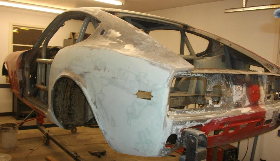

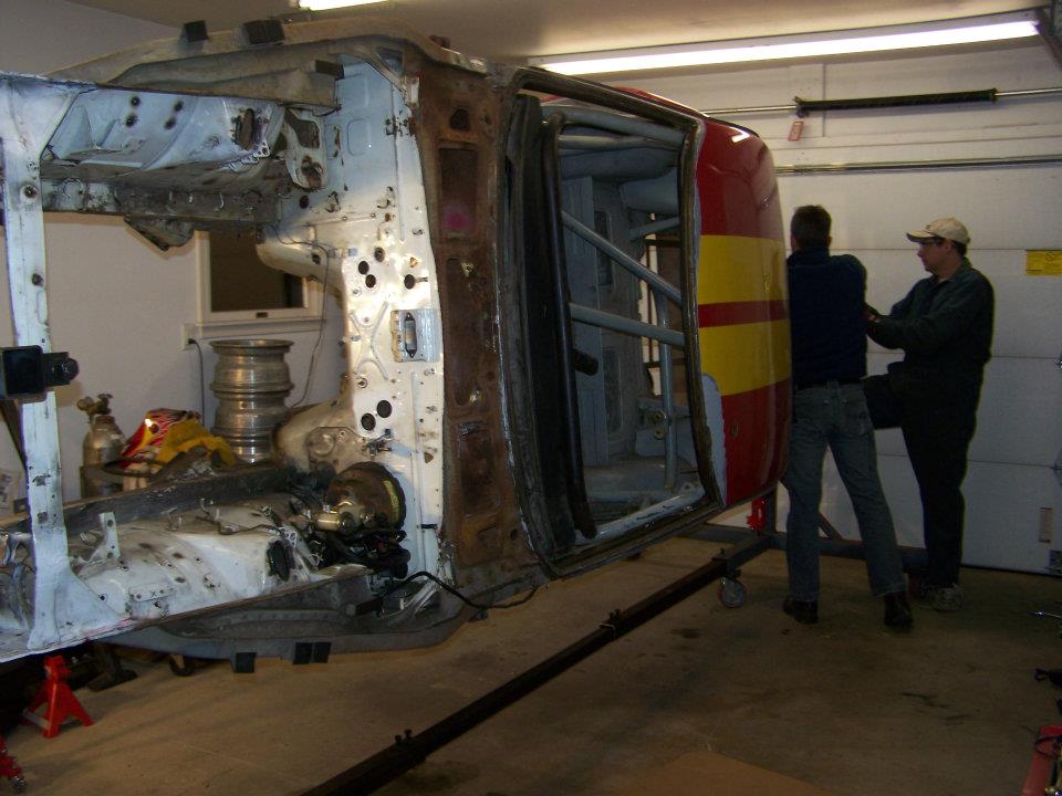

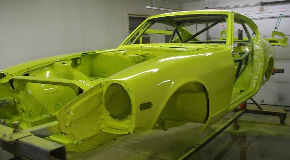

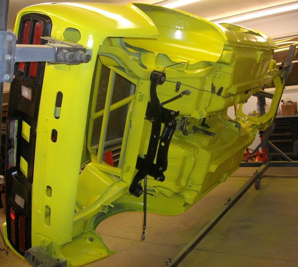

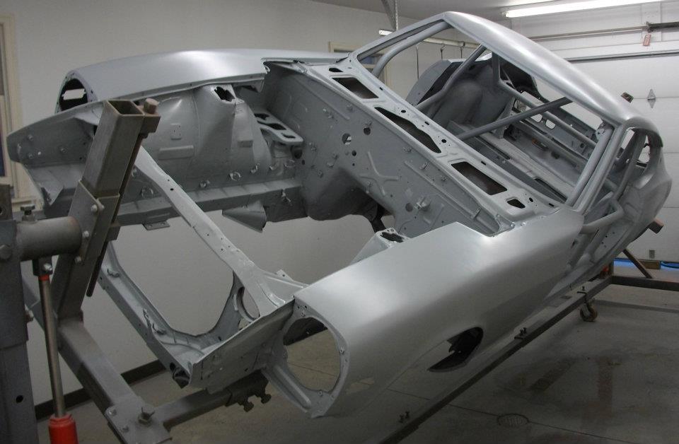

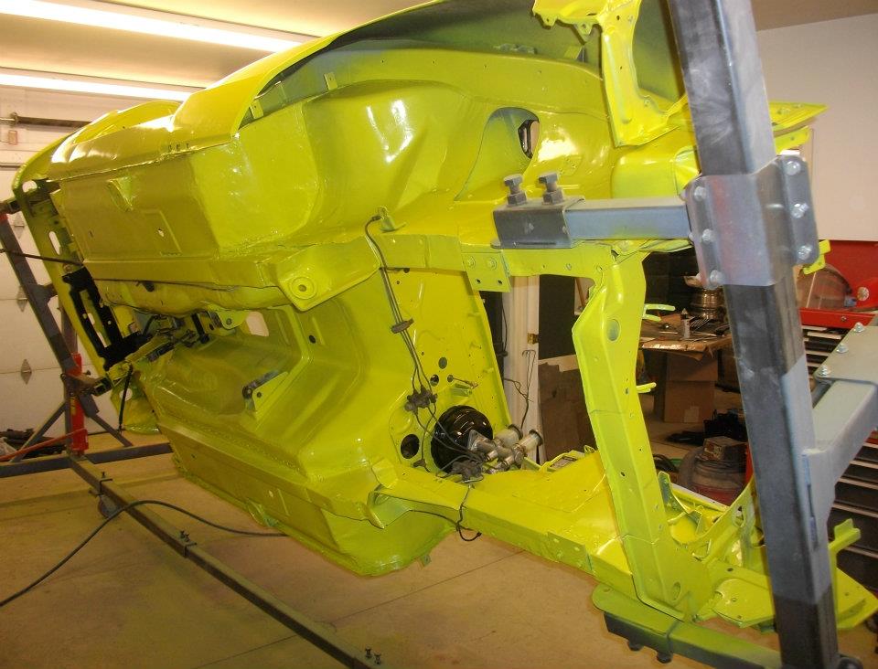

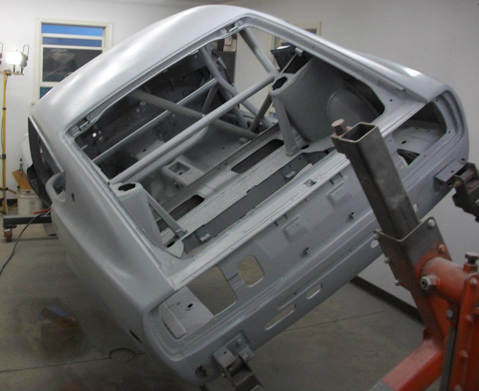

May 16, 20169 yr comment_495170 I have the Auto Twirler Pro and it's great. I bought it with the Mopar mounts and they're similar to the Z mounts. I drilled an additional hole in the front mounts and made an adapter bracket for the rear mounts. I've built a 71 240Z, 72 240Z and 75 280Z on it so far. The first pic is my 240Z and the others are my 280Z. Both were painted Mopar's Curious Yellow. I got it at one of the Carlisle shows a few years ago. http://autotwirler.com/ Chuck Link to comment https://www.classiczcars.com/forums/topic/55477-rotisserie-recommendations/#findComment-495170 Share on other sites More sharing options...
