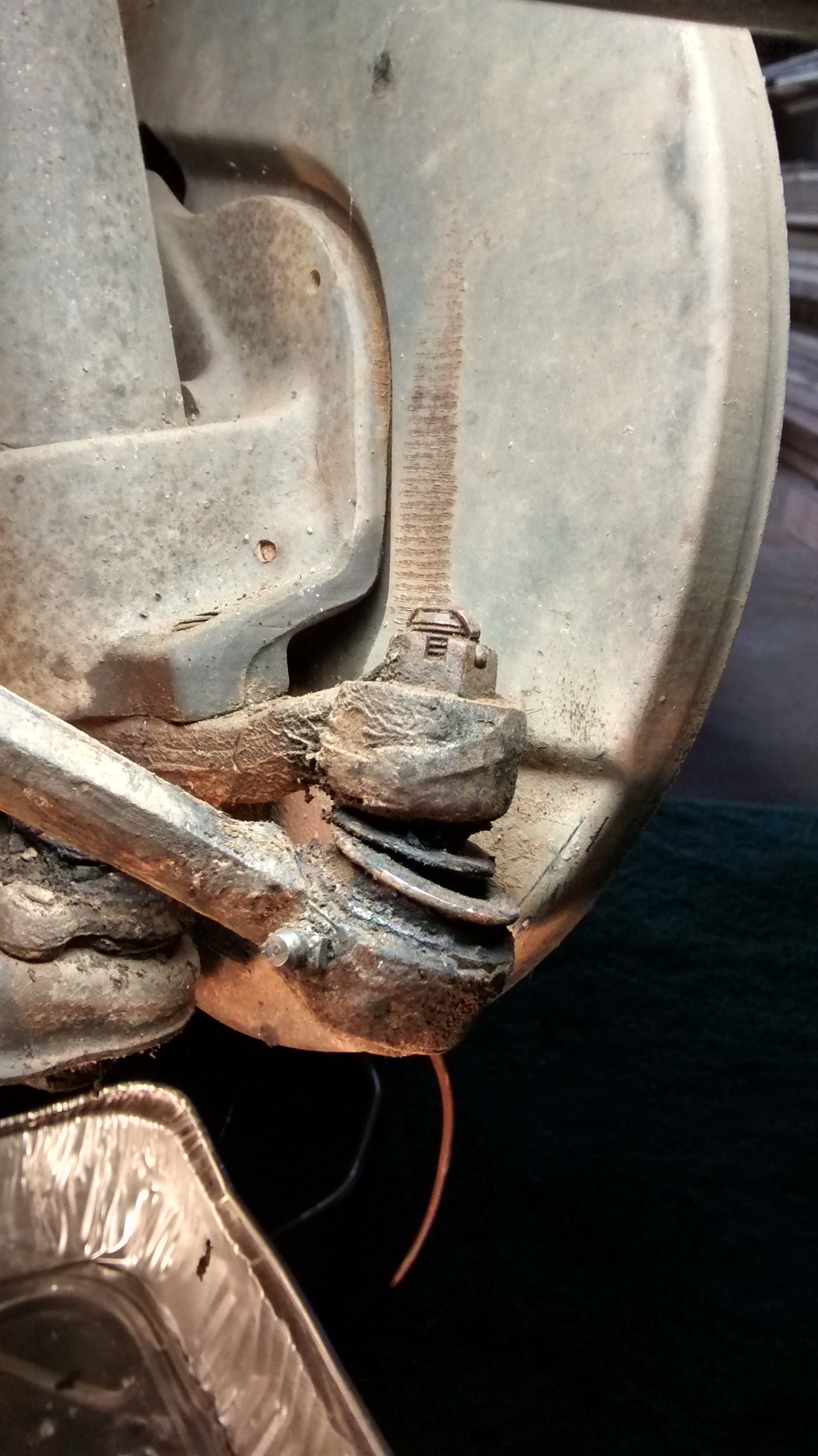

I'm (in no hurry) done with the rear suspension bushings and started on the front today.
I figure I need something on the tie rod ends since the rubber boots have long been gone on mine. All I can find are poly dust boots, unless I replace the whole tie rod (replacement tie rods come with rubber boots, from what I can find)
For those of you that have them, do the poly dust boots fit well? Can I source some rubber dust boots, instead?

Ahhh, never mind. After reading more and remembering how I beat the crap out of these to separate them, I'll spend the money on new parts when I put it back together.  Rock Auto has Moog ends for $24 each.
I would replace the Moog boots with black polyurethane - Energy Suspension 9.13103G I think is the right part number.  They will last a lot longer.
Put them on mine when I did my tie rods a year ago.
