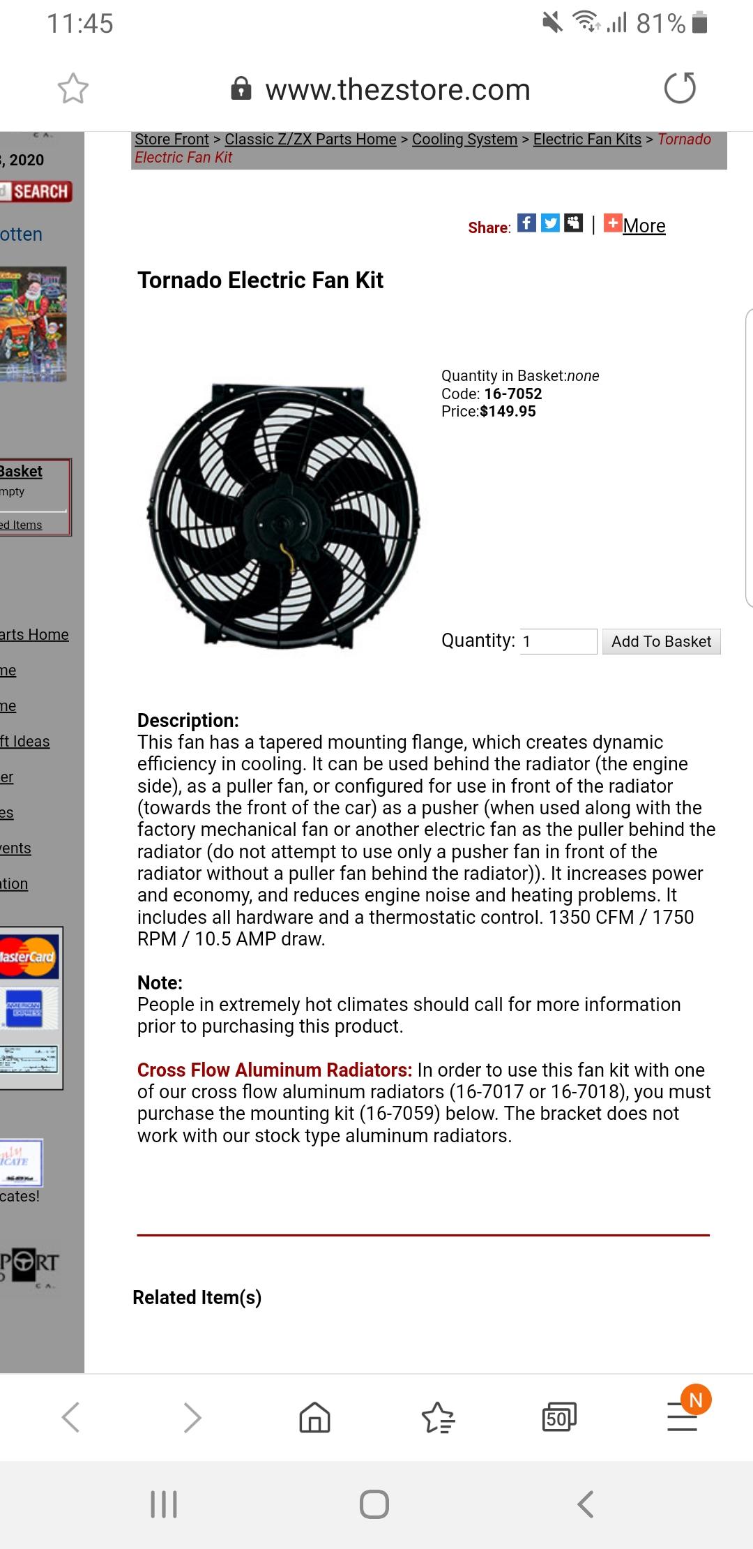

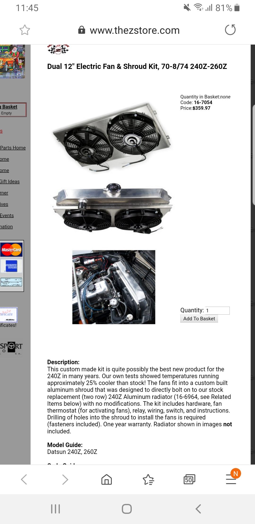

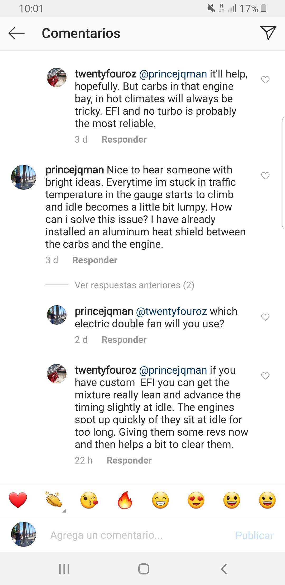

It still overheats in heavy traffic conditions. I read that this L Series engine with carbs suffer from this and that at idle plugs get sooty. Apparently the only remedy is to install electric pusher fans. But which one would you recommend?Screenshot_20200122-220124_Instagram.jpg
