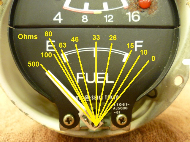

As for calibration... Here's a pic of some testing I ran some time ago. Ballpark should operate something like this:
