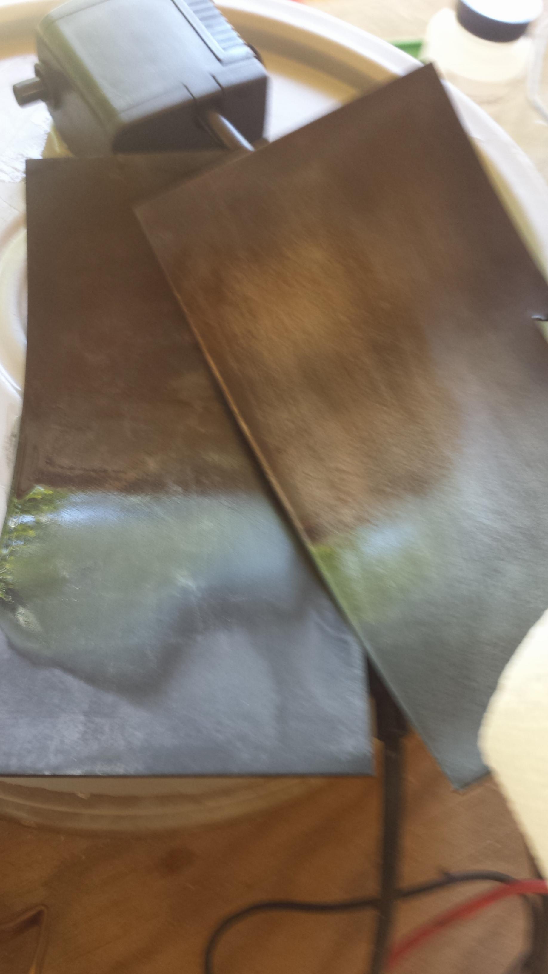

So in between tearing down the diesel I am working on I took a shot at plating again. Before I started and while everything was heating up I worked on my plates. They were black and crusty and I left them overnight in the solution. I assume that was a mistake....So I started with this and wire brushed them and then sanded them smooth

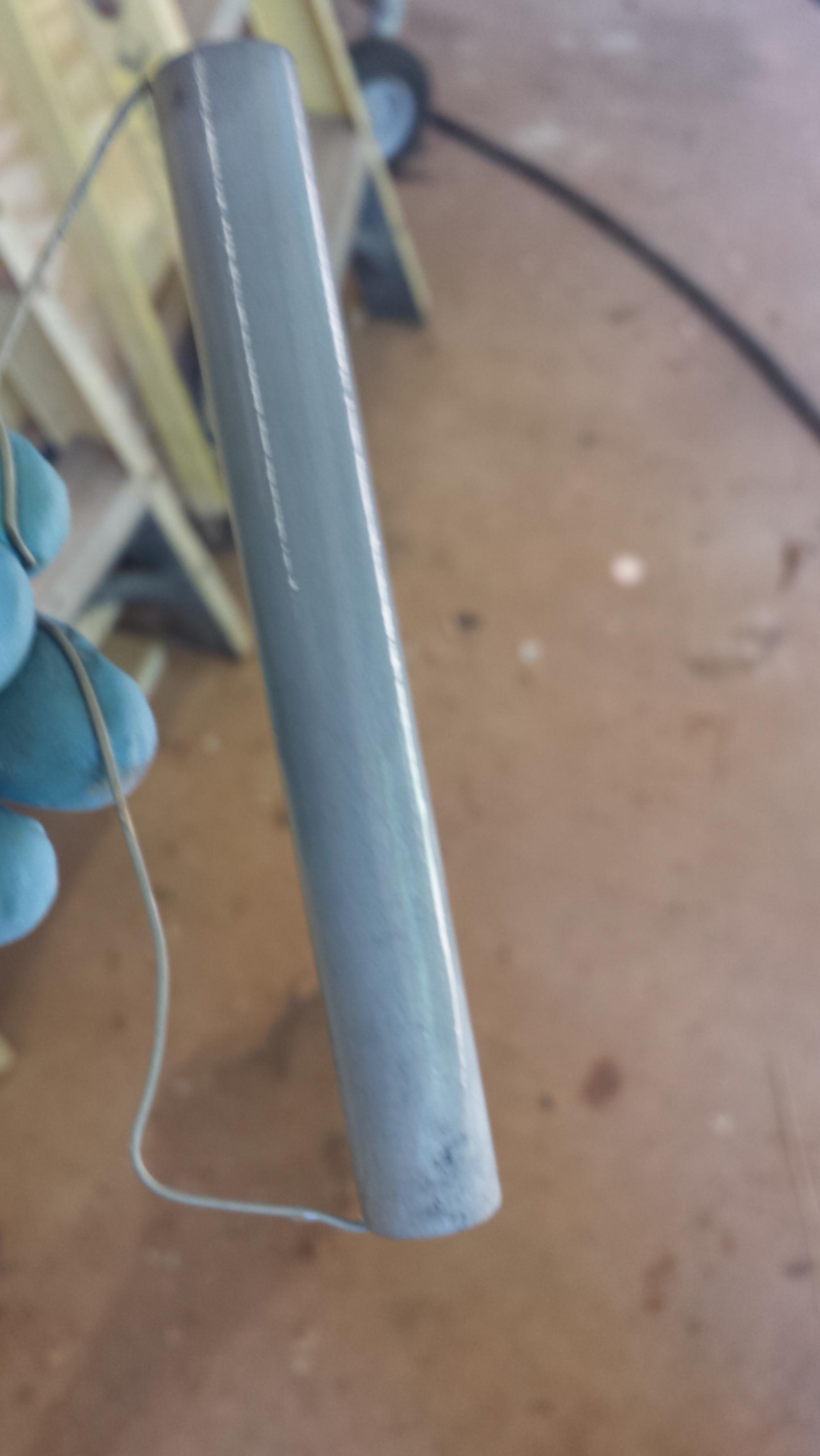

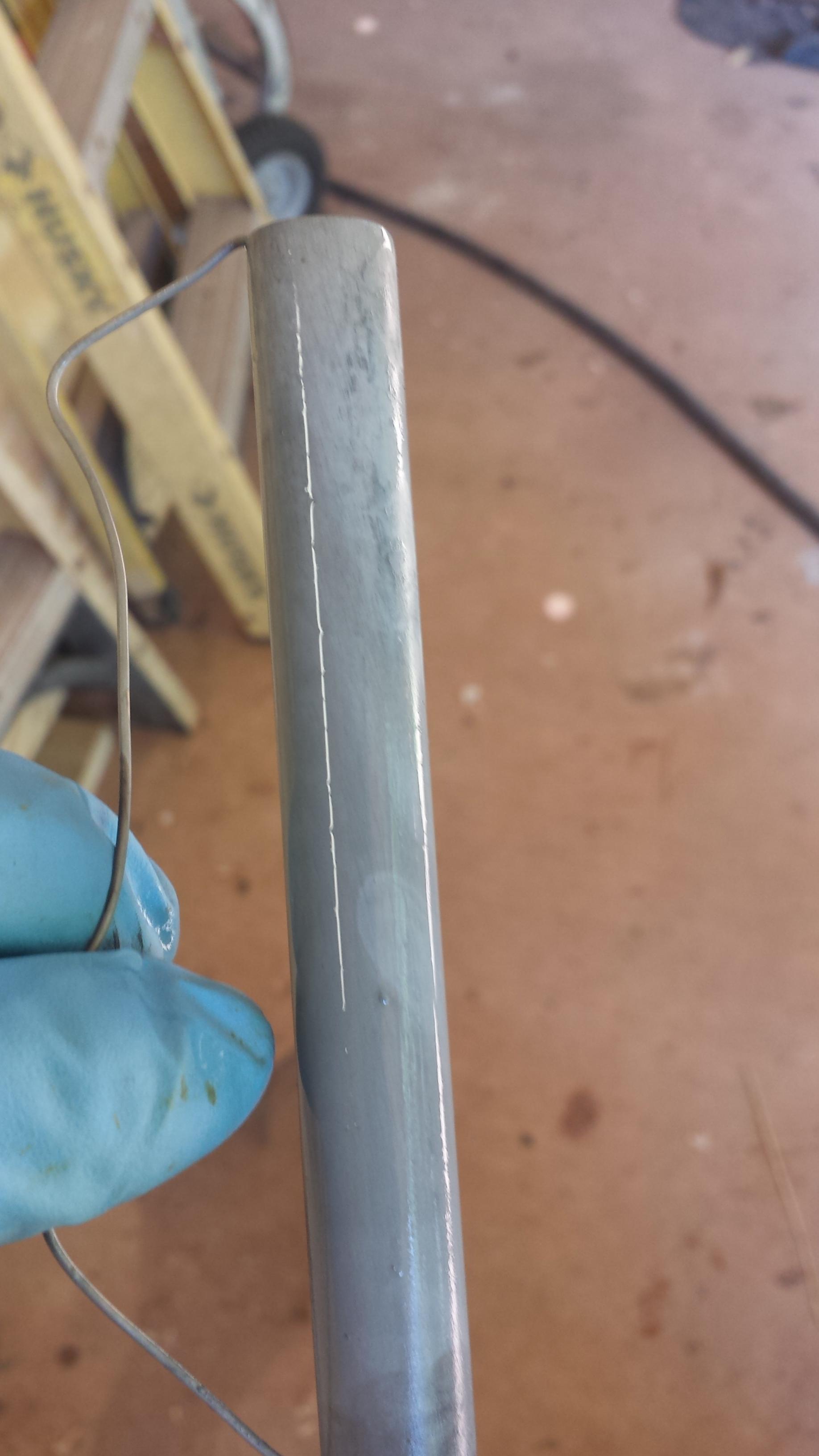

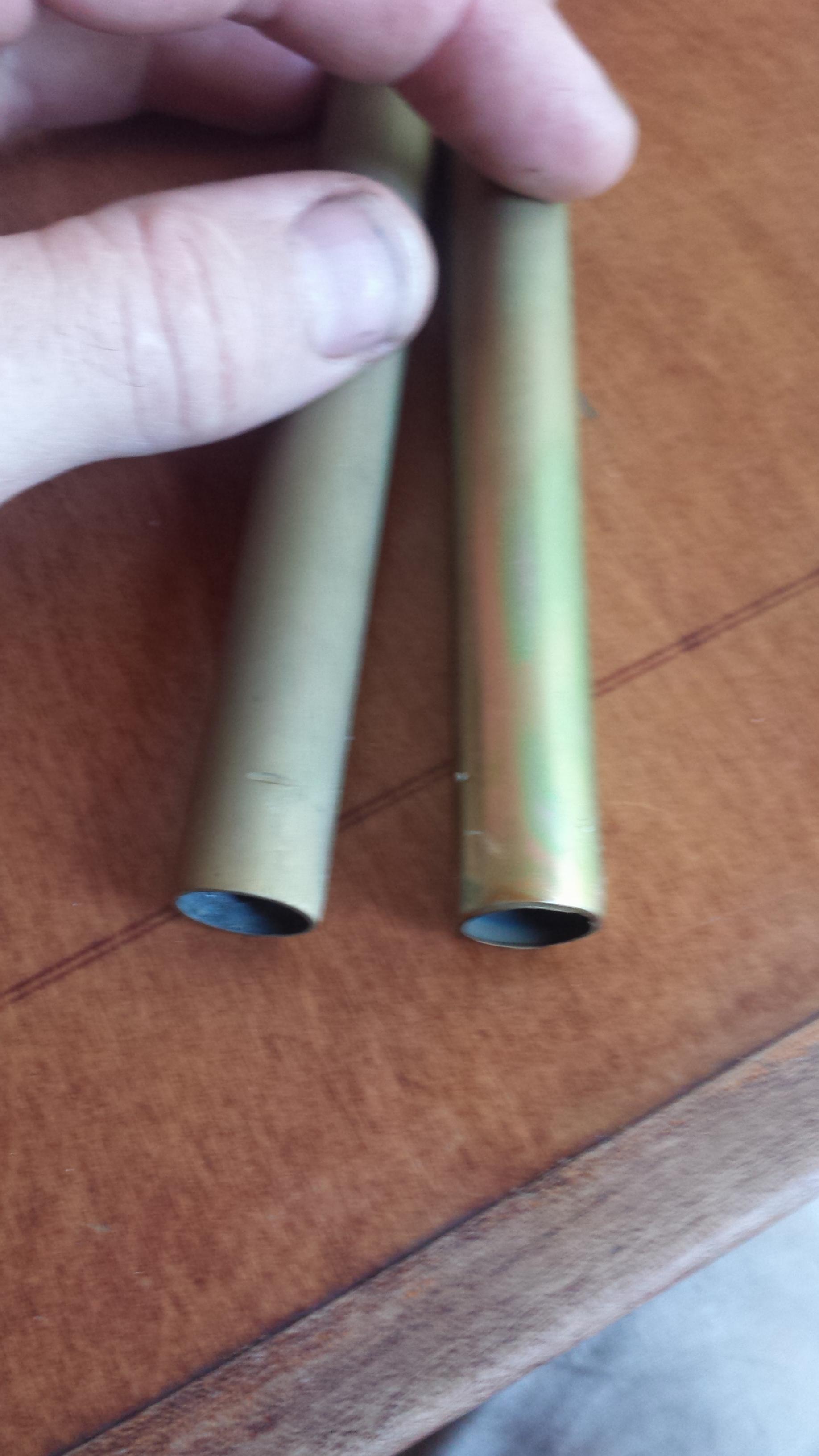

so I started with these 5" pipes again. The first was run in the tumbler overnight. 15 minutes of plate / rinse / 90 seconds of chromate / rinse
Thought the zinc would be a little brighter not so flat grey....20160611_131914.jpg

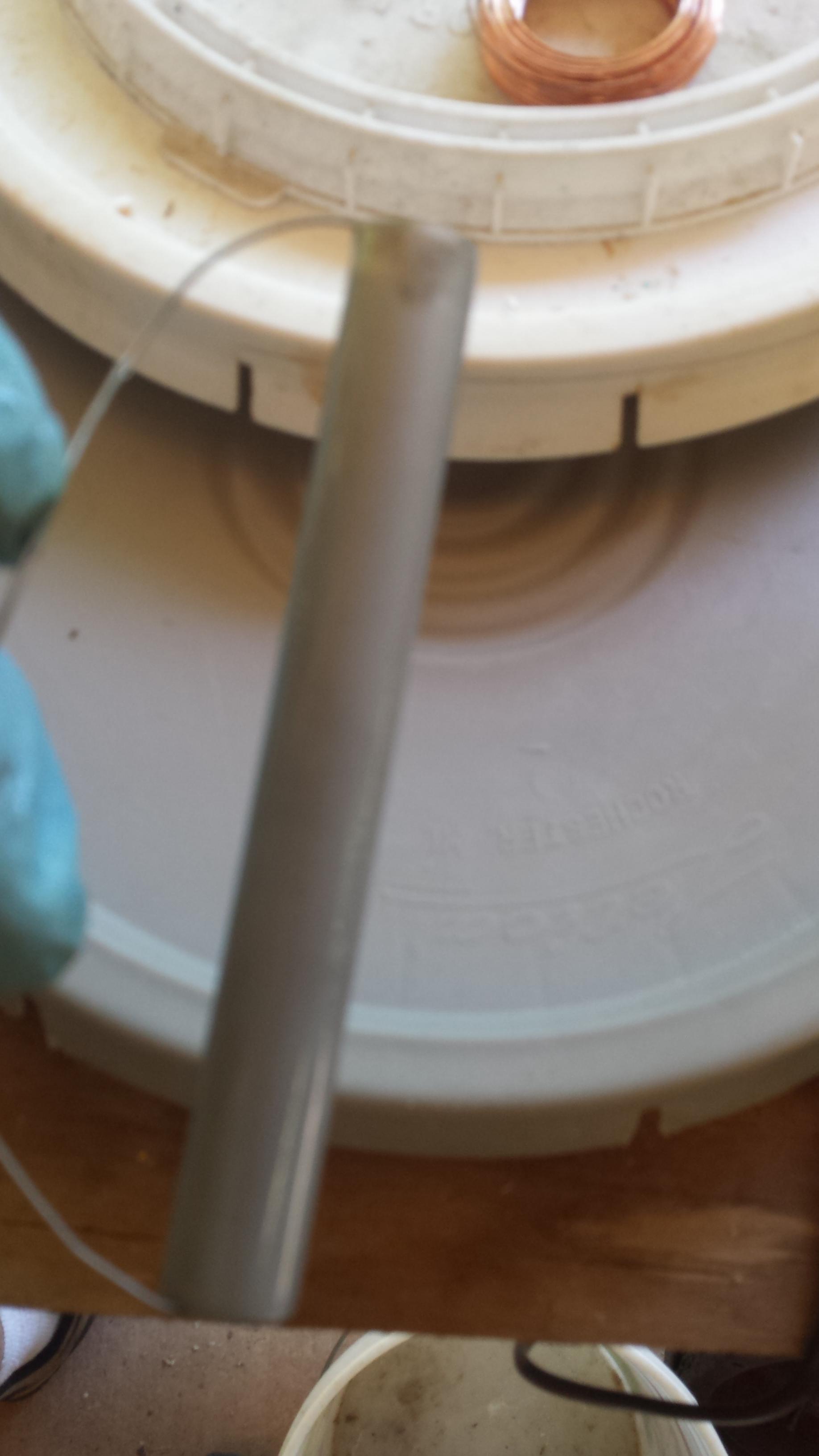

The focus is off for some reason. The one on the left is the one from the tumbler. the one on the right was buffed on the buffing wheel. Very shiny before plating. It came out much better...I ran the second one for 120 seconds in chromate.

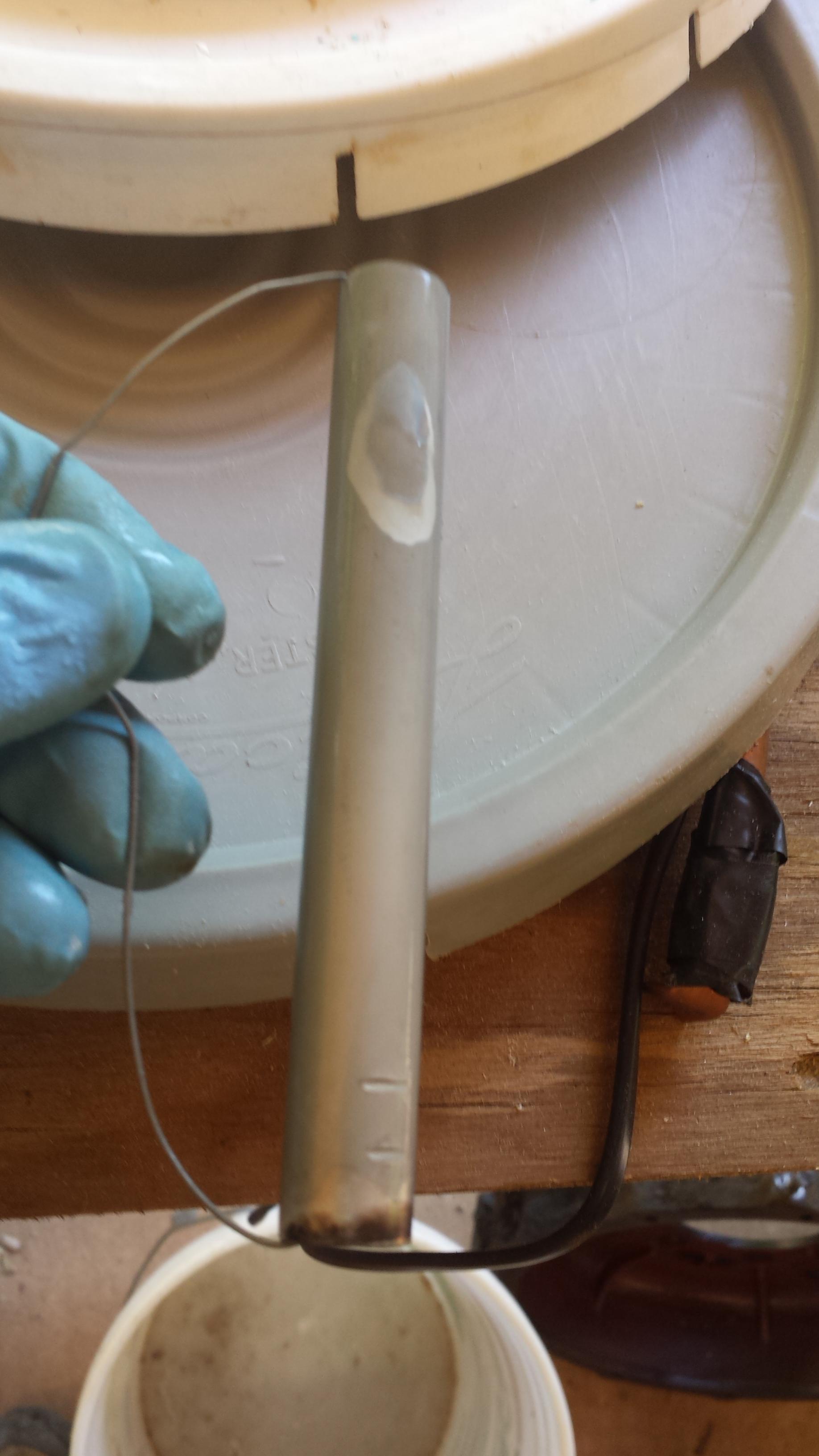

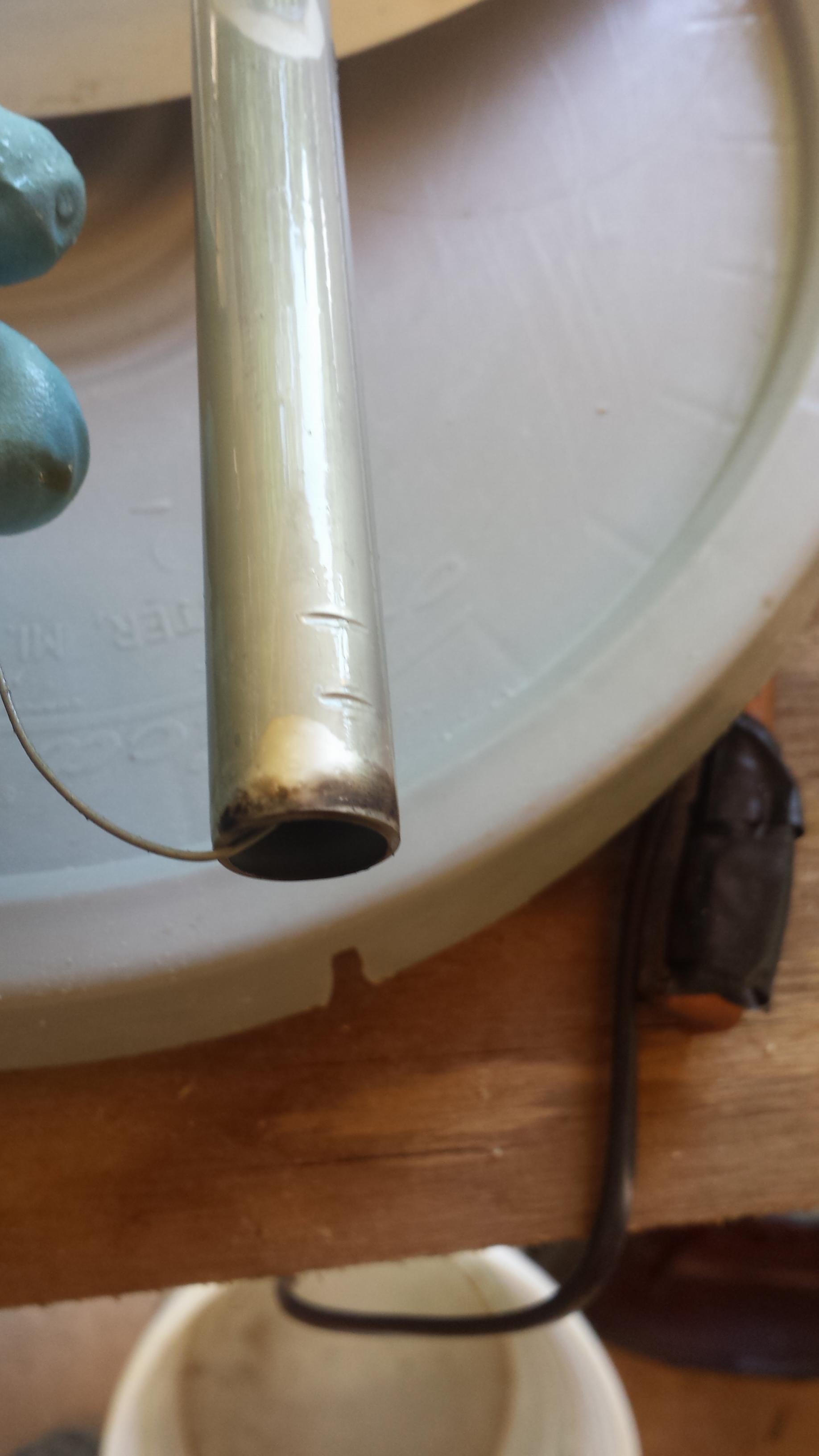

On the second piece the bottom started to burn or turn black from something. Any ideas?

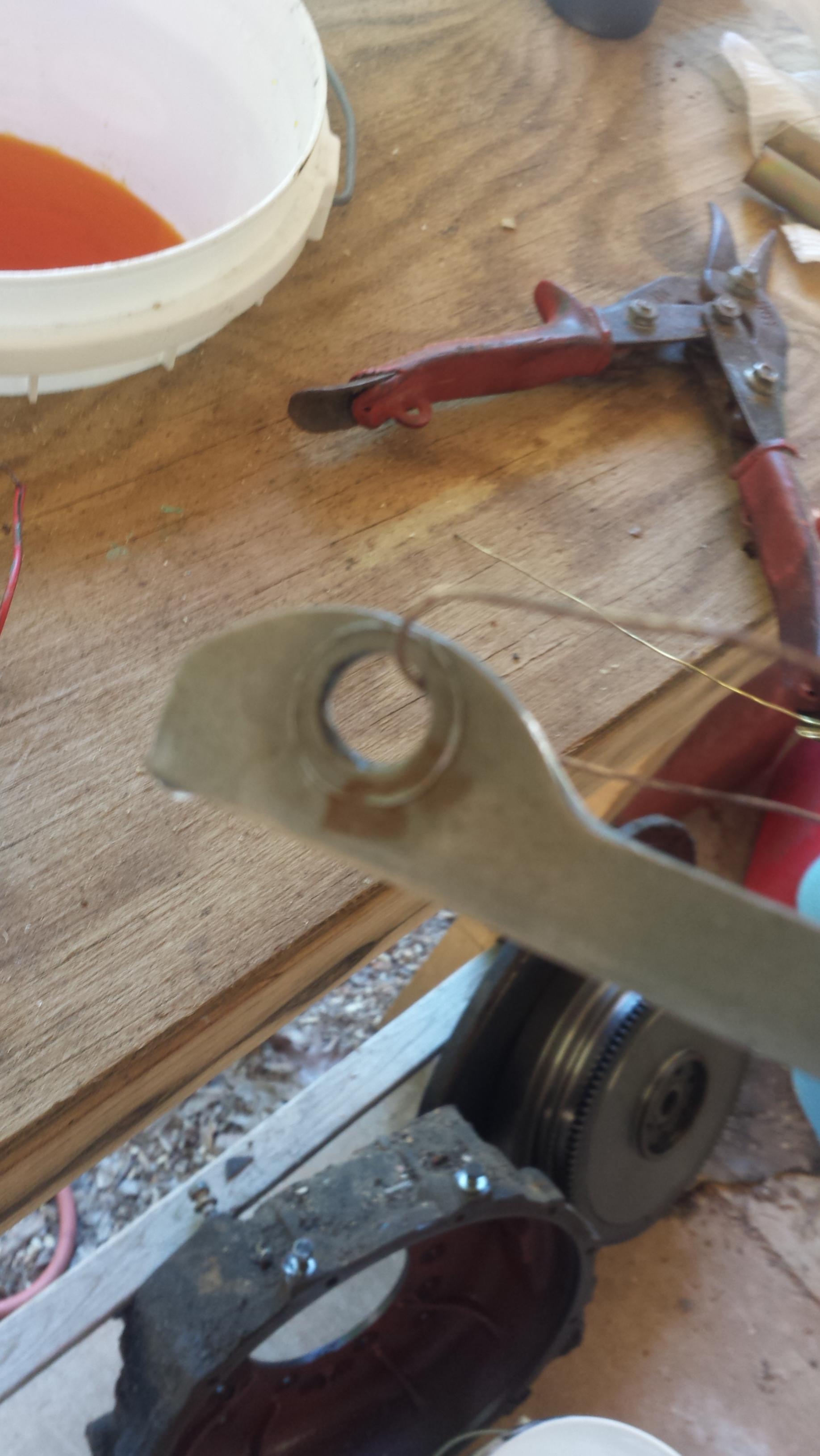

This is the fourth piece and has a little flash rust around one of the holes. I thought I would try it for fun

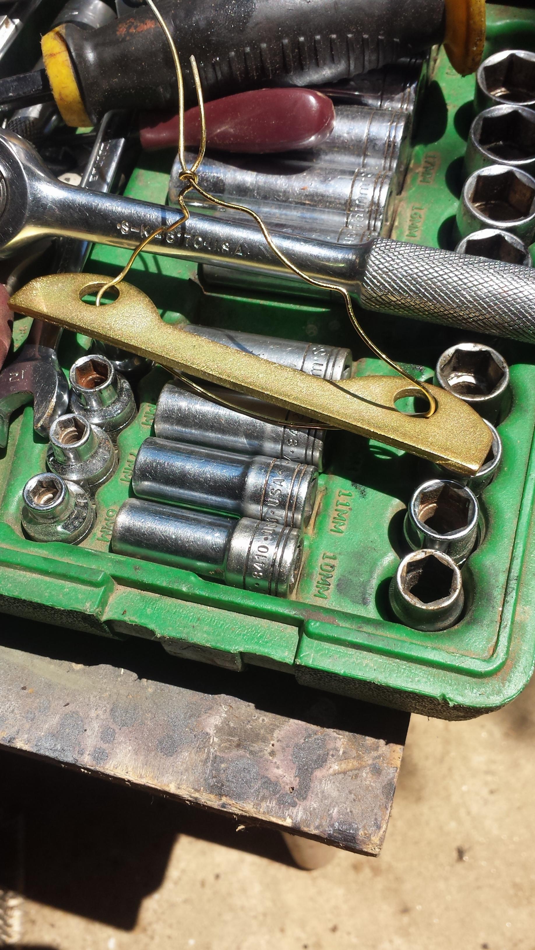

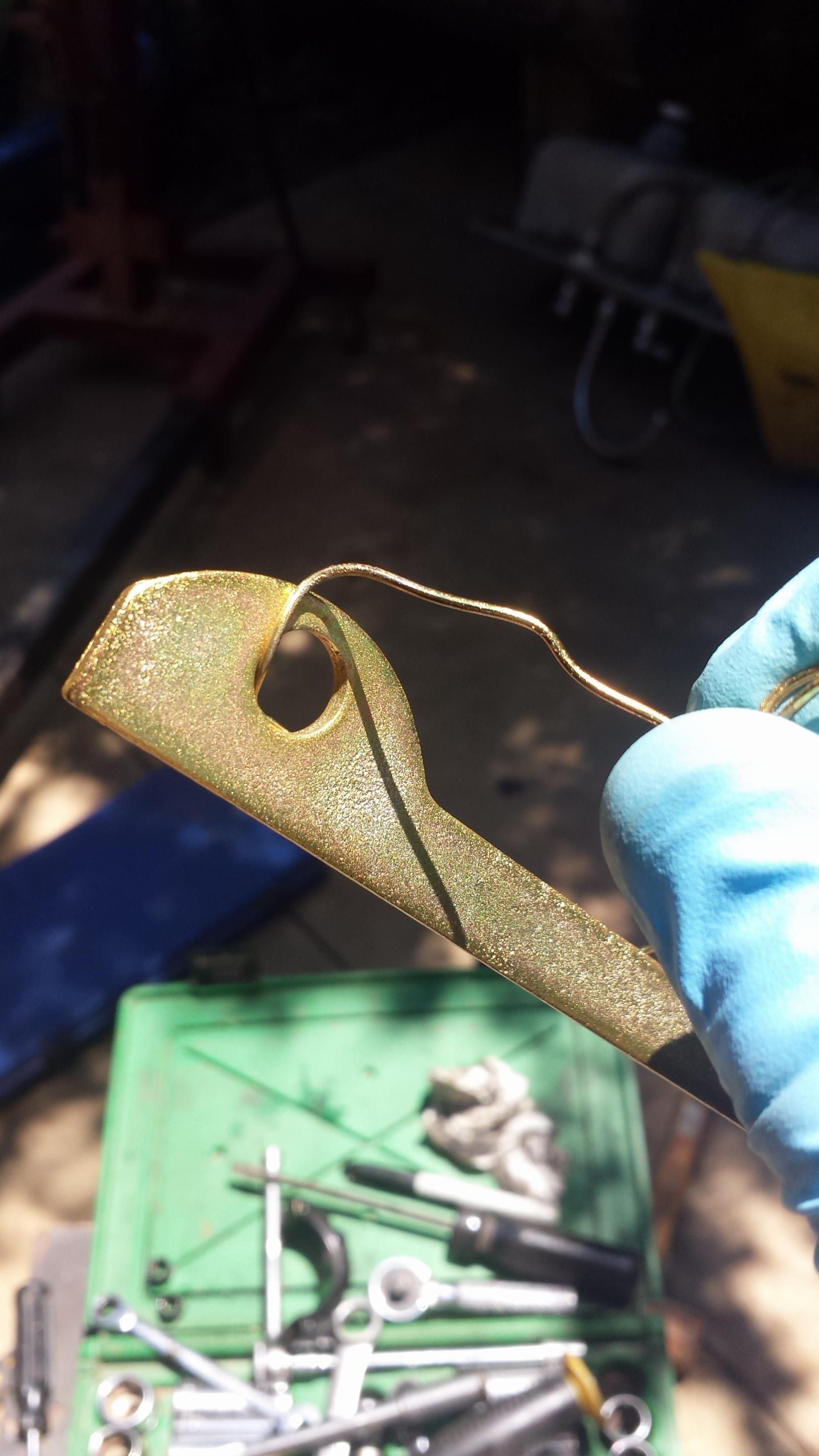

This is how it came out all finished...

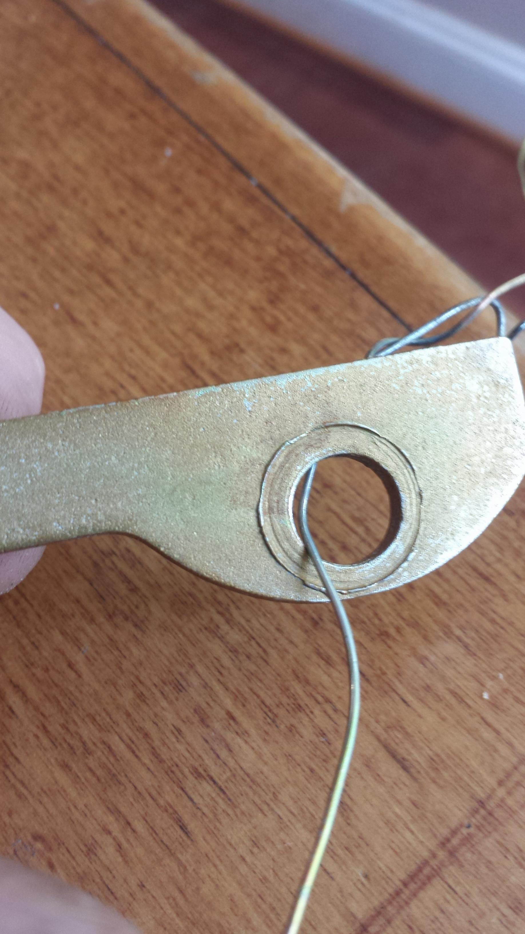

SP degreaser hot / rinse / acid dip for 20 seconds / rinse / plate for 20 minutes / rinse / chromate for 2 minutes
Not very noticeable but still there

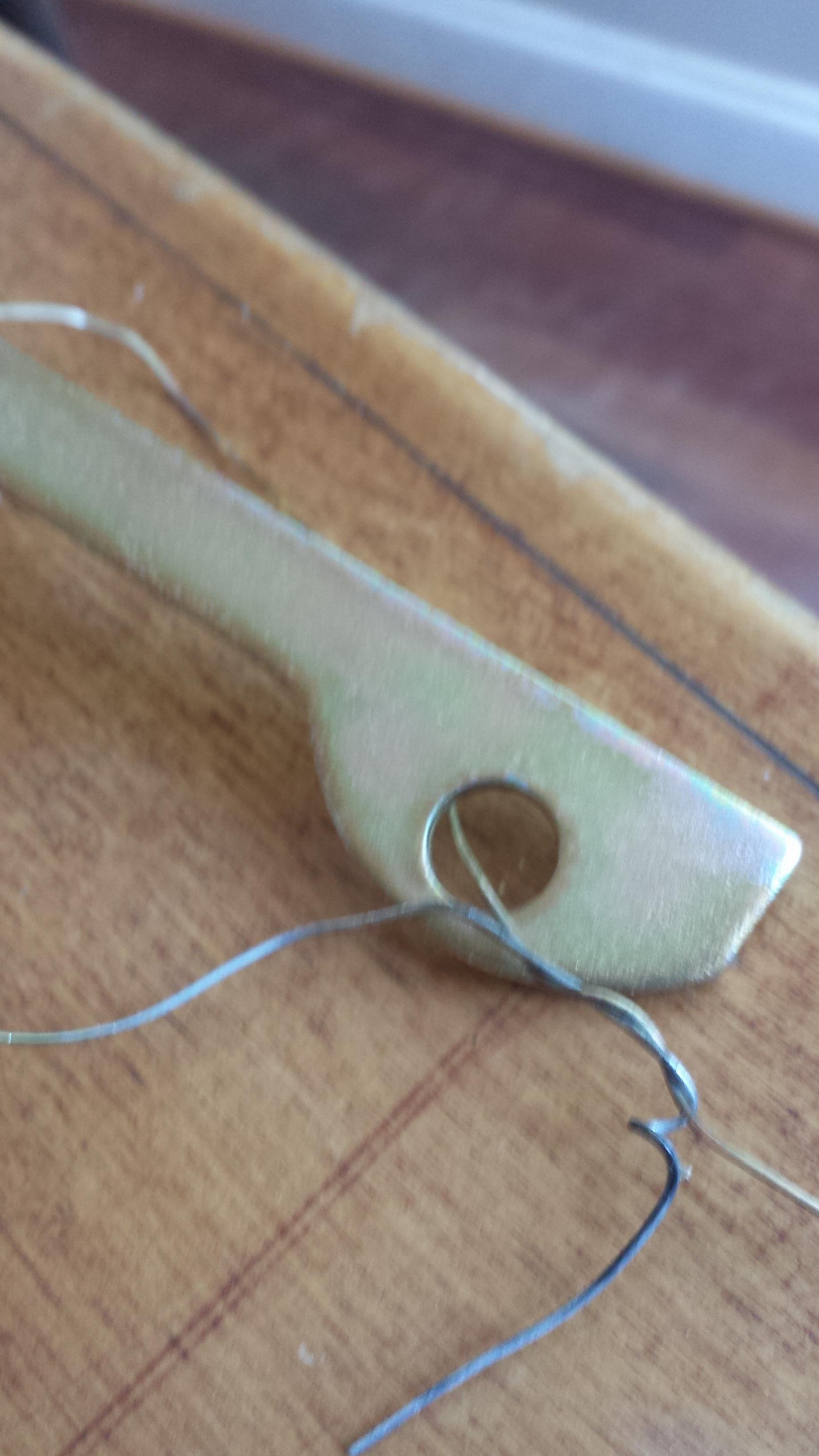

Did this one too but there were areas where the texture wasn't smooth and it sort of looks like pits with zinc in them but they didn't yellow with the chromate
I came up with pretty good color. Still have to work on the finishing before plating. I need to come up with a good solution to make them smooth. If the finish was smooth enough I could get the color pretty good.
One issue I ran into was after chromating I rinsed it and some of the chromate rinsed off along the edges where the finish was smoothing. Has anyone else seen this?

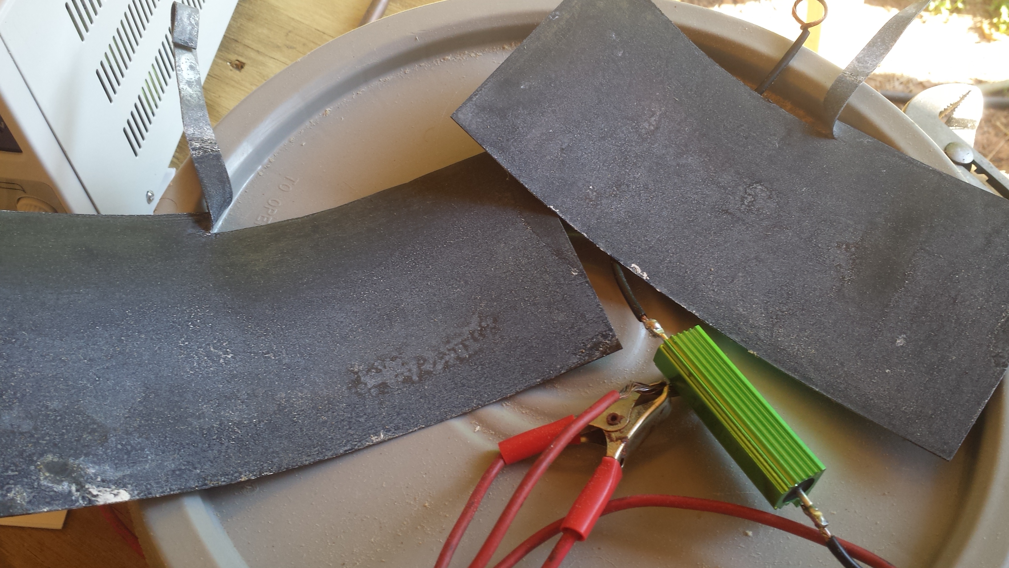

This is how the plates finished. Does the black affect plating? What do your guys plates look like?
10 hours ago, nix240z said:
Too much power (IE: current)  will cause black plates and a rough finish on the part.
Remember you will have to do a lot of trial and error to figure out what will work for your setup.
.Are you saying that the zinc anode plate will/should retain a shiny appearance under ideal current conditions?
The finish on the part seems pretty good. No rough looking at all at least if the part is smooth. I was wondering if the black could be contaminants in the plating solution...
