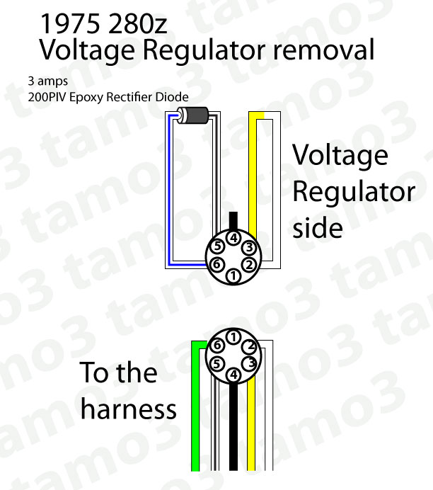

My '75 280z has only 5 wire for external voltage regulator.
When I googled, several people encounter issue for the missing #1 wire, which is green/red colored.
Blues web site is always helpful. There is answer for this.
HELP 75 Alternator swap
I just create illustration for this solution.
I will keep update the progress.

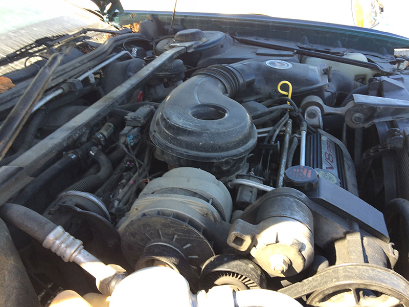

You can grab CS144 alternator from Cadillac DeVille. Try to find 92-94 in the junkyard.

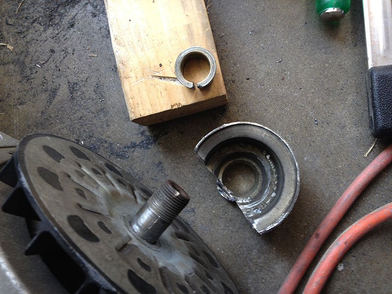

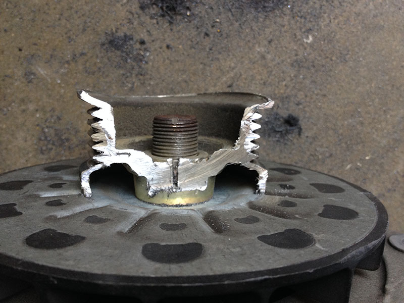

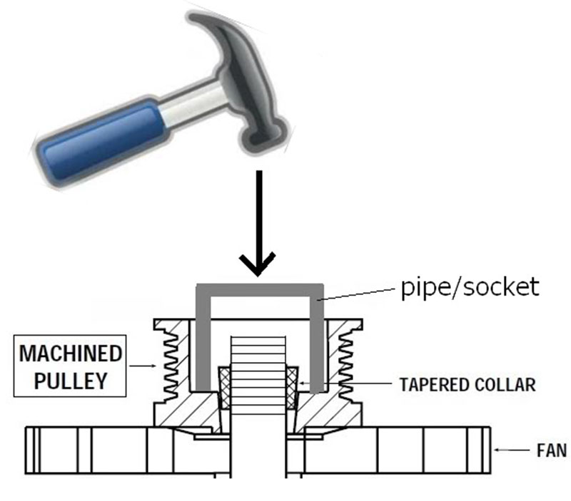

The hardest part is to remove pulley. There is taper collar that prevent from removing the pulley.
CS144 pulley removal - tapered collar type - International Full Size Jeep Association

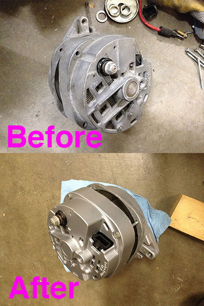

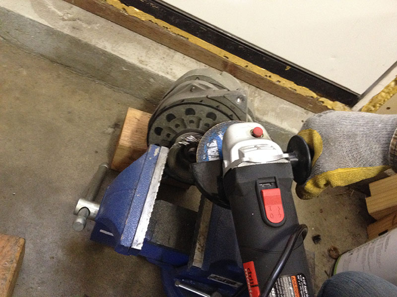

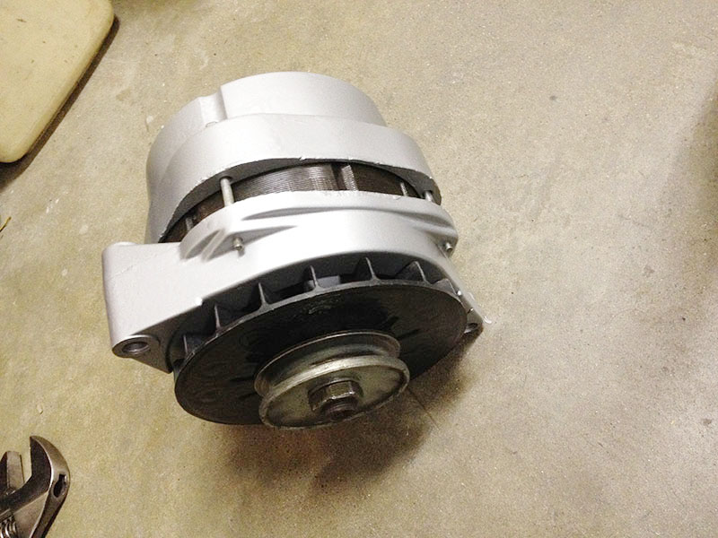

I could not remove the the taper collar, so I grinded to remove the pulley.
Just follow instruction video to rebuild alternator.
Part 1
Part 2

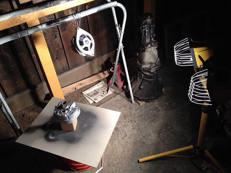

Paint the cover too.
completed.

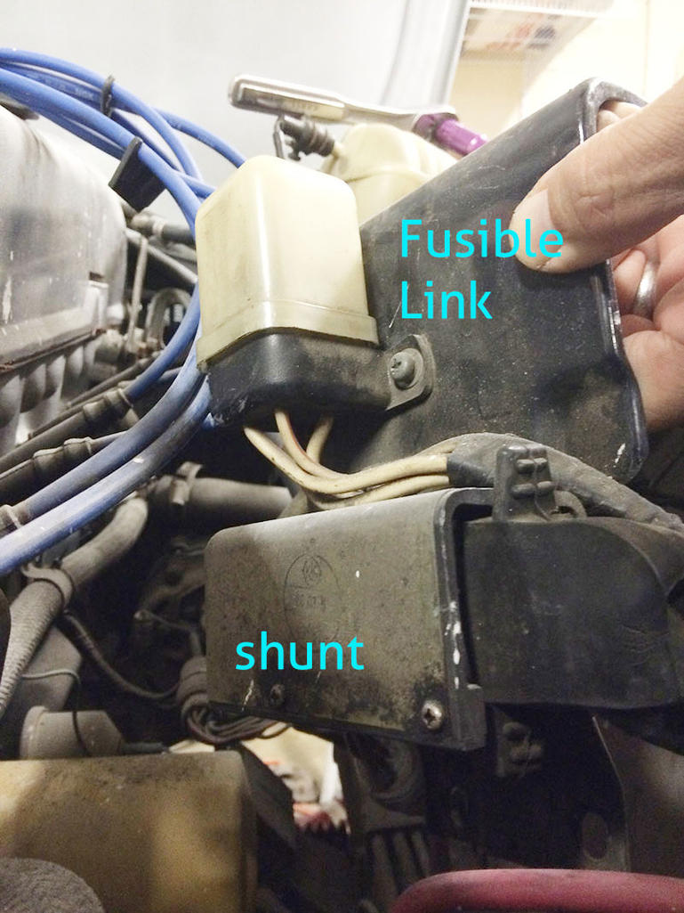

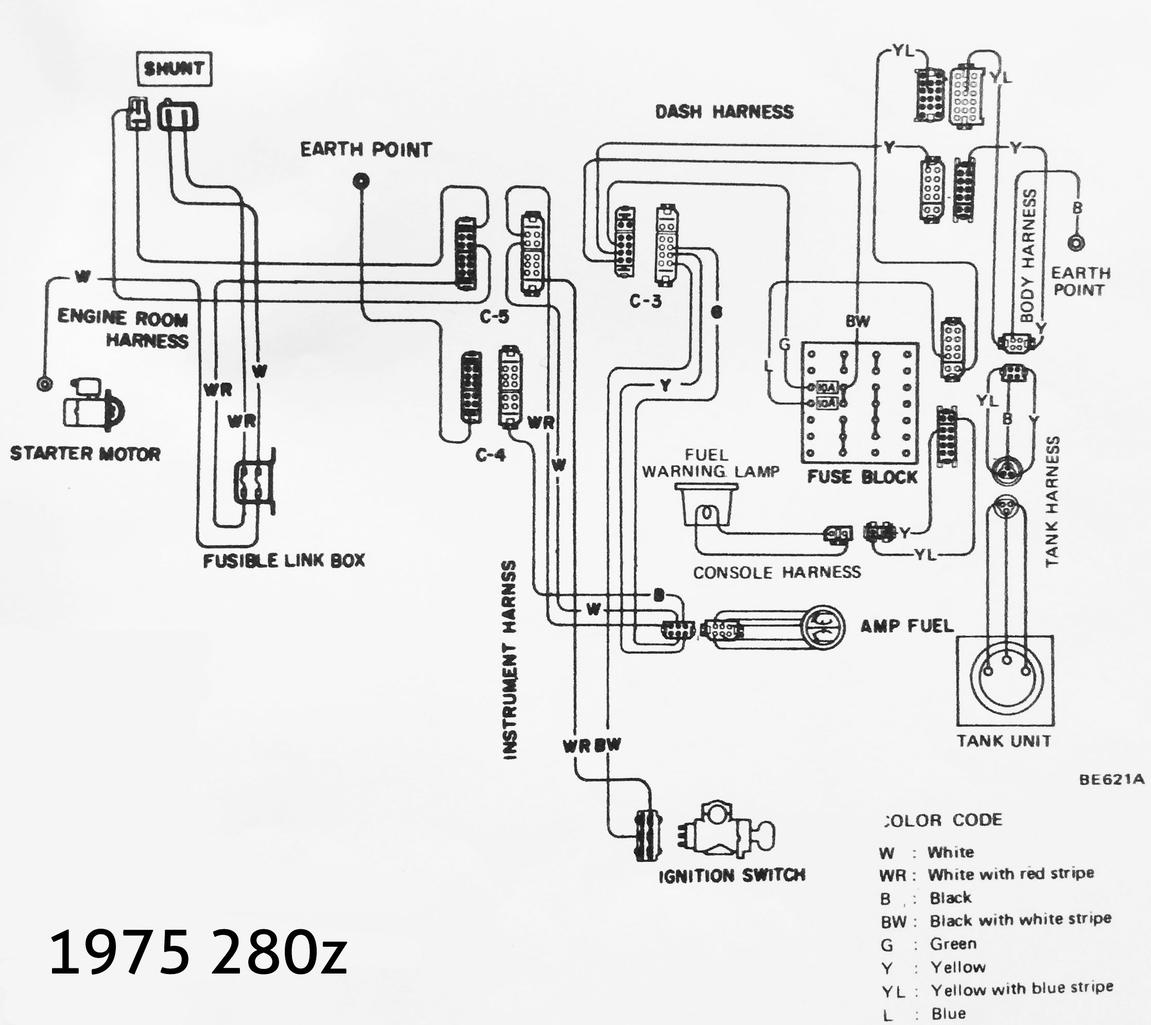

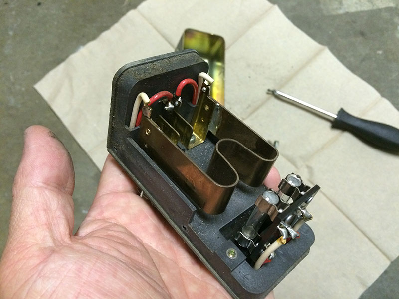

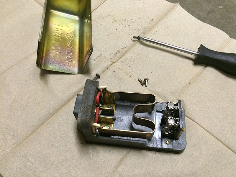

Shunt!
I searched on web, but I could not find any good information about '75 280z shunt.
I learn some earlier model has shunt inside of the car (maybe 240z, 260z?) later model is in the engine bay.

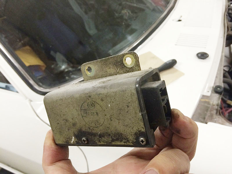

This is the shunt!

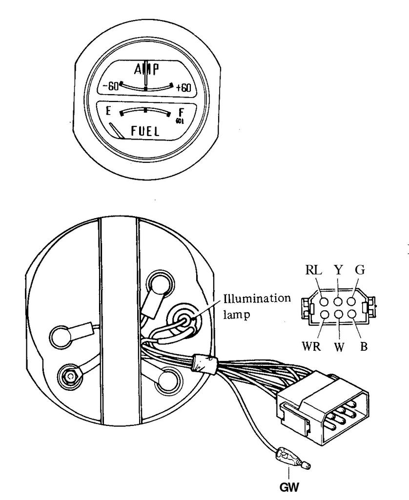

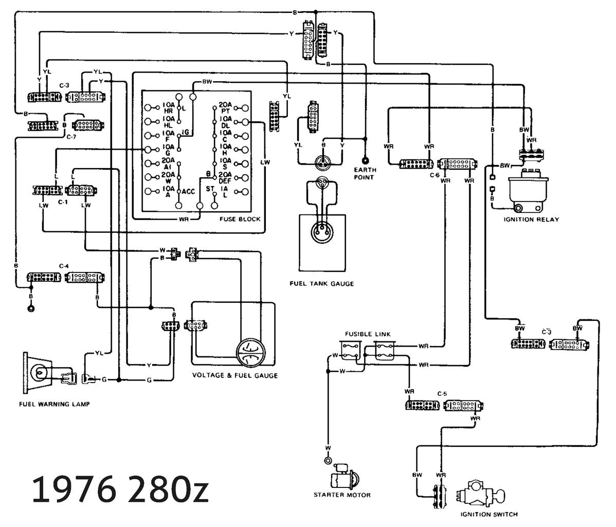

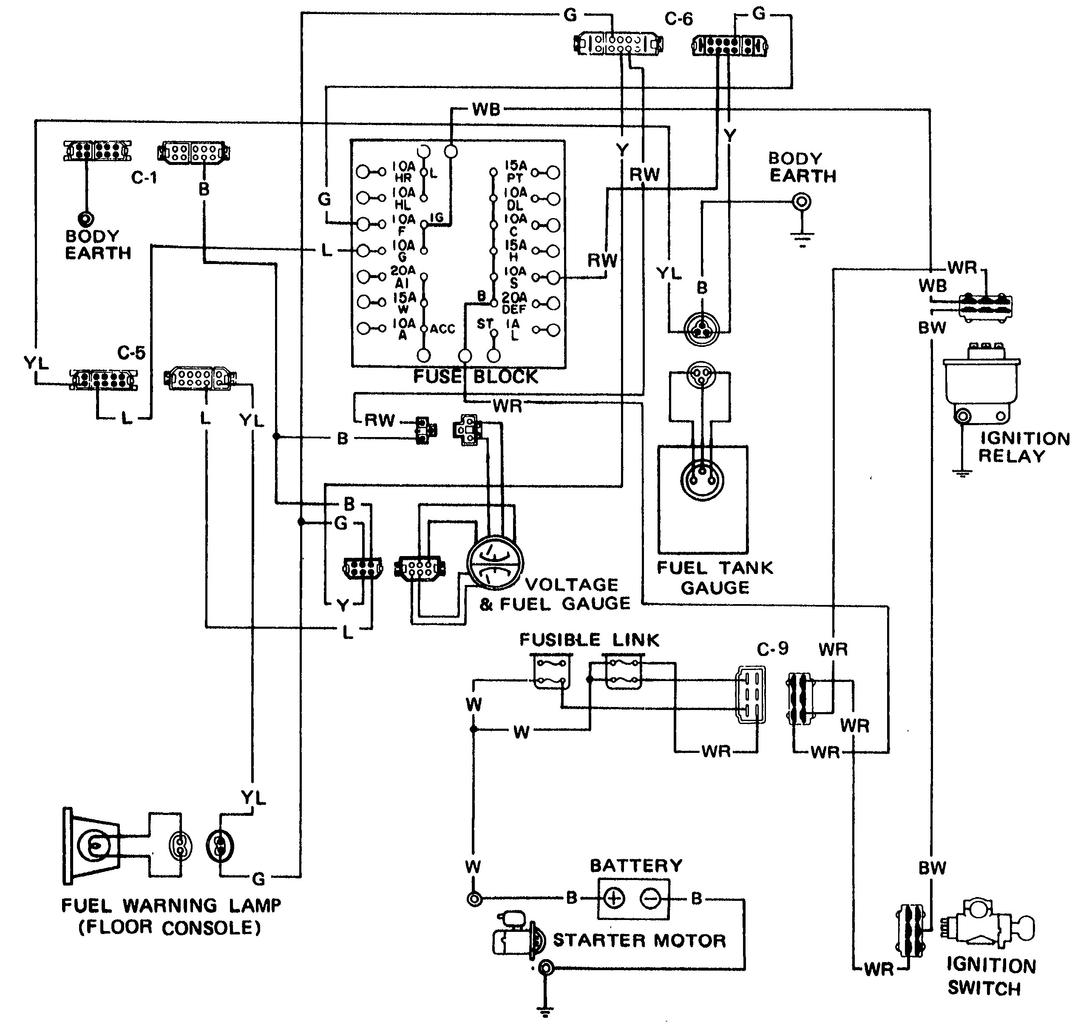

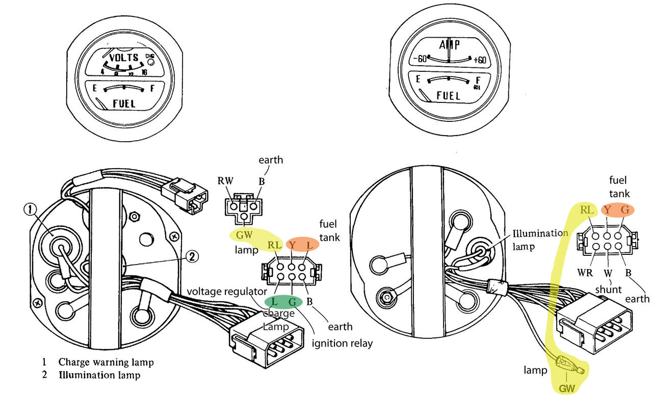

Voltmeter, Ammeter wiring comparison
75 Ammeter
76 Voltmeter
77 Voltmeter
78 Voltmeter
ammeter
voltmeter
connection comparison

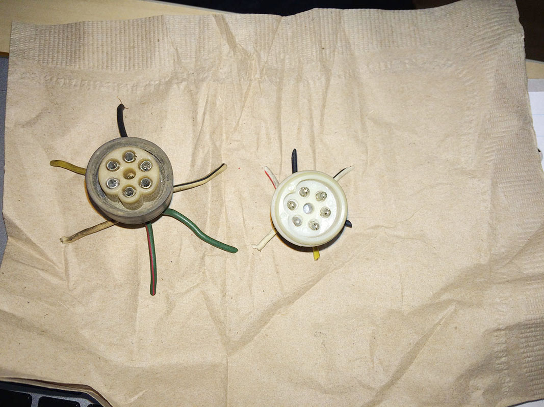

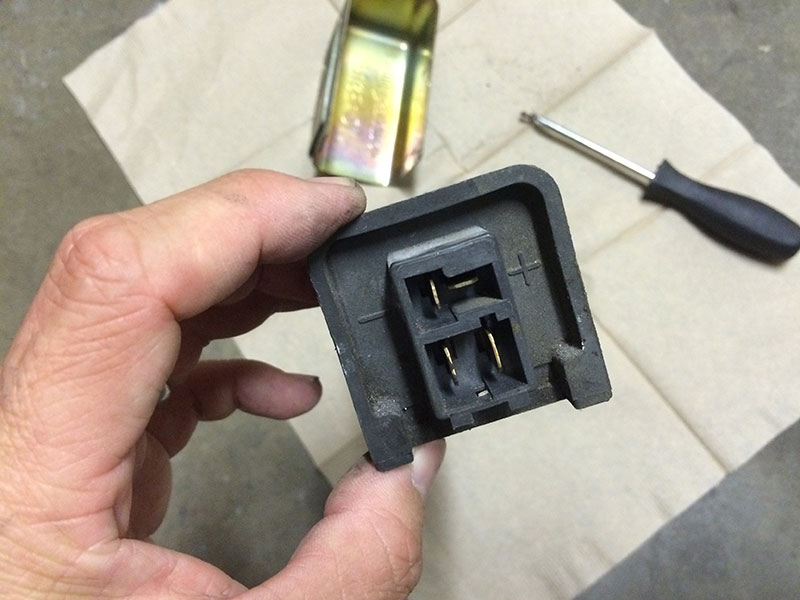

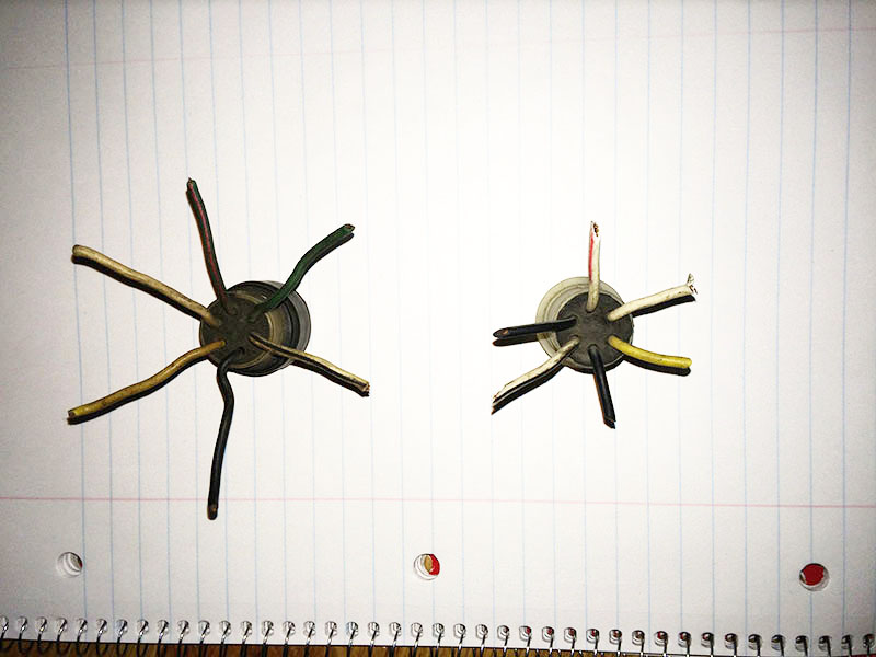

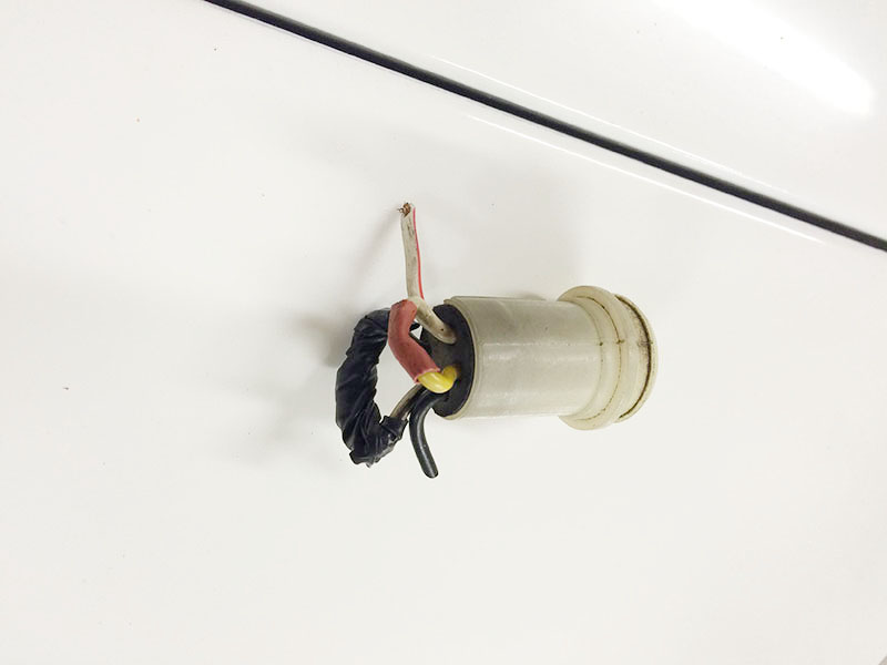

Got the donor connector from '76 280z.
post-24248-0-65802300-1415203225_thumb.jpost-24248-0-29419200-1415203242_thumb.j

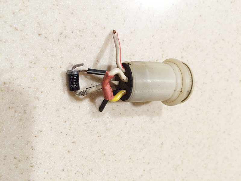

Add diode.
post-24248-0-66503000-1415203249_thumb.jpost-24248-0-51497900-1415203255_thumb.j
This dongle is for '75 280z with 5 wires. Can't use this for other year model.

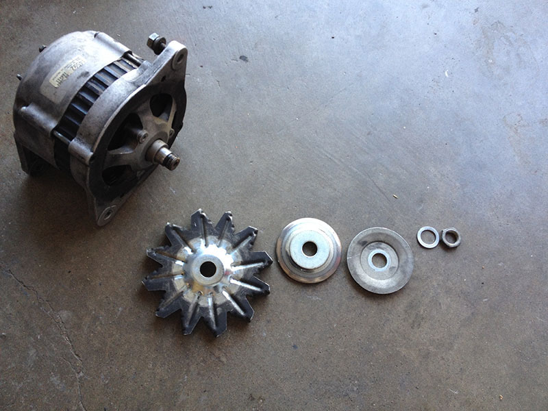

Here is the photo.
This is original Alternator.
post-24248-0-64301800-1415219760_thumb.j
V-pulley consists of 2 pieces.
The hole diameter is same. I can just mount it to CS144.
Mount the V-Pulley onto CS144.

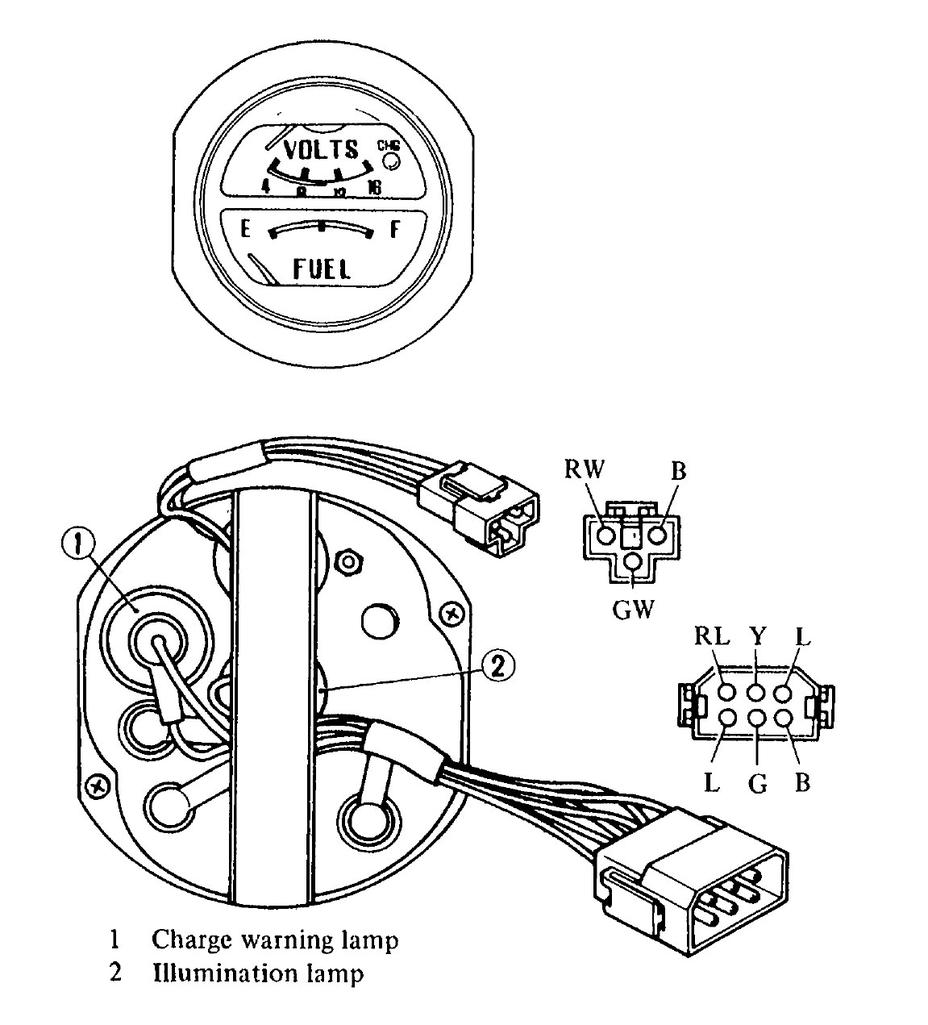

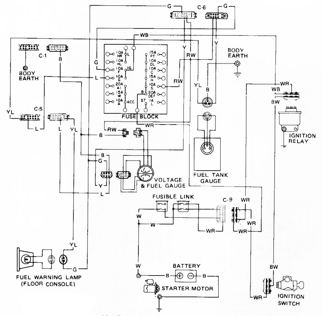

Working on Voltmeter re-wiring.
I follow the direction from zcar.com post.
http://www.zcar.com/forum/10-70-83-tech-discussion-forum/81242-amp-voltmeter-conversion.html#/forumsite/20721/topics/81242
No need to modify the big connector
Smaller connecter need to rewire.
- Black with red tag is measuring Voltage.
- Black connect to black wire in the big connector. This is ground earth.
- Green/white is connect to same as Ammeter.

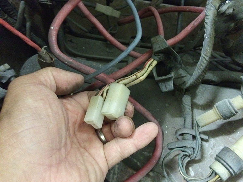

post-24248-0-08755200-1420586763_thumb.j
I need to find where I should merge this Voltage line near the fuse box....
post-24248-0-99779900-1420586769_thumb.j
post-24248-0-00799100-1420586777_thumb.j
Installed and run the wire.
Anyone direct me where should I connect the voltage measurement wire?
Thanks,
