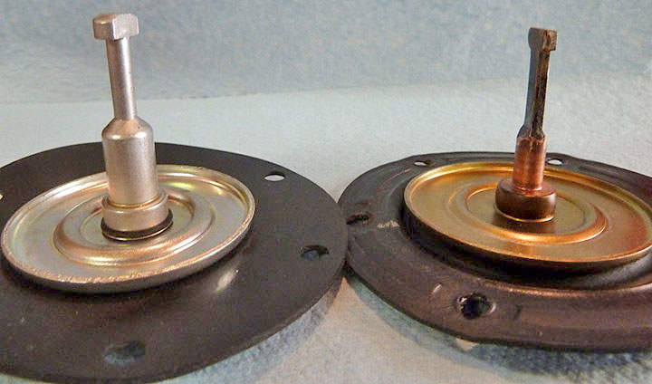

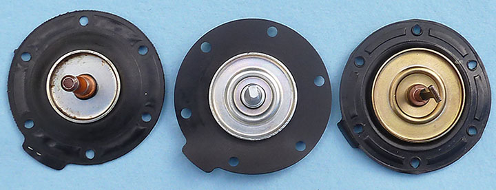

Answering my own question here - in a word, no. The OEM replacement diaphragm I got from Courtesy fits the Nikki but not the Kyosan because of a design difference in the rod that connects to the pump lever. I also was able to compare the new diaphragm with a 510 Nikki and it looks like the innards could be swapped, as some ebay listings for new 510 pumps suggest. The first photo compares Nikki 510 (L), Nikki replacement, and Kyosan. The difference in rod style between the 2 Nikkis doesn't seem to matter. The second pic shows why the thicker Nikki rod design doesn't fit the Kyosan pump.

Hi, I know that this is an old subject but having just stripped my pump down I find the diaphram has perished a bit and I am trying to replace it. The diaphram is exactly like the one in the bottom photo on the extreme left. I have obtained the correct material to replace it but can anyone tell me if the diaphram shaft  can be unscrewed to fit a new diaphram.  I would be grateful for any help I receive.   Kind regards. Tonytom B
