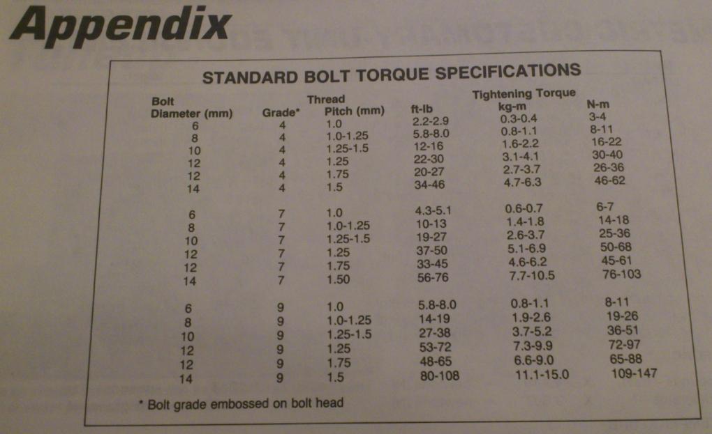

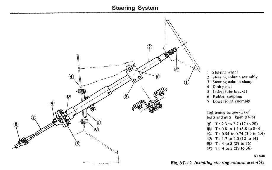

Another method is to check the torque specification in the FSM and compare that to the torque table from Nissan. That table has the bolts and strength grade number; 4, 7 or 9. That number is in the head of the original Nissan bolts. Then you need to find the bolts with the right length.
The example above would be "C" in the steering column 3.9 - 5.4ft-lb and the bolt table with the closest bolt is M6x1.0 Grade 7 (4.3 - 5.1ft-lb)
