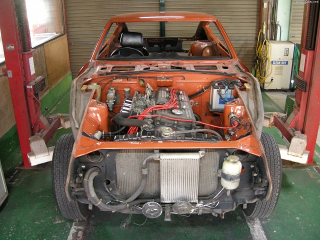

Does anybody have any info on this oil cooler and the leather wrap for it - thanks in advance.
I have searched extensively and found nothing other than the picture above.. I'm thinking about adding a 13 row 235mm oil cooler for those hard driving days - and the days not producing higher RPM keep things under a leather wrap. I would also put in a 200 degree thermo with the sandwich unit.

Agreed - I have a leather craftsman ready but trying to see how the original looks...........I'll keep on diggin............
Engine oil coolers were available from Datsun in the sports options and competition catalog. 21300-E4100. They require a special fitting for the hoses at the oil filter. BRE / Interpart also offered an oil cooler 1162050 with their own version of the fitting. It was manufactured by Stewart Warner. I don't see an engine oil cooler listed in the 1970 PS30SB Sports Option catalog however it does appear in the 1976 RS30 and HS30 Sports Option catalog as part number 21305-A0221. The special oil filter bracket is 15238-22000. There is also a cooler for the HS30, PS30, and PS30SB (21305-E4220) that looks like this one. This topic has been discussed - use the search function.
I don't recall anyone finding or making the leather cover. I would imagine the drawing is fairly accurate and you could have one made. The question, of course, would be what color to make it. Black or tan. Try searching for part number 21338-25510.
