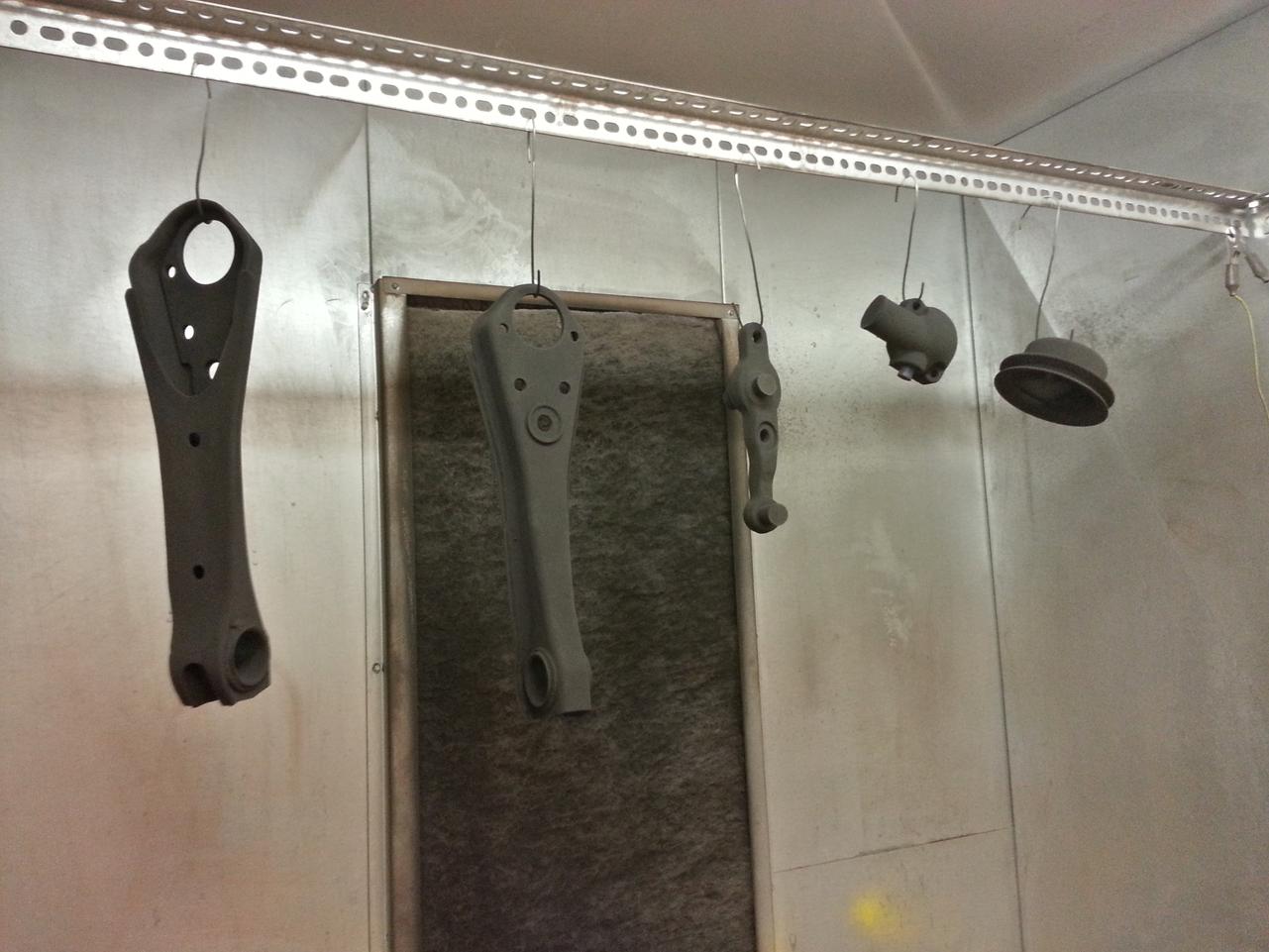

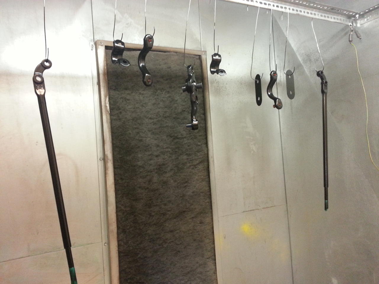

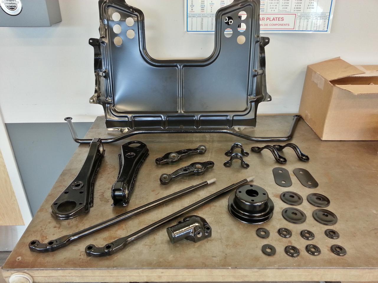

August 22, 201311 yr Author comment_430252 After sandblasting, the parts should be cleaned with Tri-Sodium Phosphate then wiped down with acetone. They rust extremely quickly at this point so it's important that they’re dry and to get the powder on quickly, then get them into the oven. I didn't get many pics of the process since I was working alone and getting parts cleaned and in and out of the ovens was keeping me busy. Here's raw powder on some parts: And some of them cured: All done! Pretty pleased with these results. Link to comment https://www.classiczcars.com/forums/topic/47001-caretaking-and-progress-updates-for-my-73/?&page=2#findComment-430252 Share on other sites More sharing options...

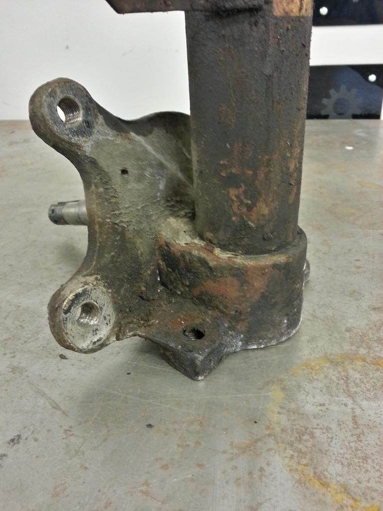

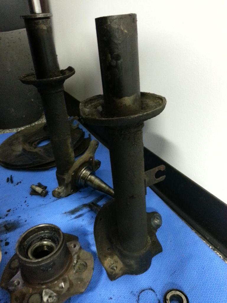

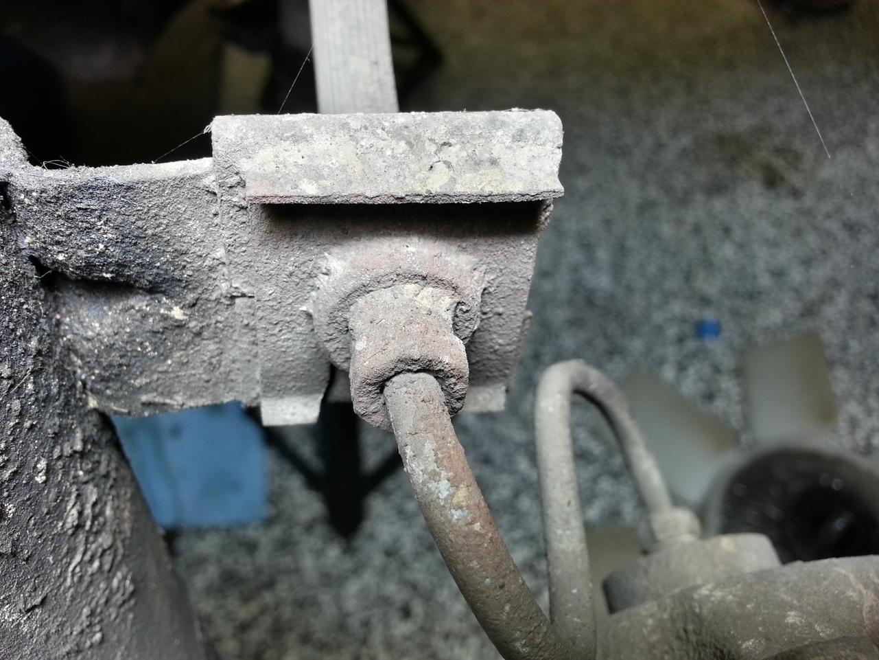

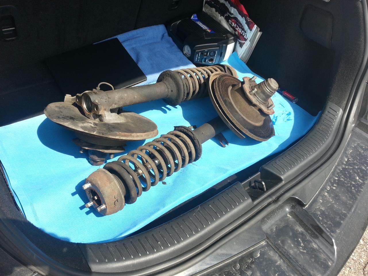

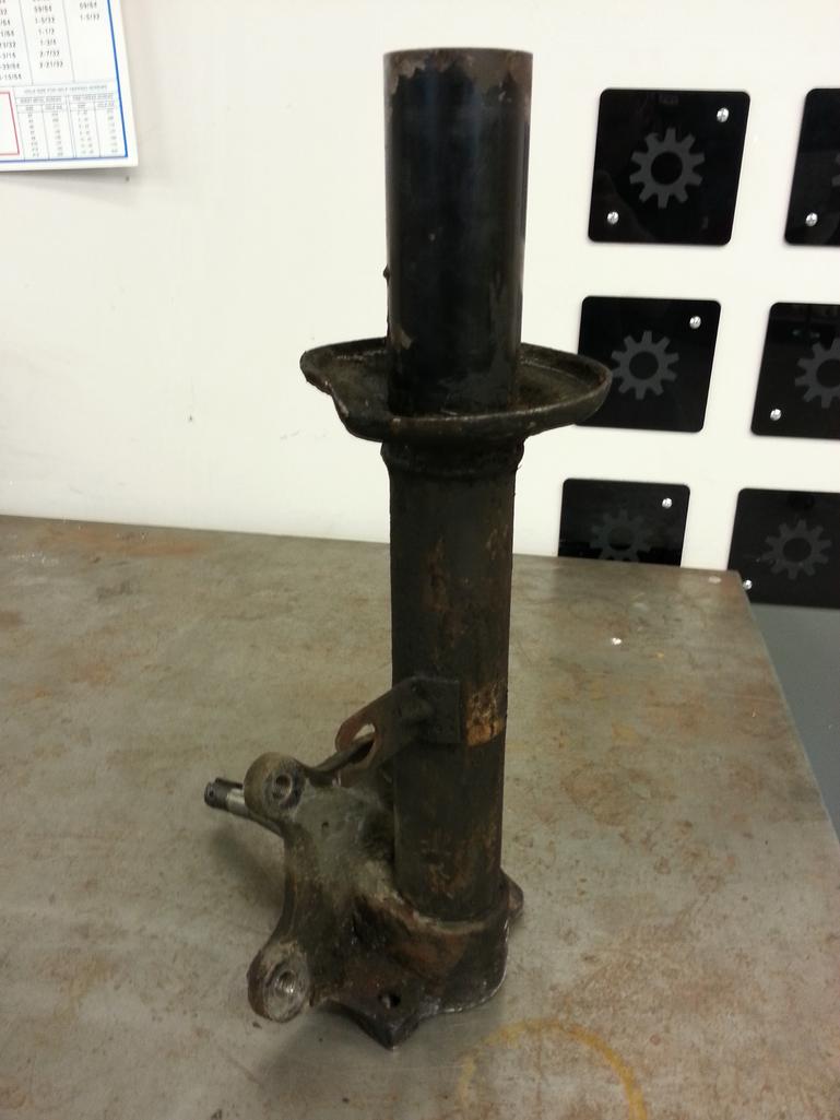

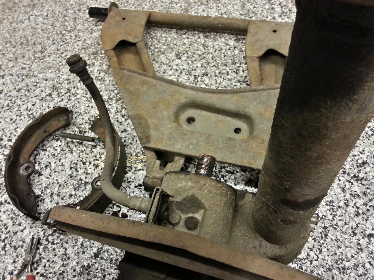

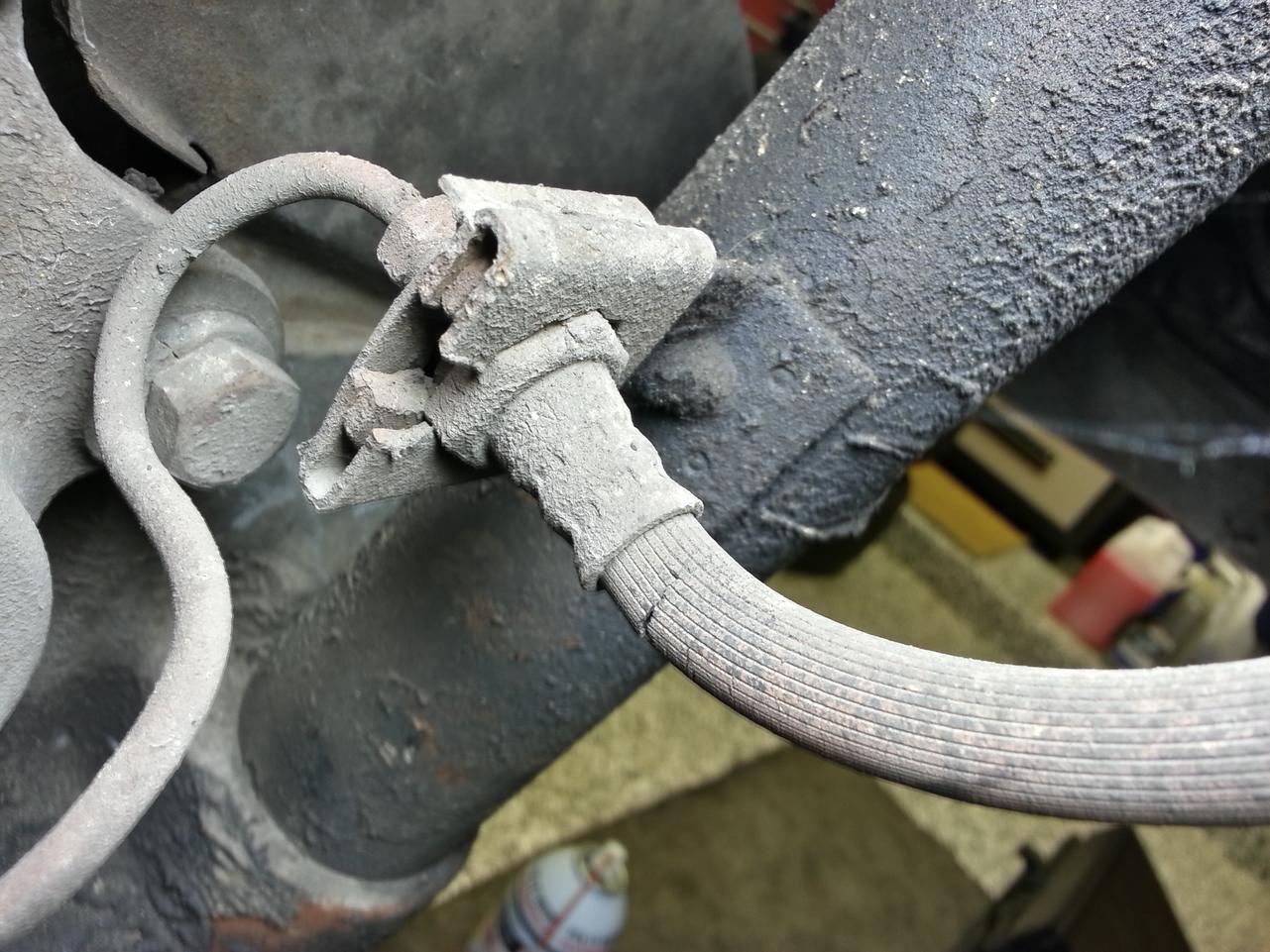

August 22, 201311 yr Author comment_430254 I had new bushings pressed into the control arms and was getting ready to re-install everything, but my hubs and struts are just as nasty as everything else and I'm having a hard time bolting the nice new stuff back onto it. I can't afford new shocks at the moment but I'm tempted to take the strut housings and hubs in to powder coat while I have everything else apart. I'm replacing the soft brake lines at each corner, so while I have the brakes apart I'd also really like to have my brake calipers refurbished by PMB Performance... All of this of course delays getting the car back on the road so I'm still going back and forth. Here are some shots of the crusty brake line connections. I wasn't even sure how these came apart but after some PB blaster and some FSM, I figured it out. Can anyone tell if the brackets have been cut? I don't think that slot in the first pic is supposed to be there. I suspect that when the shocks were last changed (in 1975), the mechanic cut the bracket so he didn't have to separate the brake lines to remove the struts... just a guess. Kind of an amusing story about the shocks - during my first test drive I could tell they weren't doing much so I asked if they were original. Brian proudly told me that he'd had Koni shocks installed "a few years back". I got a lot of paperwork with the car and it wasn't until I spent some time going through it that I found the receipt for the shocks, dated 1975! Yeah, they're basically brand new I wanted to post this up, too. While I was waiting for the powder coating situation to sort itself out I did some work on the cooling system. The water pump and water inlet both seemed to be leaking so I replaced them. I started sandblasting the water inlet, intending to reuse it and this is what I found. 40 years of coolant-turned-acid will do this to aluminum, apparently. No wonder it leaked. Edited August 22, 201311 yr by bacarl Link to comment https://www.classiczcars.com/forums/topic/47001-caretaking-and-progress-updates-for-my-73/?&page=2#findComment-430254 Share on other sites More sharing options...

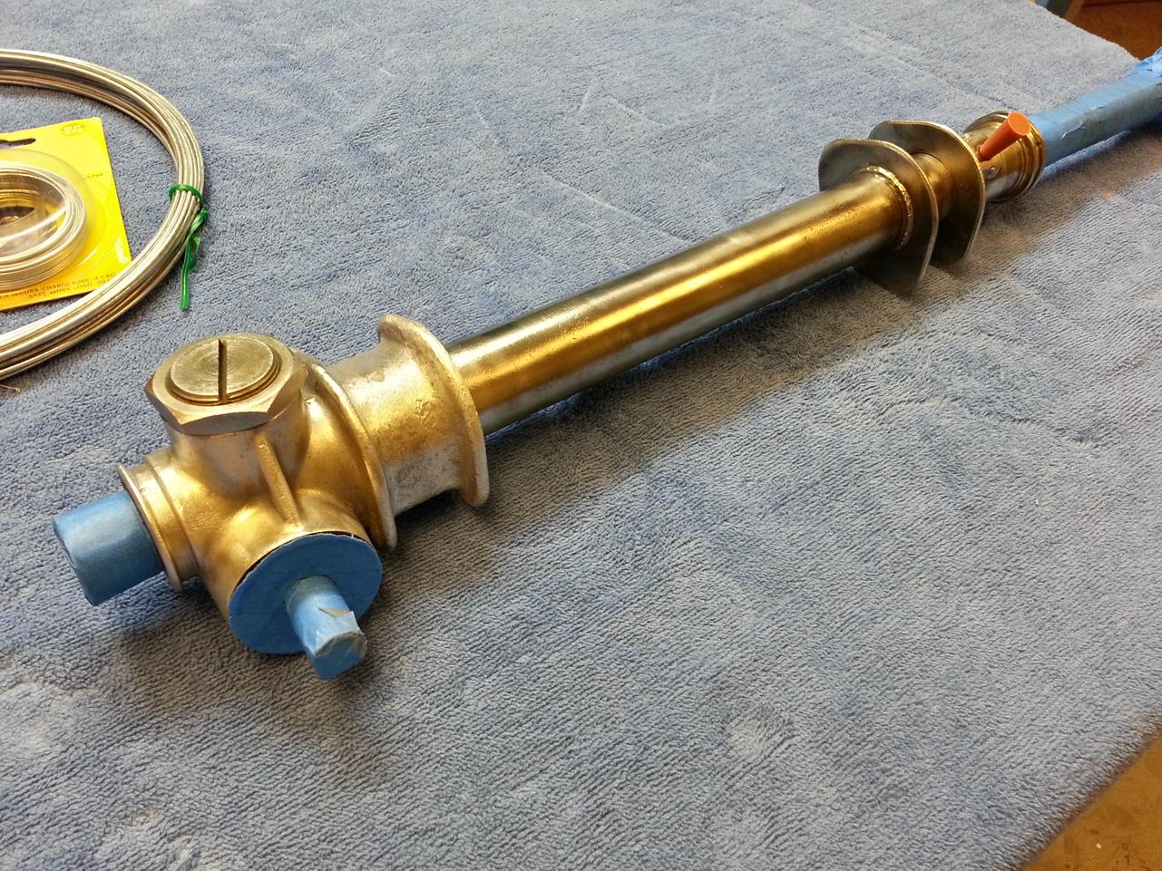

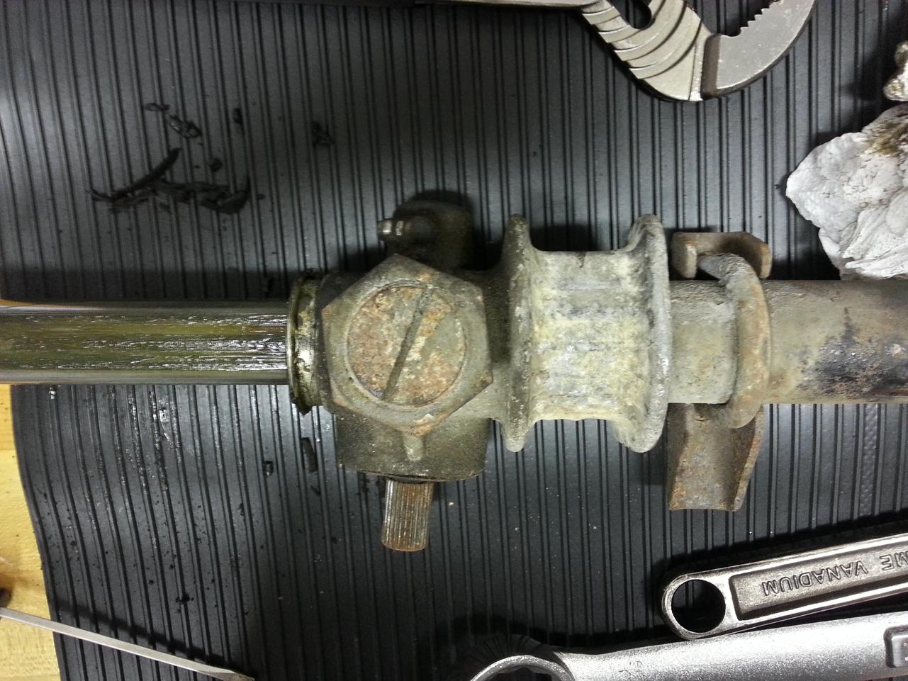

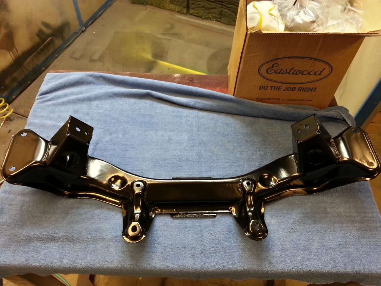

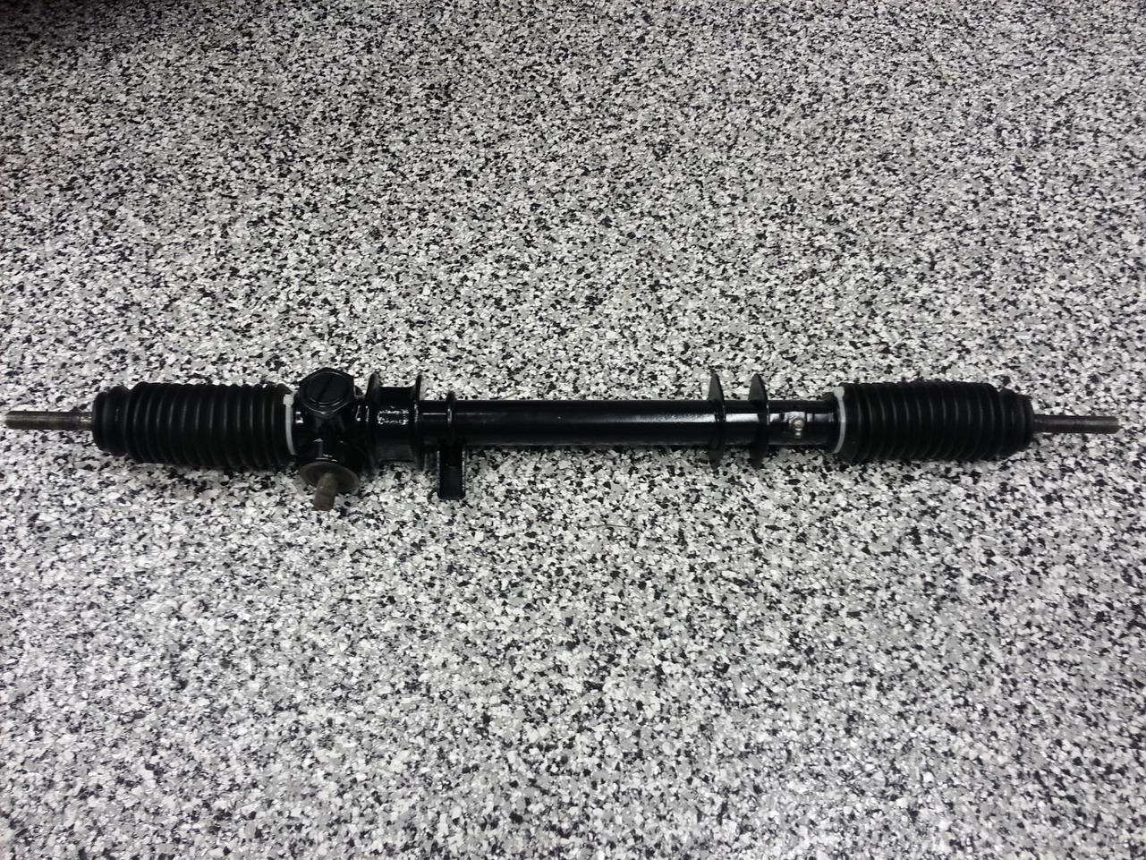

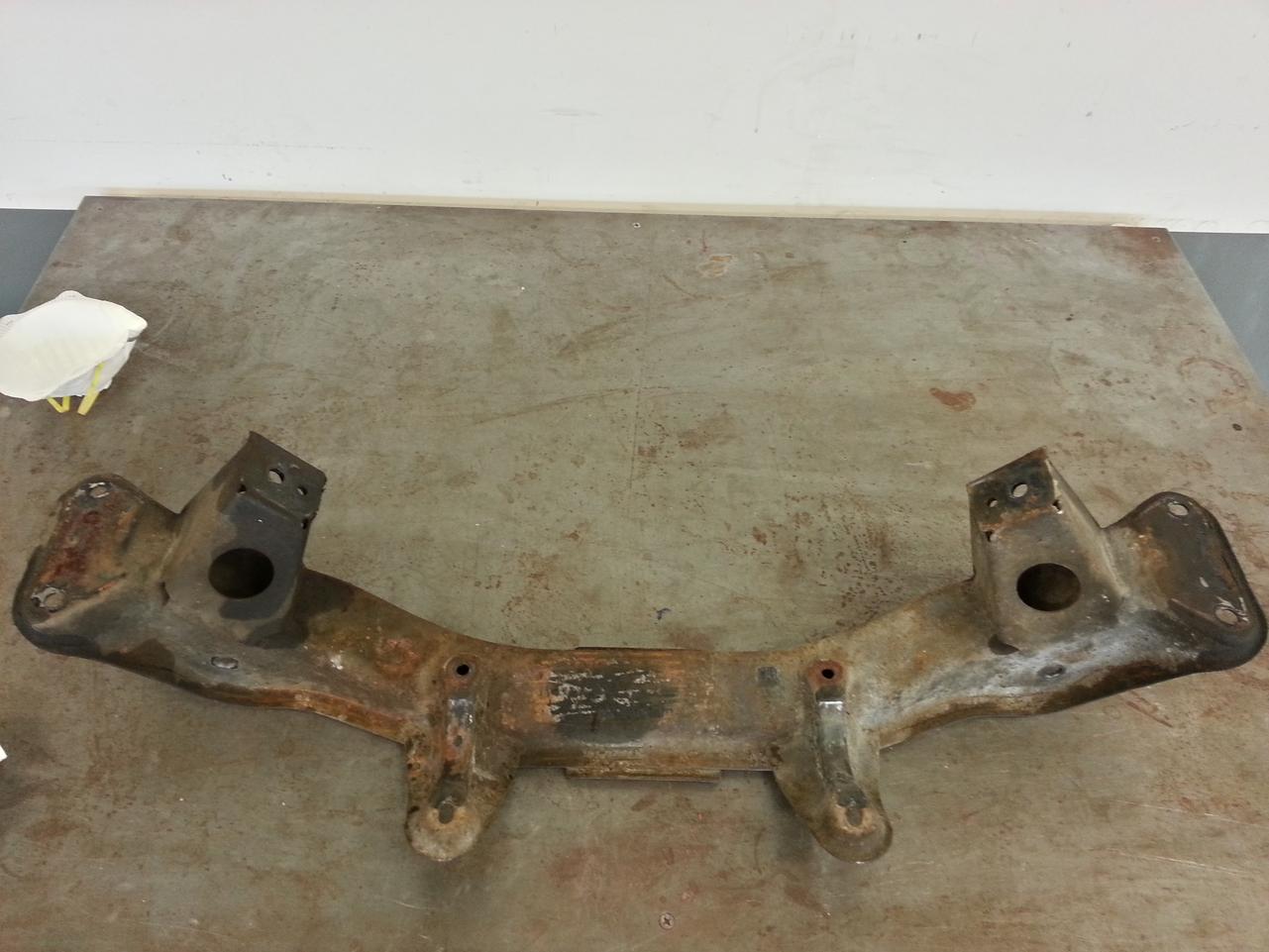

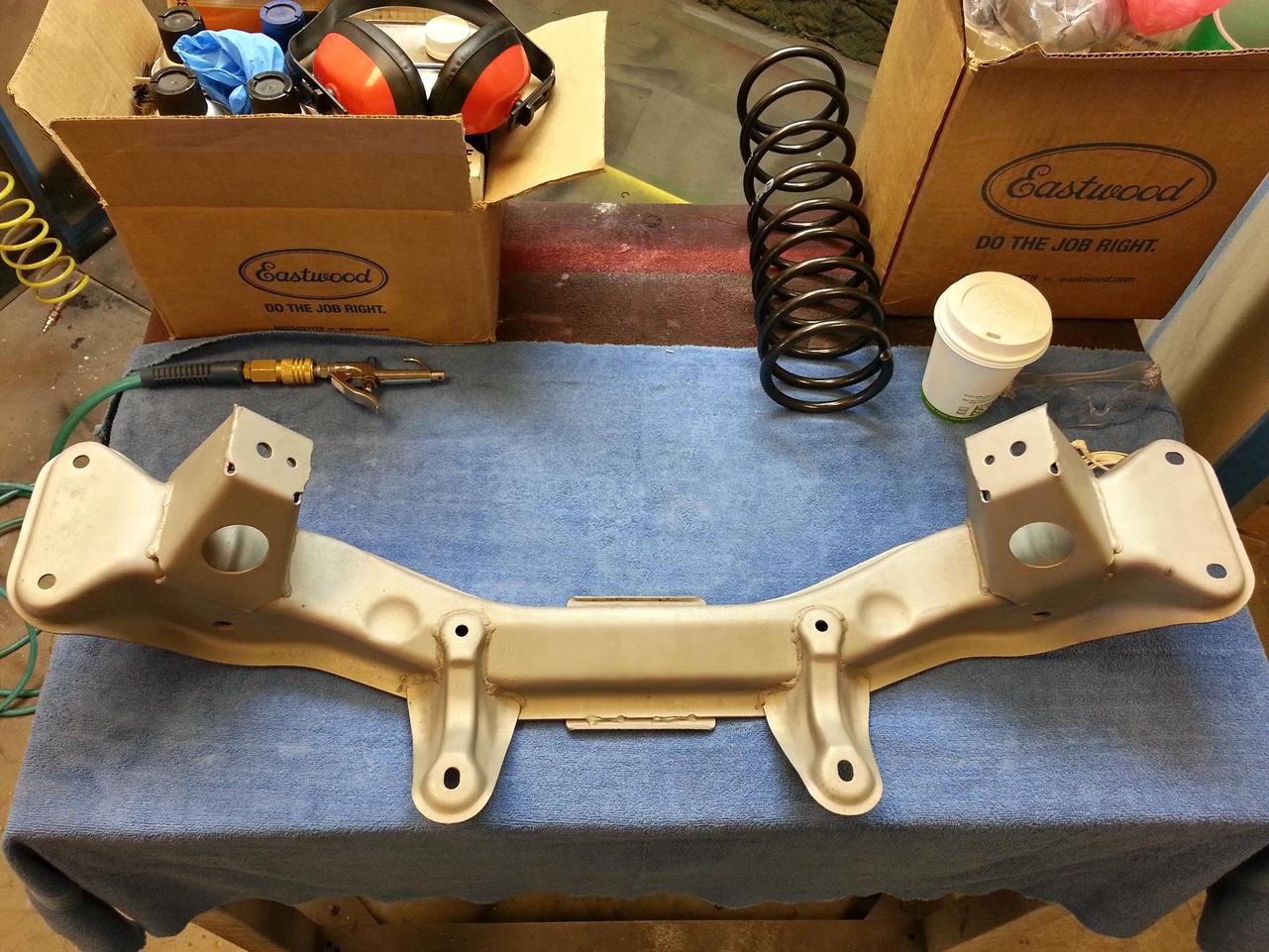

December 5, 201311 yr Author comment_437461 Update: It turns out that me and my obsessive compulsiveness are highly susceptible to the "while I'm at it" affliction, which results in me diving deeper into projects than I originally planned and getting hung up on a lot of little details I have a hard time skipping steps or leaving things done improperly. Good thing I don't have a time table for this thing. I had not intended to remove the front crossmember & steering rack, but I ended up doing it anyway. I powder coated the crossmember and partially disassembled, cleaned and painted the rack. K-member Before Sandblasted After Rack Before Wire wheeled After (sorry for the seizure-inducing epoxy floor chips!) Link to comment https://www.classiczcars.com/forums/topic/47001-caretaking-and-progress-updates-for-my-73/?&page=2#findComment-437461 Share on other sites More sharing options...

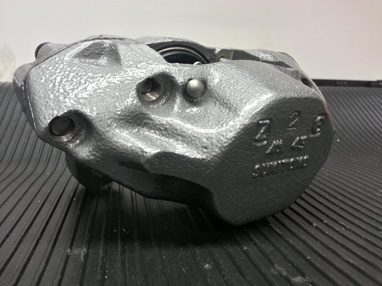

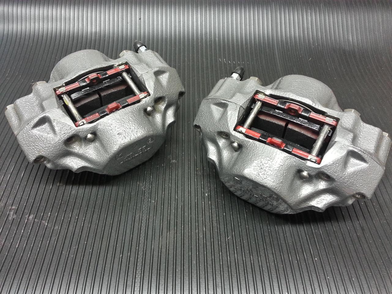

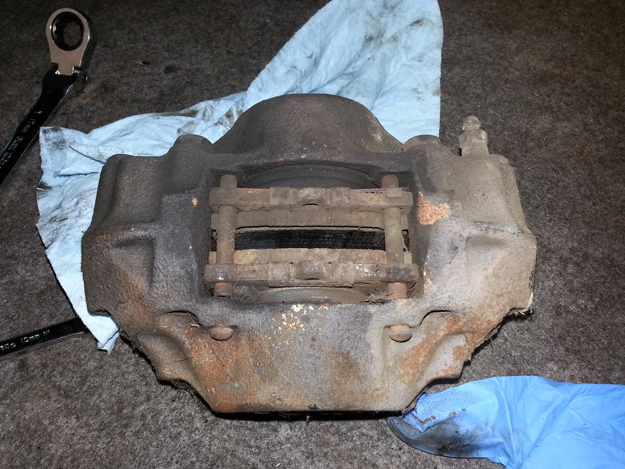

December 5, 201311 yr Author comment_437463 I had wanted to have PMB Performance restore the calipers, but I found a local place that specializes in caliper rebuilds so I went with them in the interest of supporting local business (and saving lots of money). Before they reassembled everything, I went ahead and powder coated the calipers (like a crazy person). They're loaded with Carbotech pads, which I've used as track day pads in my daily driver and liked. These are a less-aggressive "performance street" compound which is supposed to provide excellent modulation and initial bite, low dust, and low noise. Here's a close up of the finish, which turned out really nice. This is a fairly high-temp powder (600F) which recommended a clear coat for exterior use/UV resistance. So yes, I clear coated my calipers. Told you it was an affliction :-/ Here's the before And most recently, I've just put my struts back together. I used to be a chassis guy at work, so things like springs and dampers are near and dear to me. I wanted adjustable shocks (never had those before) and I would have loved to play with spring rates, coilover style, but I don't want to hack up my struts. So I went with the tried and true Illumina + Eibach combo. Before After - powder coated struts and spring seats, Tokico adjustables, Eibach Pro-kit, poly jounce bumpers, and new isolators. You can't really tell in the pic, but I did the gland nuts in a different color - a powder close to "Datsun blue" - just for fun. One of the best things about powder coat (maybe the best thing) is ease of cleanup. Changing colors is as easy as blowing out the gun with compressed air and dumping the new color into the hopper. Makes it possible to do silly things like blue gland nuts with a bunch of other black parts. Here are some shots of the nice crusty strut housings during the process. Edited December 5, 201311 yr by bacarl Link to comment https://www.classiczcars.com/forums/topic/47001-caretaking-and-progress-updates-for-my-73/?&page=2#findComment-437463 Share on other sites More sharing options...

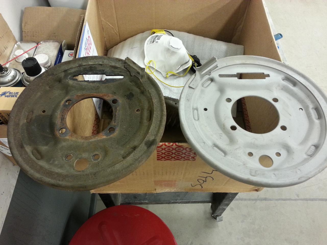

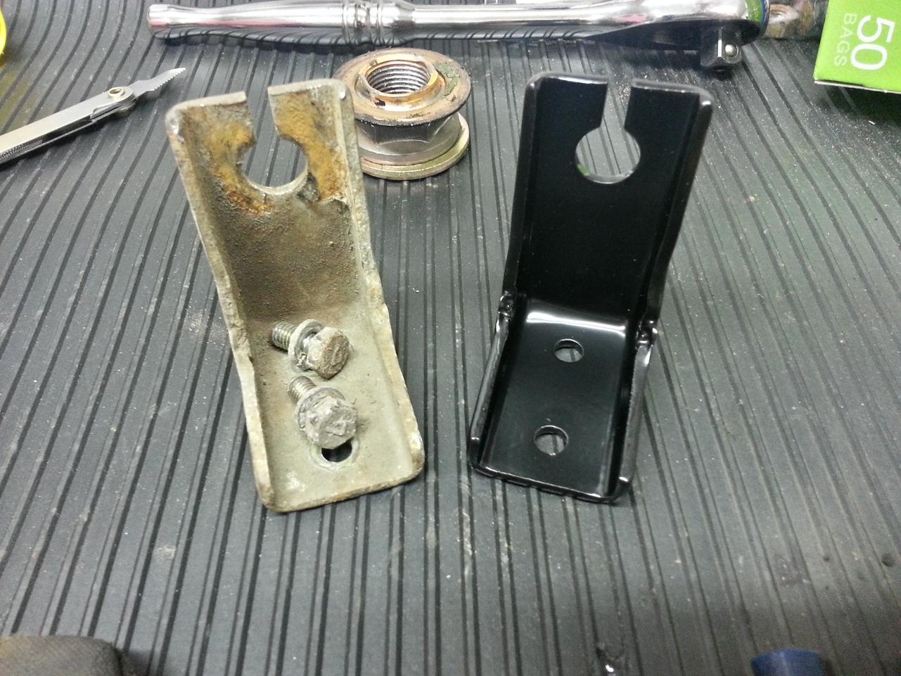

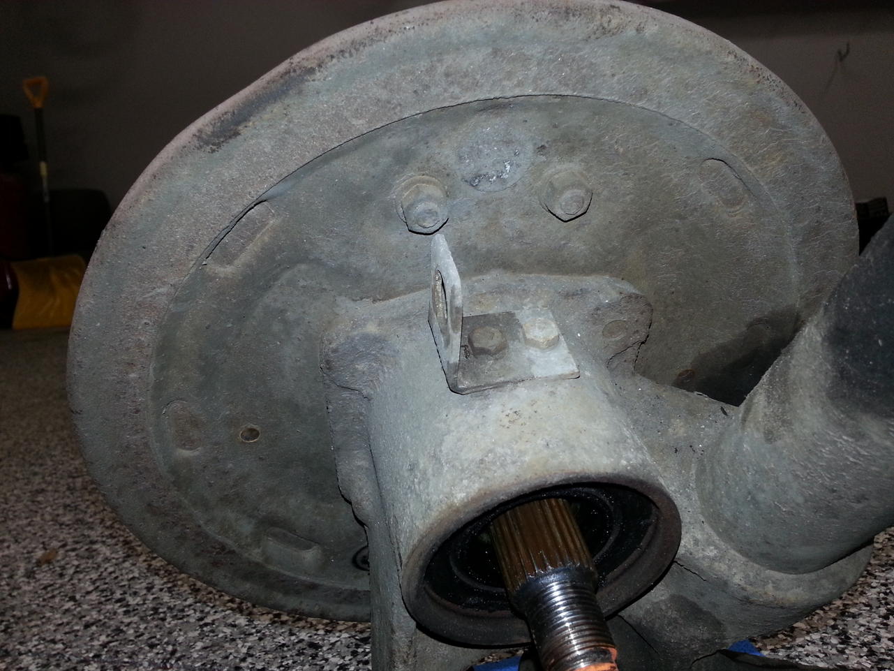

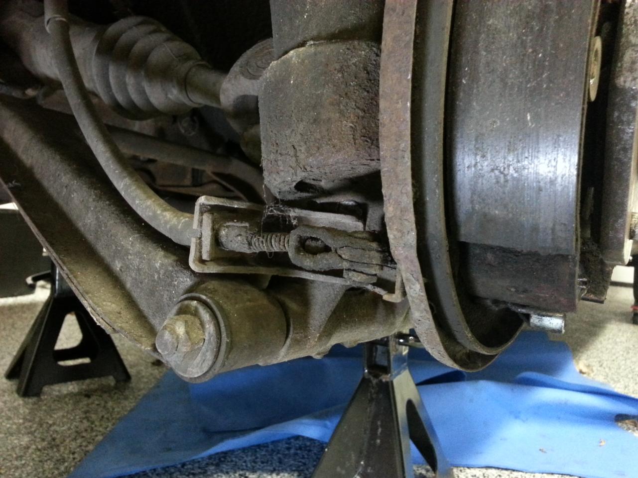

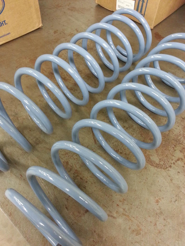

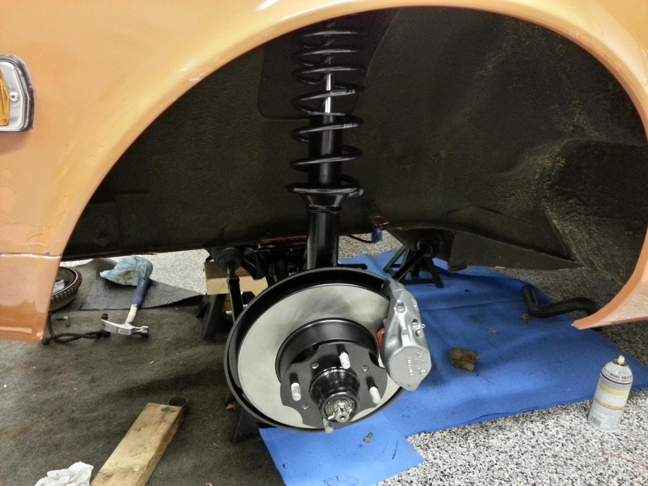

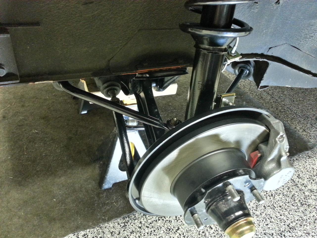

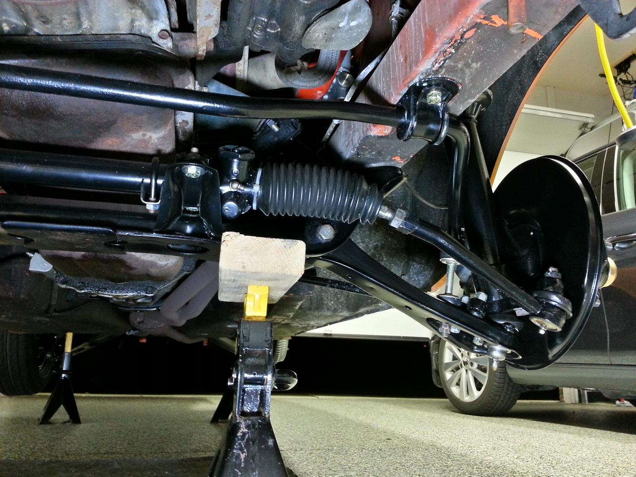

October 7, 201410 yr Author comment_456722 I can't believe it's been 10 months since I updated this thread, but here's an update on where I'm at with the car. Over the winter I reassembled the front suspension and started in on the rear. I took a lot of photos to help me remember how things go together, but most of them aren't very good for showing progress updates... Here's the front suspension going back together and the rear coming apart. I spent the next few months gradually disassembling, cleaning and powdercoating each piece of the rear suspension. Here are a few pretty undramatic disassembly/before pics. Sandblasted rear brake backing plate Before/After of a powdercoated bracket, pretty exciting stuff... I was planning on changing to new springs, so just for fun I experimented with a new powder and did the old springs in a Datsun blue color. At least this way they'll look pretty sitting on my shelf! I'll get some shots of the completed rear suspension and continue my update a little later... Edited October 7, 201410 yr by bacarl Link to comment https://www.classiczcars.com/forums/topic/47001-caretaking-and-progress-updates-for-my-73/?&page=2#findComment-456722 Share on other sites More sharing options...

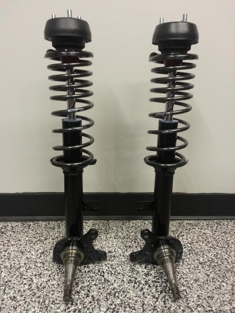

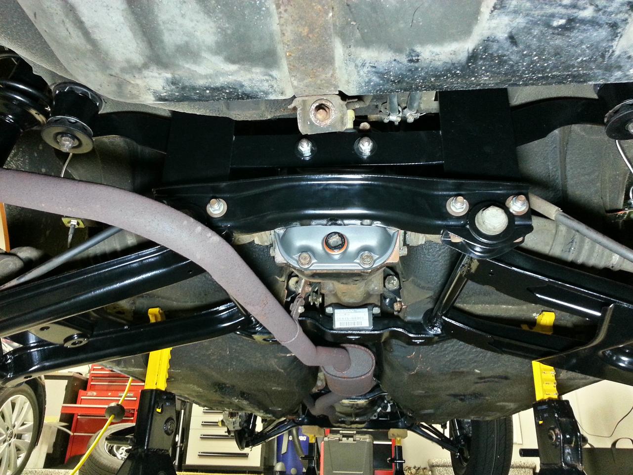

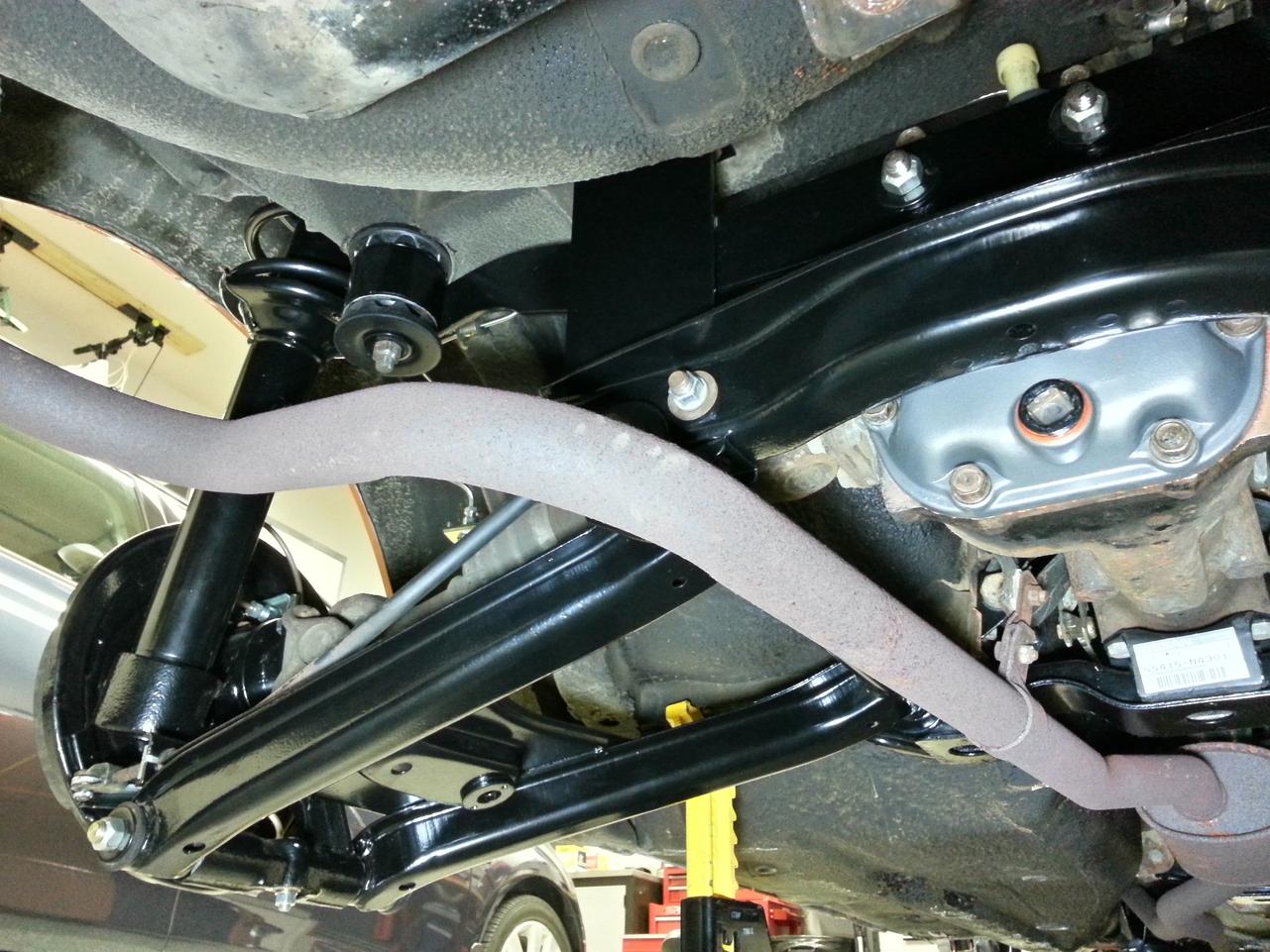

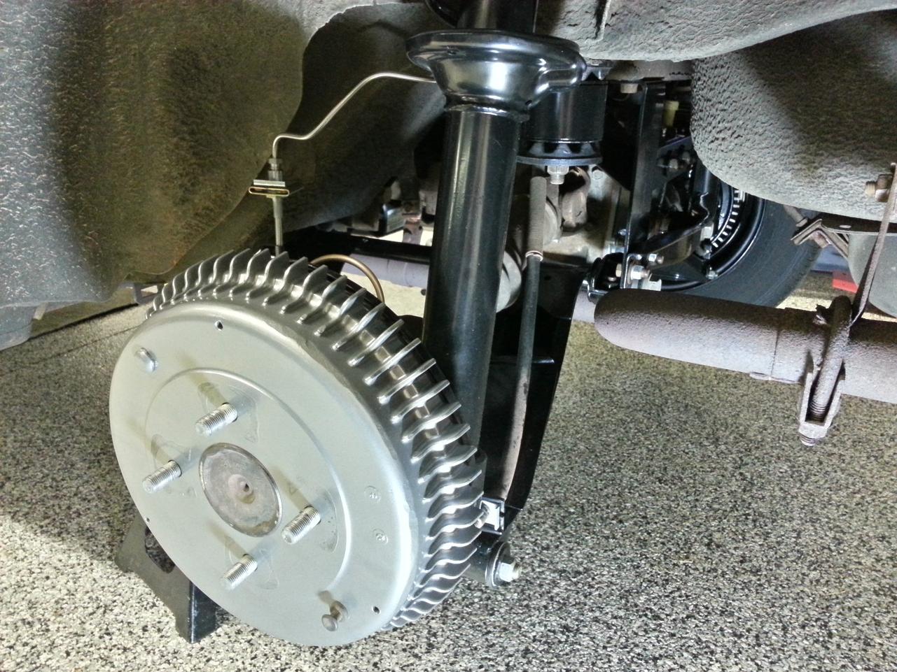

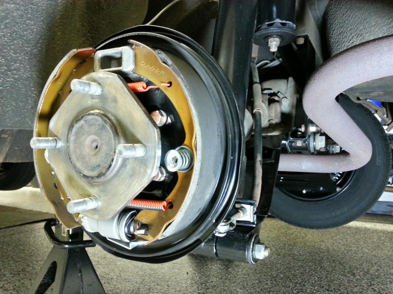

October 8, 201410 yr Author comment_456750 I don't have any good in-progress pics of completed rear suspension parts, or reassembly, but here are some of the final product. Rear corner with refreshed brake drum Rebuilt rear brakes Rear suspension powdercoated and rebuilt. I had to just paint the mustache bar because I retained its original inner bushings. And a couple of the front put back together Link to comment https://www.classiczcars.com/forums/topic/47001-caretaking-and-progress-updates-for-my-73/?&page=2#findComment-456750 Share on other sites More sharing options...

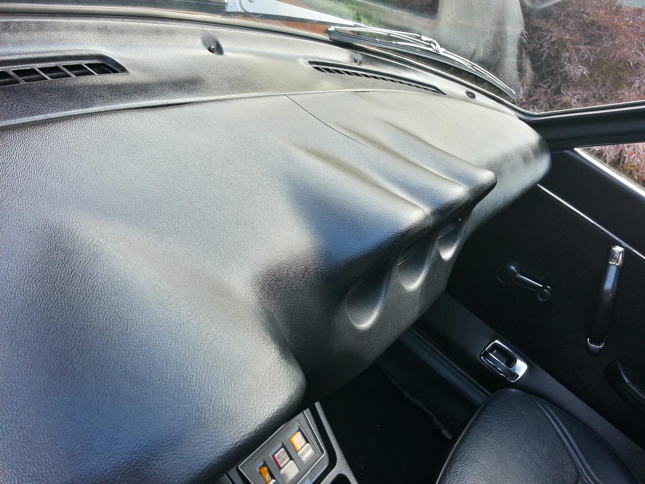

October 8, 201410 yr Author comment_456752 And finally, some shots I took just yesterday of the car all back together and actually running and driving. Here are a couple interior shots to add to the thread. The PO had the steering wheel wrapped in a vinyl cover so I'd assumed the original wheel was worn. I was super excited when I removed the vinyl and saw what good condition the wheel is in. Dash is pretty good with just one small crack So that's that! Unfortunately my next projects are somewhat uncharted territory (for me, anyways): the engine. I think over this winter I'll rebuild the flat tops to see if that helps with driveability before I change over to SUs. Of course I've read a lot about how bad the flat tops are, but as was stated earlier in this thread, they should be adequate if tuned properly, and are an interesting orignal part of my car. I no longer have stalling/hot start issues, or dieseling/run on issues, and all I did was change the fuel filter, fill up with 93 oct, and add a can of Seafoam. They're "sputtery" though, especially on start-up, and the car sure smells rich, so I'm sure some TLC would be appreciated. I'd also like to get the seats re-done this winter. I haven't decided whether I'll tackle that myself or look for an upholstery shop to help me out. Link to comment https://www.classiczcars.com/forums/topic/47001-caretaking-and-progress-updates-for-my-73/?&page=2#findComment-456752 Share on other sites More sharing options...

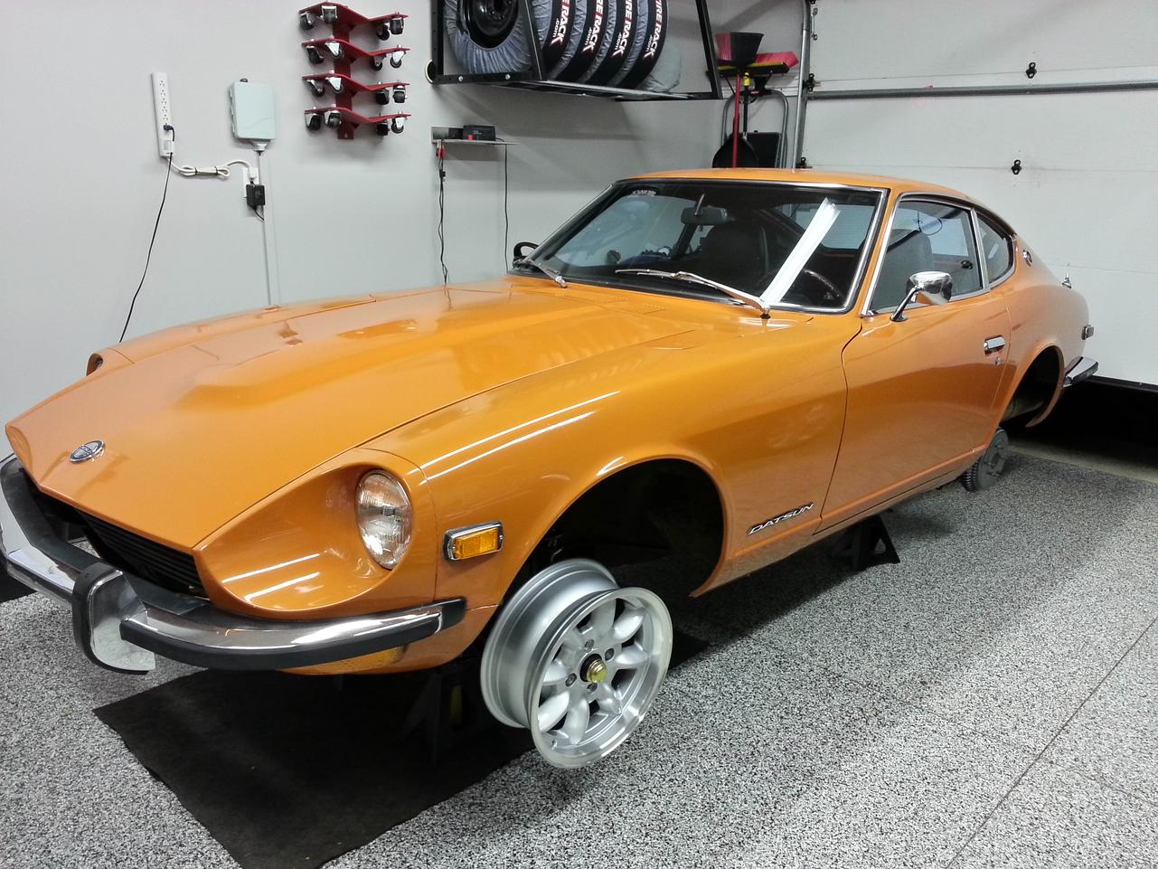

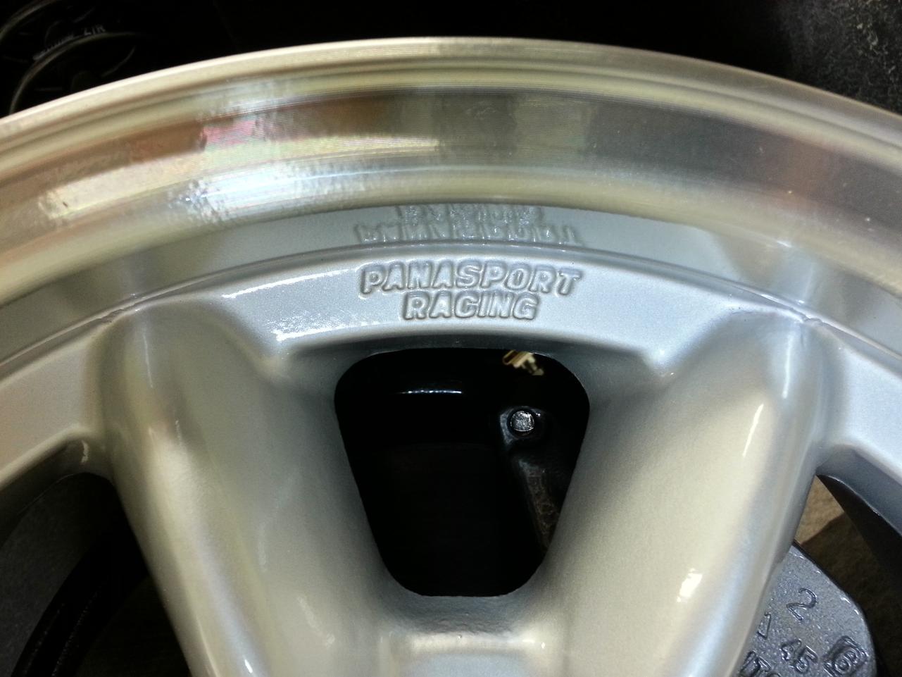

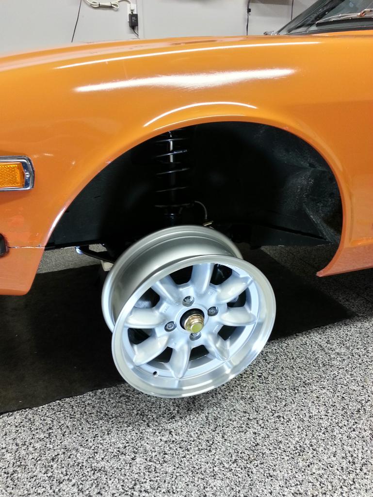

October 8, 201410 yr Author comment_456754 Almost forgot my most recent addition. I love the hubcaps and have no intention of getting rid of them, but I love Panasports on Z's too, like so many others... And since I have two sets of wheels for my other car (granted they're for summer and winter tires) I decided that having two sets for the Z is totally reasonable This is one of my new-to-me, NOS Panasports test fitted on the car. I found them on eBay; the seller had just purchased them from an estate sale and was selling them for $700. They're 15x6 et+10. I would have preferred a 7" width, but I hadn't seen a +10 offset before, which is great because I want to avoid fender rub issues. I don't know how long they've been stored for, but they've never been mounted. My plan is to keep the steel wheels, which are refreshed and powdercoated, for an original look, and get some sticky tires for the Panasports. The trouble is finding a 15" performance tire anywhere close to the stock diameter, so I'll probably have to use a smaller tire. Edited October 8, 201410 yr by bacarl Link to comment https://www.classiczcars.com/forums/topic/47001-caretaking-and-progress-updates-for-my-73/?&page=2#findComment-456754 Share on other sites More sharing options...
