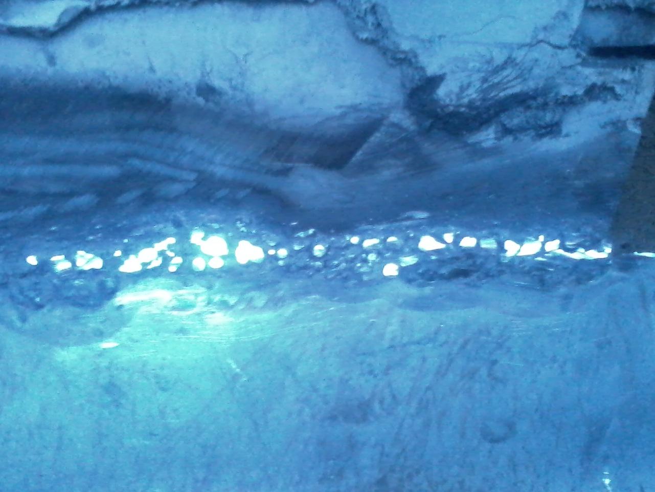

June 13, 201312 yr Author comment_425476 welds look horrible. Can anyone give me some help? I thought I could weld, but..... I am using a miller 115 Cricket XL, flux core wire. .030. I know I am supposed to use thinner, but I can't find flux core wire any thinner, and I don't have a friend with a true MIG I can borrow. Link to comment https://www.classiczcars.com/forums/topic/46675-how-much-to-cut/?&page=3#findComment-425476 Share on other sites More sharing options...
June 13, 201312 yr Author comment_425477 as seen above, I can't get a good bead going, and I can't seem to get even a good puddle. It is just a collection of spot welds. The pic on the right is my 3 different layers over the same seam. There is no cure for idiot, but I am still praying for one. Link to comment https://www.classiczcars.com/forums/topic/46675-how-much-to-cut/?&page=3#findComment-425477 Share on other sites More sharing options...
June 13, 201312 yr comment_425481 What is the duty cycle for the welder you are using at the current setting? If I was trying to figure that out I would try more heat, unless I started to blow holes in it. I had a century 100 and it made welds like that. It had like a 3% duty cycle so by the time you got going you needed to wait for it to cool. If you didn't wait you got welds like that. My buddy caulled them "drunk monkey" welds. I bought a Hobart 210 last year for my xmas present. Night and day. I have always used shield gas. You could get a small bottle fairly cheap. When I weld in patches like this I don't try to make a bead. I make a weld that take 2 seconds or so maybe a 1/4" in diameter to 1/2" long. I have to adjust my speed to make sure I get a "bacon sizzling" sort of sound. I then spot weld every 8-10" apart. Cool things as I go. Then go back by the first spot weld and make another weld right by it. When its all done I grind it down if I have any big holes I MIG them up. If they are just pinholes, after I prime I smear some tiger hair fiberglass over the seam and smooth it down sand it off. It makes the seam water tight. I have the paintucation CD's and that's the way he demonstrates. My problem has benn that on some areas of my car the factory metal is so thin I blow holes in it even at my lowest settings.C Link to comment https://www.classiczcars.com/forums/topic/46675-how-much-to-cut/?&page=3#findComment-425481 Share on other sites More sharing options...

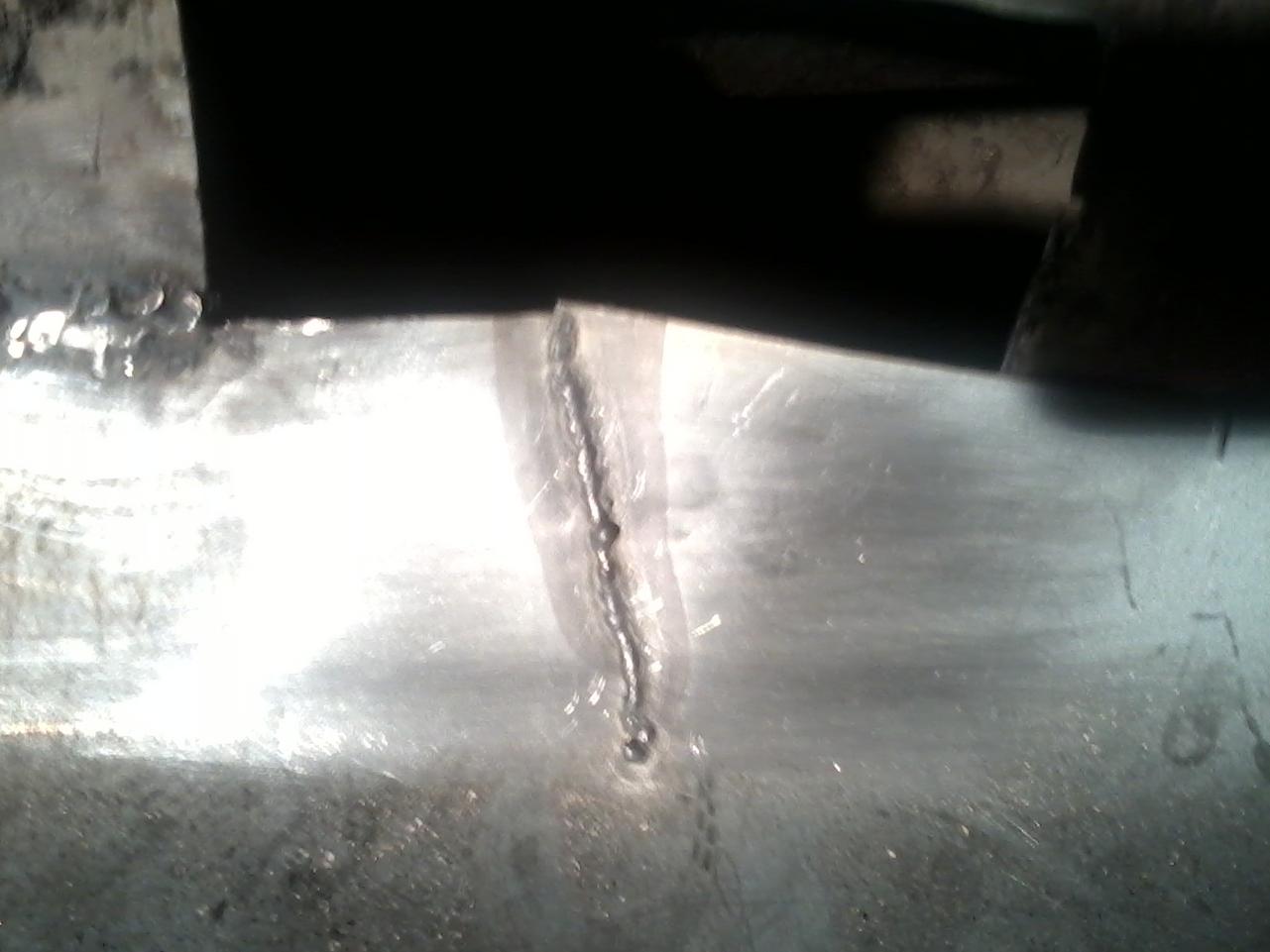

June 13, 201312 yr Author comment_425482 it may be due to lack of good prep for the metal, and the differences b\t the thicknesses. I am adding a pic of a weld I did in a cut I made in the floorpan for easier bending. Look at the difference. The welder I am borrowing doesn't have a capacity for gas. I have no idea as far as cost of adding gas to it, or even how. Link to comment https://www.classiczcars.com/forums/topic/46675-how-much-to-cut/?&page=3#findComment-425482 Share on other sites More sharing options...
June 13, 201312 yr comment_425490 It could be the prep is an issue. They don't like rusty metal. I have a 2" 90d air grinder that I run down both side of the metal quickly to expose clean metal. I don't ever wiper my work down, that me be a character flaw. I don't really know what is the best product to wipe it down with and then huff as I burn it and I also have had no issues as long as the metal is shiny. That weld looks a lot better than the others and the metal had some heat in it to discolor like that. Did you start at the bottom and work up? It looks hotter at the top. They still look a little "ropey" I like to see my welds lay down a little smoother on the sides. Some times it my wire speed sometimes its my heat. I know that if the welder you are using has no gas option you are going to be frustrated. I couldn't believe how much easier it is to weld with a better and larger machine.C Link to comment https://www.classiczcars.com/forums/topic/46675-how-much-to-cut/?&page=3#findComment-425490 Share on other sites More sharing options...
June 13, 201312 yr Author comment_425491 I did start at the bottom, yes. I am calling around for a gas welder to borrow, I am going to take the rest of the night off, and get back to it tomorrow. Gonna take the pan completely out, grind the hell out of the pan and car, and get back to it. I am hoping for better. Link to comment https://www.classiczcars.com/forums/topic/46675-how-much-to-cut/?&page=3#findComment-425491 Share on other sites More sharing options...
