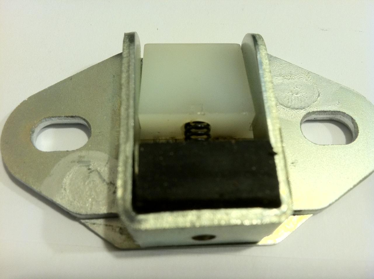

July 25, 201312 yr Author comment_428483 Another item reproduced, its the rear hatch stopper rubber insulator. This one was milled out of Delrin and cast into a 2 piece mold. This is the correct replacement for your old worn out rubber. It even has the two little side parts that are on the original ones. The new ones come in a cream color and these are the correct black color. These are not hand cut or drilled, these are from a two part mold just like all the other insulators. Sorry just the rubber not the metal stopper. Link to comment https://www.classiczcars.com/forums/topic/46317-240z-fuel-and-brake-line-insulator-sets-and-steering-rack-expansion-reservoir/#findComment-428483 Share on other sites More sharing options...
