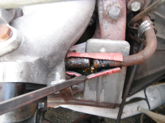

Got some rubber caps to temporarily plug the pipes, pulled the short hose off the lower thermostat housing. Now, my coolant is new and green, but what came out was a few drops of brownish corrosion. The 1/2" hose barb was corroded. Pulled the other end of the hose off at the intake manifold. That hose barb was totally plugged with some grey-green gunk. Looks like no water flowed through there for a long time. I'm guessing the gunk is stop leak put in by the PO (flushed the engine three times when I got the car a few years ago, to get rid of the gunk) , plus coolant residue and rust.

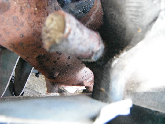

Then I cut the short rubber hose that connects the rear of the intake manifold to the steel water tube that runs around the back of the motor. Plenty of corrosion there also, and some green coolant.

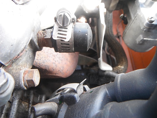

Anyway, plugged the lower thermostat outlet with some caps from pep boys. The 1/2" cap fit it but looked flimsy so I put a 5/8" cap over it. Also capped the pipe that goes behind the motor. Have a hose and some BSPT stuff on order - at least it's not leaking and I can drive it for now. Also put a restrictor on the heater loop (a hose clamp with a piece cut from radiator hose to cushion it) that should cut down the recycled hot coolant by about half. Later I'll put the "real" restrictor - a washer.
Here's a few corrosion shots...
