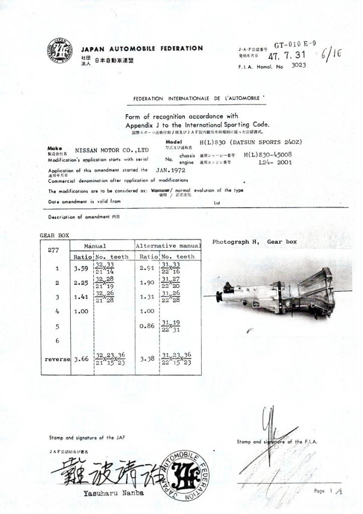

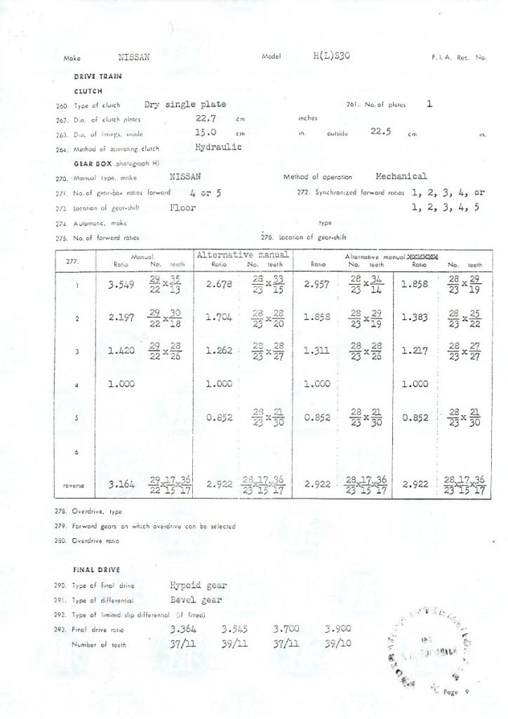

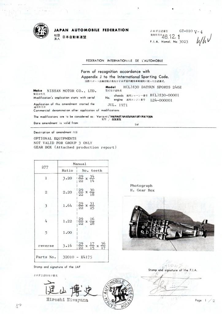

I assume that we have 1969 Nissan's F4W71A, first from left in table on page 9, and following 1970 Nissan's FS5C71A, plus two racing sets - right ?
Then Amdt-p2 shows Nissan's F4W71B and FS5C71B both from Sep.1971 - right ?
And what do we see on Amdt-p1 ?
PS
I try to determine the date of manufacture, not FIA approved
thanks again HS30-H
From the left:
F4W71A ( fitted to HLS30 / S30-S from Oct. 1969 )
FS5C71A ( fitted to H(L)S30 / S30 / PS30 / PS30-SB from Oct. 1969 )
Then in the middle, the July 1971 amendment with the optional 'Direct-Drive' version of the 71A ( 1:1 fifth gear, 'Dogleg' / 'Low Back' shift pattern ), which was never available as showroom stock equipment on an S30-series Z, but certainly was available as a 'Sports Option' part before the end of 1970.
Then on the right the January 1972 amendment with the F4W71B ( fitted to HLS30 / S30-S from October 1971 ) and FS5C71B ( H(L)S30 / S30-S / PS30 from October 1971? )
There were several optional gearsets available for the F5C71B ( 1:1 'Direct Drive' / Dogleg 5-speed ) and FS5C71B ( Overdrive 5-speed ).

I'd like to ask about this competition transmission, tho one with 1:1 fifth gear, does it have some sort of signature ?
Or maybe it's just another ratios set for FS5C71A or B, or both ?
I dont see anything about this in FIA approval.
