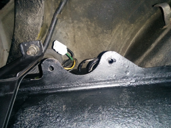

August 4, 20178 yr comment_527342 I think the black wire of the green / black pair at the tank is ground. I had my tank out to clean and line it and the way Datsun has the tank situated I think it's pretty much electrically isolated from the car frame/body ground. Not really any metal to metal between the gas tank and the rest of the car. So if the tabs I mentioned before on the tank are for an electric fuel pump to be mounted there it needs to have a ground wire for the pump. Same reason there's a ground wire for the fuel gauge sending unit in the tank. Link to comment https://www.classiczcars.com/forums/topic/45486-240z-electric-fuel-pump-installation/?&page=5#findComment-527342 Share on other sites More sharing options...
August 5, 20178 yr comment_527424 Yes black at the tank is ground. I verifed with continuity meter. Interesting note in the  airtex video was to include a ground for the fuel pump to the battery. Link to comment https://www.classiczcars.com/forums/topic/45486-240z-electric-fuel-pump-installation/?&page=5#findComment-527424 Share on other sites More sharing options...

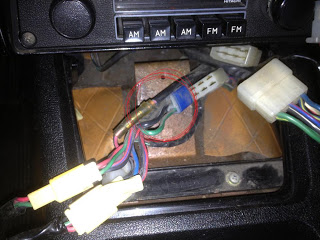

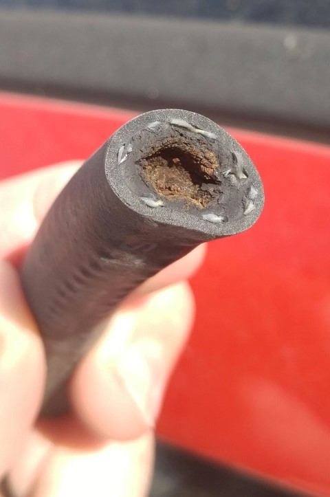

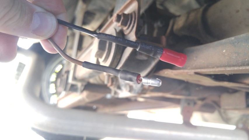

August 6, 20177 yr comment_527488 I metered it yesterday, picked up a couple bullet connectors, hooked it all up. No switch currently at the inside harness... Just jumpered them. I did find, however, maybe it wasn't just the fuel pump. I saw the lower section of hose below the filter looked twisted or collapsed. It was actually squishy and sticky. Clogged up and rubber deteriorating. Gad zooks!!! Replaced. Car started right up. So maybe it would've run without the electric pump. But all set now  Trying to post a couple photos but not working right now. Edited August 6, 20177 yr by thumper300zx Link to comment https://www.classiczcars.com/forums/topic/45486-240z-electric-fuel-pump-installation/?&page=5#findComment-527488 Share on other sites More sharing options...

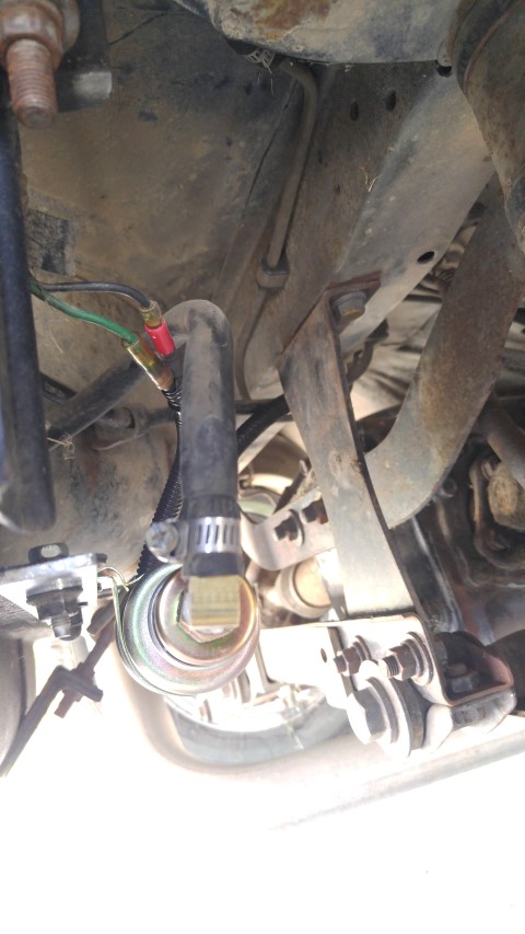

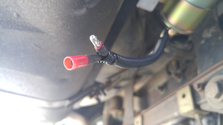

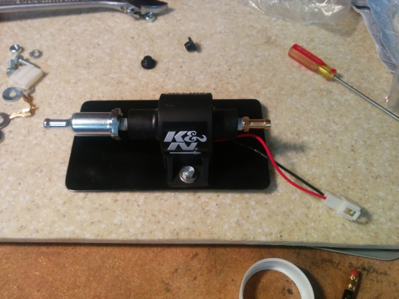

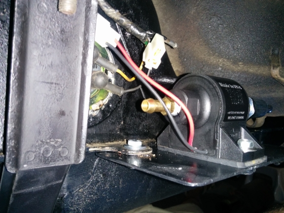

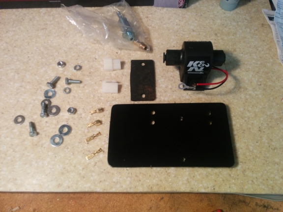

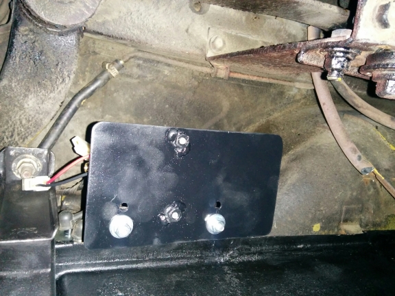

August 8, 20177 yr comment_527543 Got my tank back in the car for the 2nd time... Accidently buried the wires between the tank and the body on the 1st attempt and had to lower the tank to get my wires out. Now for the pump install. Here's the legend and the pics; Pic1Â - Here's all my parts for mounting the pump to the tabs on the tank. New wire connectors, rubber pad to put between plate and pump, nuts & bolts, etc. My Buddy Dangerous Dan fab'd my mounting plate. Pic2Â - Pump, filter and nipple on mounting plate with new electrical connector. Pic3Â - Tabs on tank & new electrical connector Pic4Â - Plate w/pump mounted to tank - note rubber between pump and plate, hopefully that will keep it pretty quiet Pic7Â - View of pump on plate looking straight up from ground - I think the pump is well enough protected Now I'll do the jumper in the console. Edited August 23, 20177 yr by w3wilkes Couple of corrections Link to comment https://www.classiczcars.com/forums/topic/45486-240z-electric-fuel-pump-installation/?&page=5#findComment-527543 Share on other sites More sharing options...
August 9, 20177 yr comment_527622 Eureka! I looked and looked for the connector in the location referred to in this image and couldn't find it in my series 1 (12/70) 240Z. I finally found it. There's a wire bundle right in front of the console in the passenger foot well that has a naugahyde snap together boot around it. The blue taped connector for the fuel pump wires was in that bundle of wires. Link to comment https://www.classiczcars.com/forums/topic/45486-240z-electric-fuel-pump-installation/?&page=5#findComment-527622 Share on other sites More sharing options...

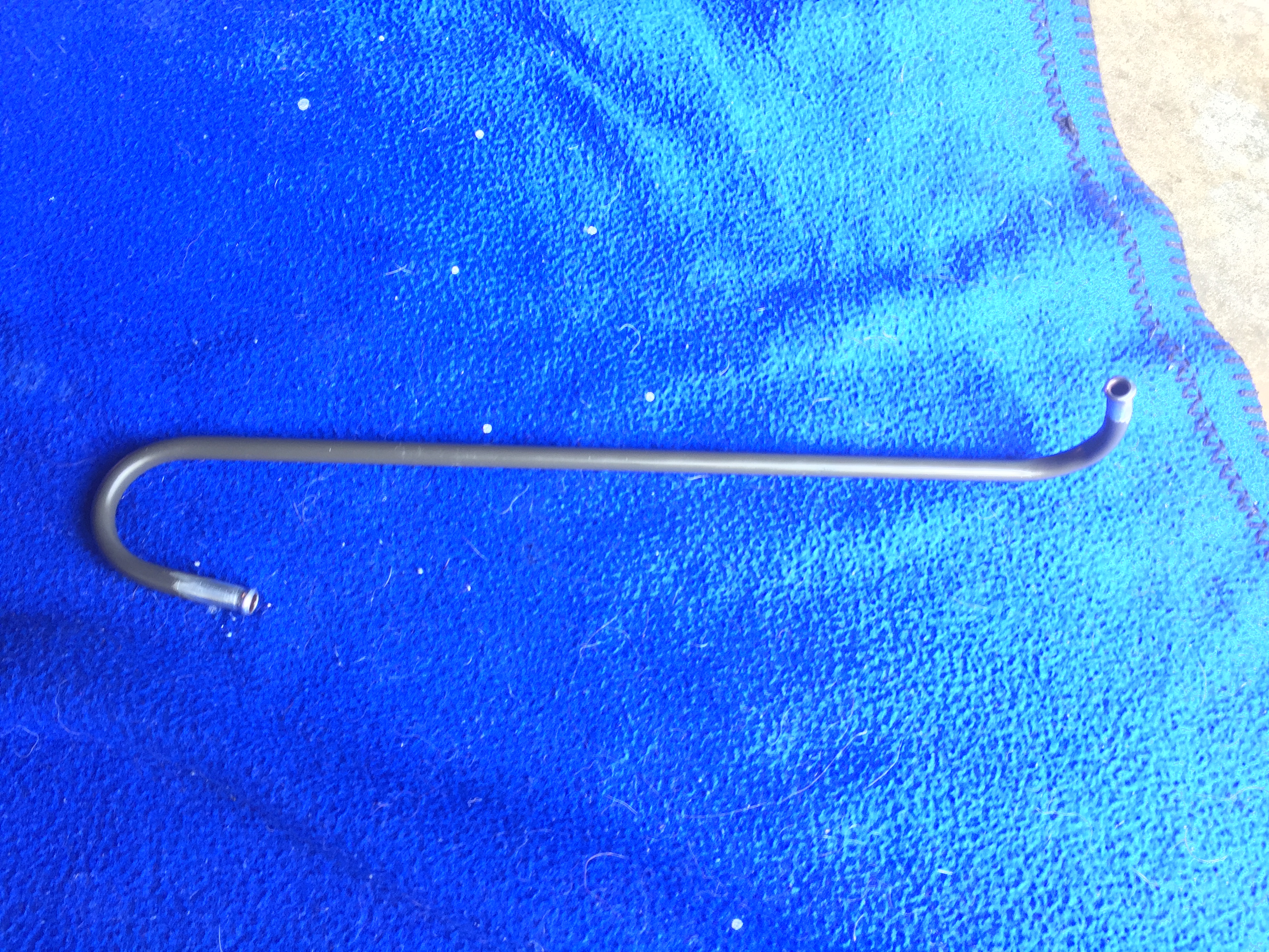

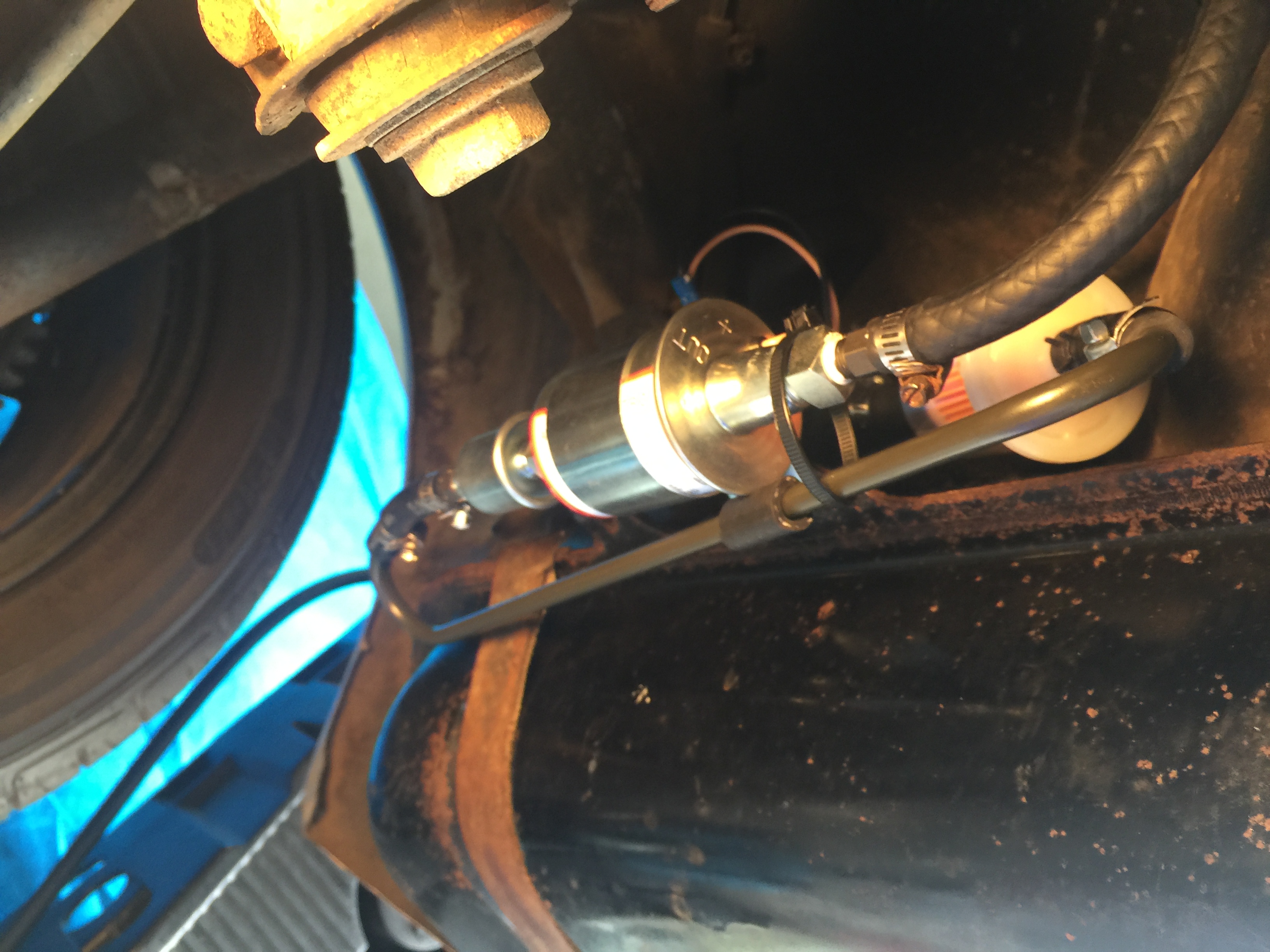

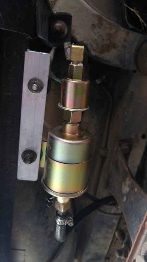

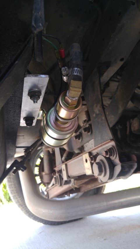

August 12, 20177 yr comment_527809 I finally finished mine up. I had mine mounted with all this hose running in a big loop and didn't like it. I made small metal gas line and eliminated all the extra line hanging. Tucked so much better.  Return line is flowing great too. It was plugged about 3 feet in the engine bay. I must say my car does run considerably better. I think my old mechanical pump was dying.  Link to comment https://www.classiczcars.com/forums/topic/45486-240z-electric-fuel-pump-installation/?&page=5#findComment-527809 Share on other sites More sharing options...
August 13, 20177 yr comment_527846 So you're running 2 fuel filters before the pump? Link to comment https://www.classiczcars.com/forums/topic/45486-240z-electric-fuel-pump-installation/?&page=5#findComment-527846 Share on other sites More sharing options...
August 13, 20177 yr comment_527880 10 hours ago, w3wilkes said: So you're running 2 fuel filters before the pump? Yes for the time being and I have a third one right before the rail too. I had some rust I wanted to make sure I got out. Link to comment https://www.classiczcars.com/forums/topic/45486-240z-electric-fuel-pump-installation/?&page=5#findComment-527880 Share on other sites More sharing options...
August 14, 20177 yr comment_527957 On 8/6/2017 at 11:13 AM, thumper300zx said: I metered it yesterday, picked up a couple bullet connectors, hooked it all up. No switch currently at the inside harness... Just jumpered them. I did find, however, maybe it wasn't just the fuel pump. I saw the lower section of hose below the filter looked twisted or collapsed. It was actually squishy and sticky. Clogged up and rubber deteriorating. Gad zooks!!! Replaced. Car started right up. So maybe it would've run without the electric pump. But all set now  Trying to post a couple photos but not working right now. Trying photos from PC instead of phone... Good, it worked -- also -- it makes quite a bit of noise where it's mounted. Kind of annoying. I might move the location. Anyone else's loud? Might just be because it's mounted to the tank tabs and it's a big hollow tank (less than 1/4 tank full).  Edited August 14, 20177 yr by thumper300zx Link to comment https://www.classiczcars.com/forums/topic/45486-240z-electric-fuel-pump-installation/?&page=5#findComment-527957 Share on other sites More sharing options...
August 15, 20177 yr comment_527980 Mine was only loud until it primed. Then I can hear it hum some, but once running I hear nothing. What is that clogged line from? Edited August 15, 20177 yr by JSM Link to comment https://www.classiczcars.com/forums/topic/45486-240z-electric-fuel-pump-installation/?&page=5#findComment-527980 Share on other sites More sharing options...
