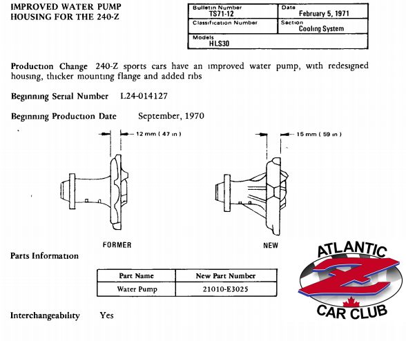

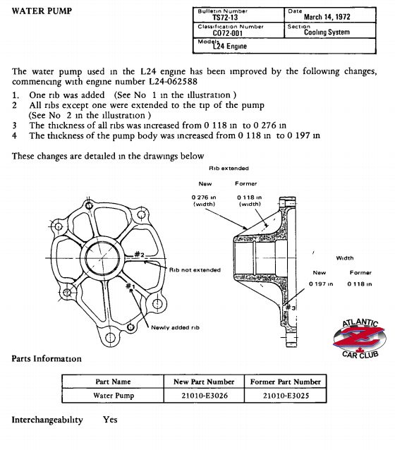

Water Pump

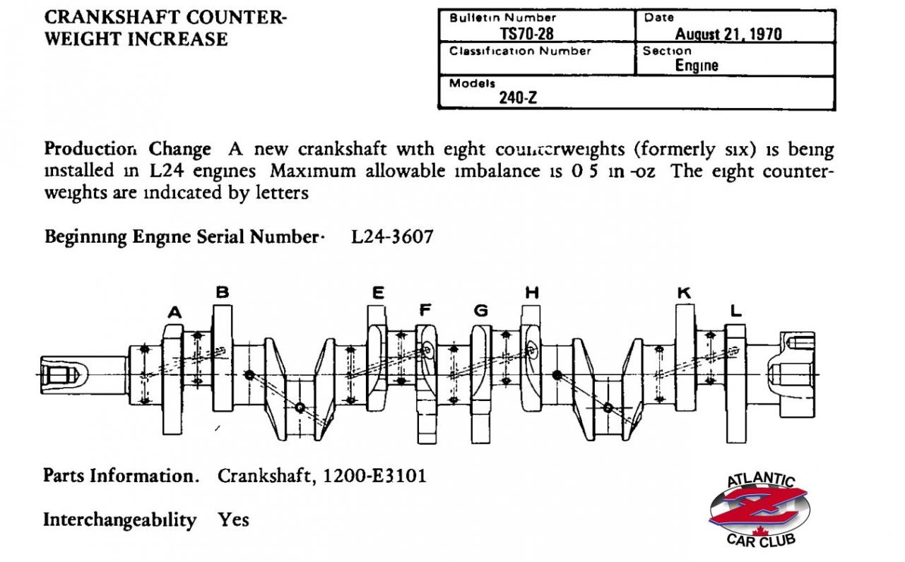

Crank Shaft

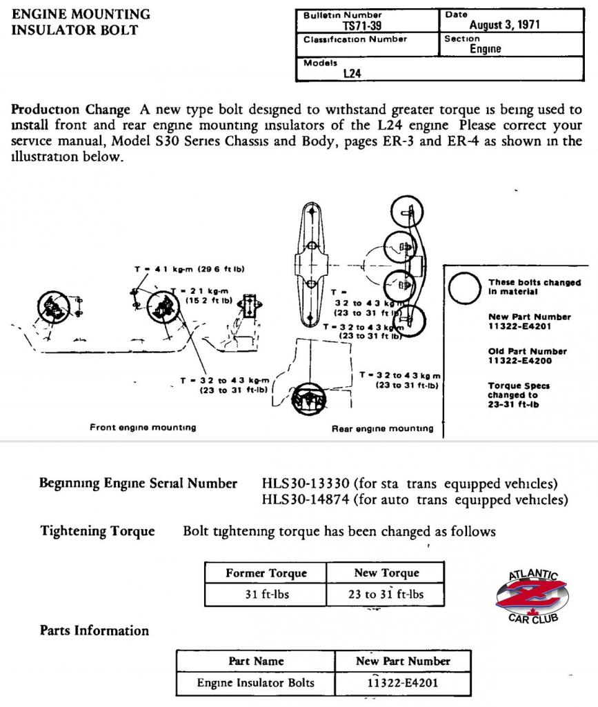

Engine Transmission Mount Bolts

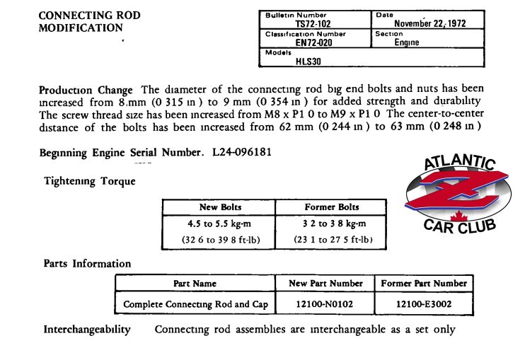

9mm Rod Bolts

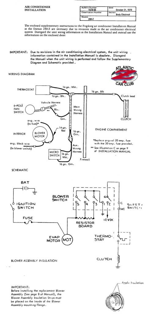

AC Installation
