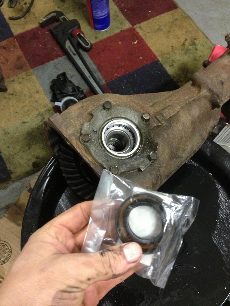

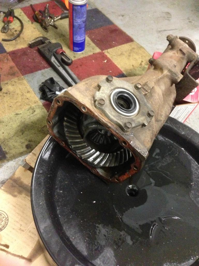

Documentation obtained with the car indicated it had a 4.11 R180 differential installed. We replaced the U-Joints in the stock Half-Shafts, and pulled apart the differential today, only to find out it has 3.545 gearing. It also has a large "K" stamped on the top, which I understand is from the 84-88 200SX.
So, someone has replaced the stock R180 with a later replacement R180, geared identically. I understand there's some work involved to get this to bolt up with stock halfshafts, so someone spent some time here.

I apologize for the poor photos; they're all I have on my phone at the moment. More at home.
3:54 R180s were stock in an automatic 240Z. Maybe the PO converted an automatic car to a manual. Doesn't really matter. You have what you have and it will be far more important from a performance standpoint to install a LSD then to try and source a 4:11 ring and pinion.
