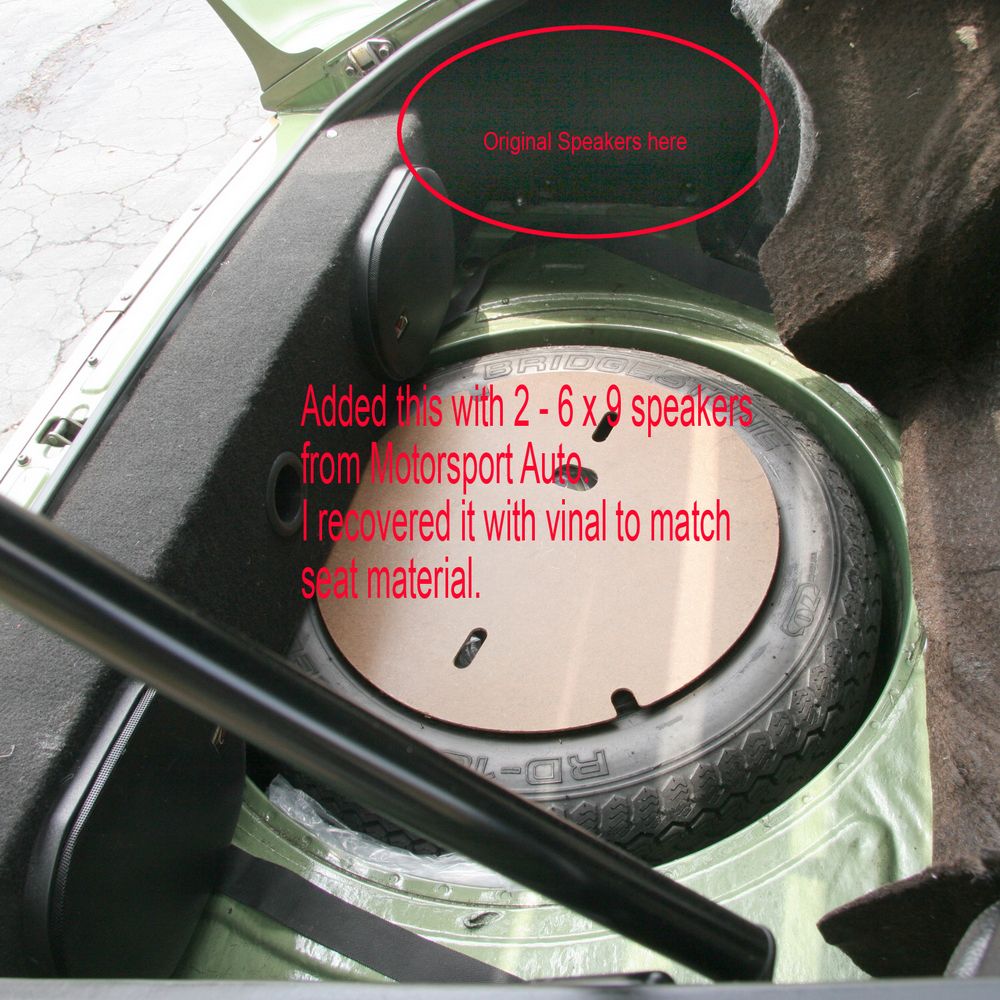

Here is what I did. Speaker Panel The covering you see is the original, it now is black vinyl. I also kept the original radio and put a new one with CD in the glove compartment. Original radio to original speakers and new to new 6x9's. If you do this you will have to Y the antenna lead to both radios.
