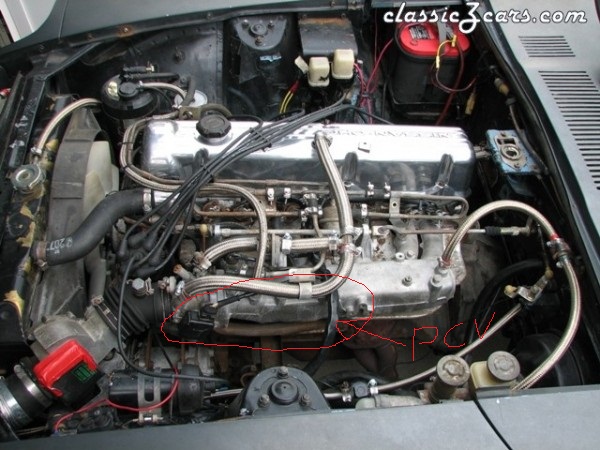

I bought a new PCV valve for my 280ZX from Rock Auto. Standard kinda PCV, threaded on one end, hose barb on the other.
Only problem is I can't find any place to put it on my engine. The PCV hose from the valve cover to the intake manifold, well, it apparently doesn't thread into either end!
I can't find any place for it except my glove box!
Is the PCV integrated into the 90 degree elbow going into the valve cover? Did Rock send me the Rong part?
Don't forget the hose end goes to a hose that connects to the pipe coming out of your block up front on the driver's side. You must have been driving that ZX Fred Flintstone style.
