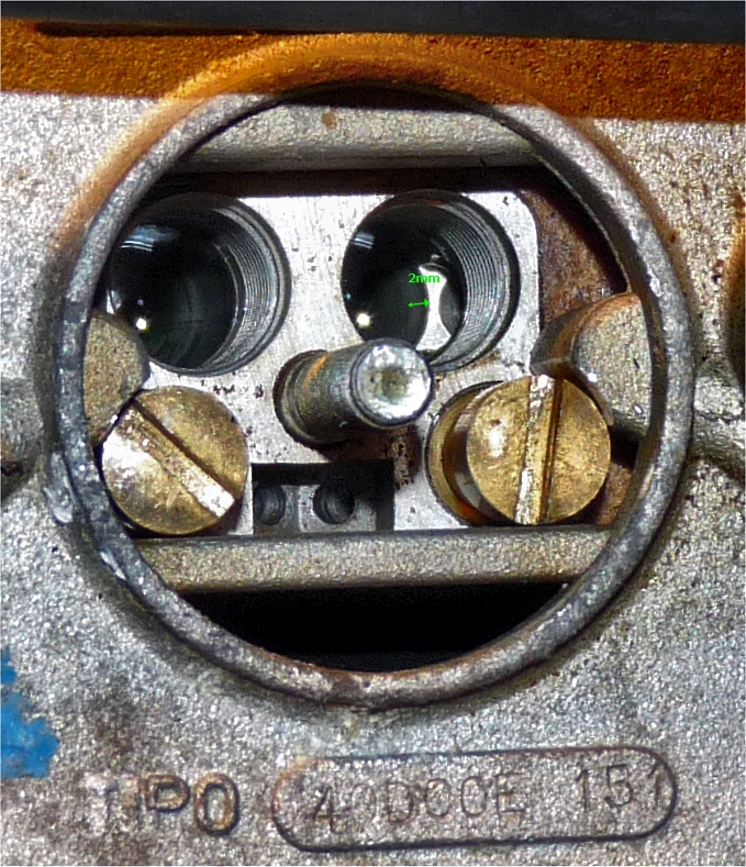

Photo of correct fuel level in the main jet well of a DCOE 40 151 carb.
You can see the faint fuel level ~ 25mm down from the top of the well.
You can also see the exit port to the main venturi nozzle 23mm down.
