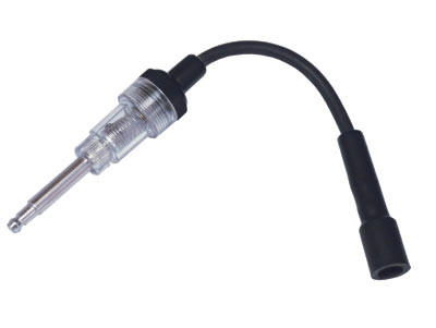

After my 2nd or 3rd "electrocution" by a GM HEI ignition (40,000+ Volts) I broke down and bought a spark tester. Those brain cells are never coming back.
