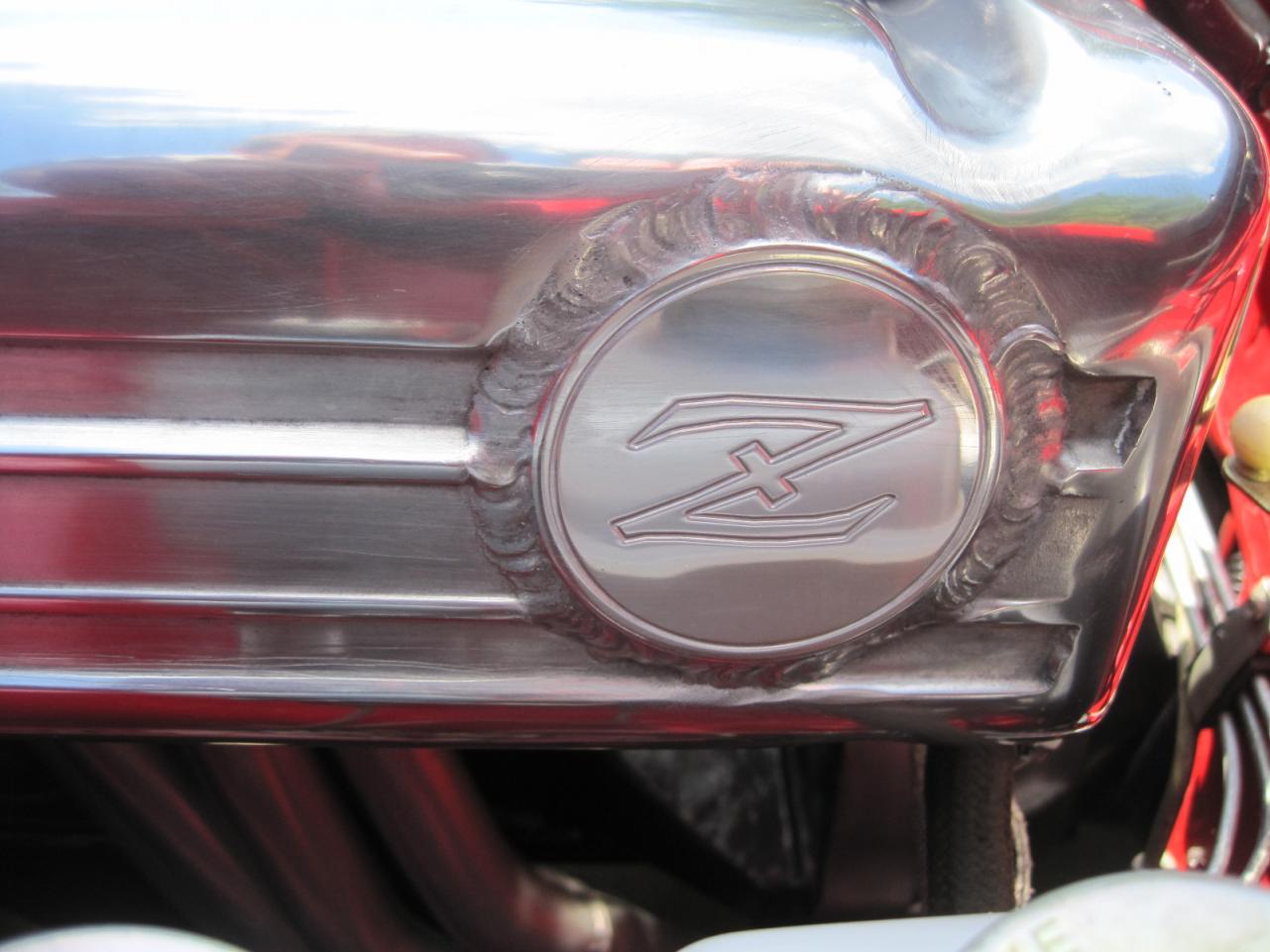

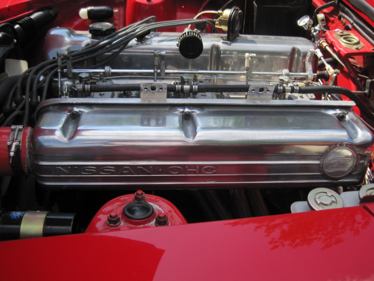

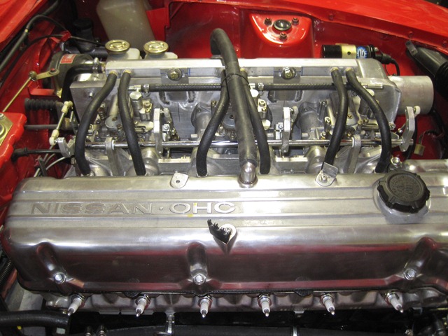

June 19, 201212 yr Author comment_393492 Put a little shine to things today Link to comment https://www.classiczcars.com/forums/topic/42960-triple-mikuni-thread/?&page=4#findComment-393492 Share on other sites More sharing options...

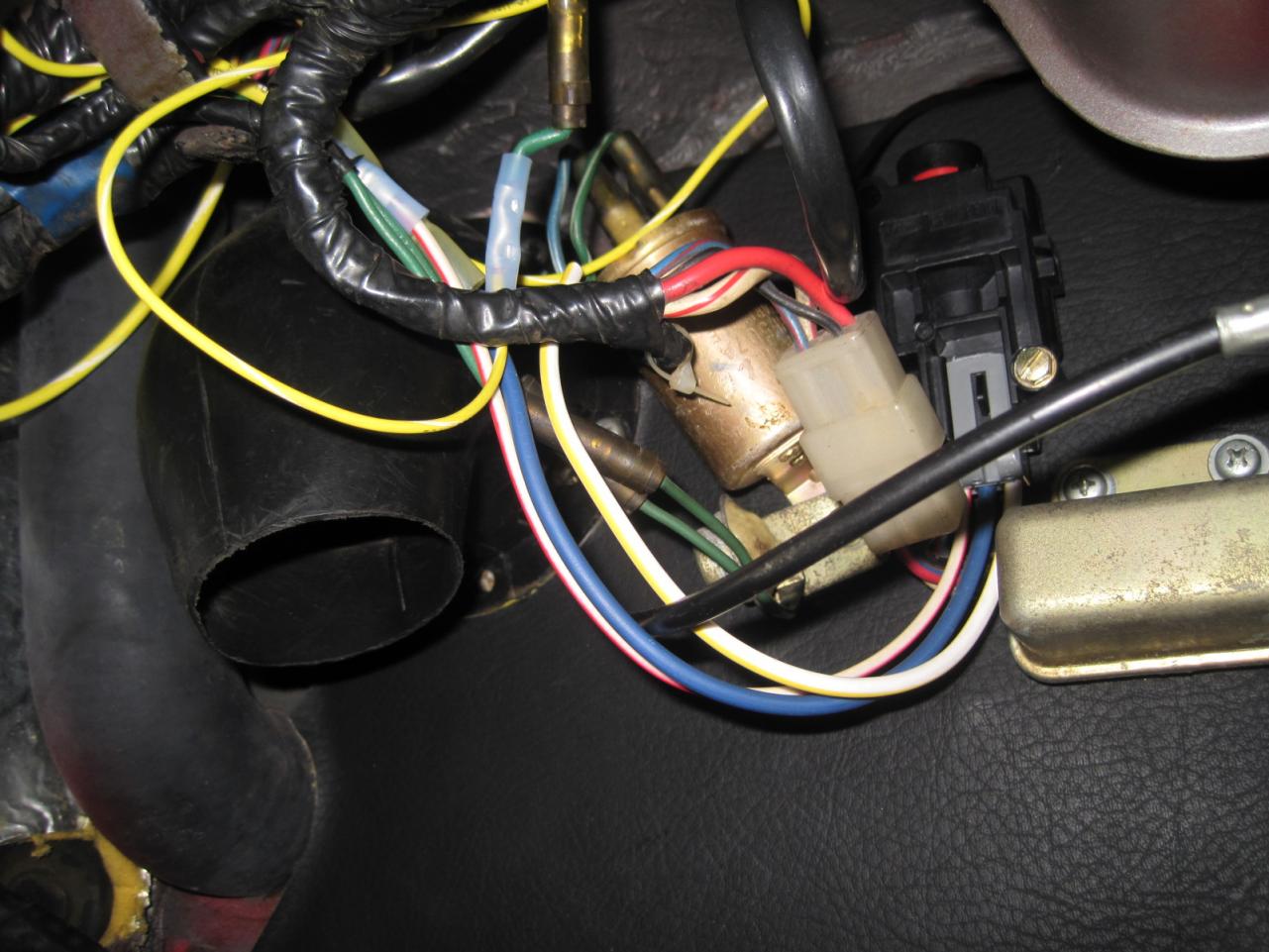

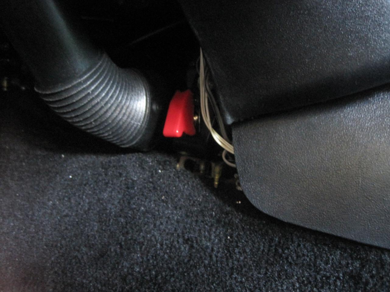

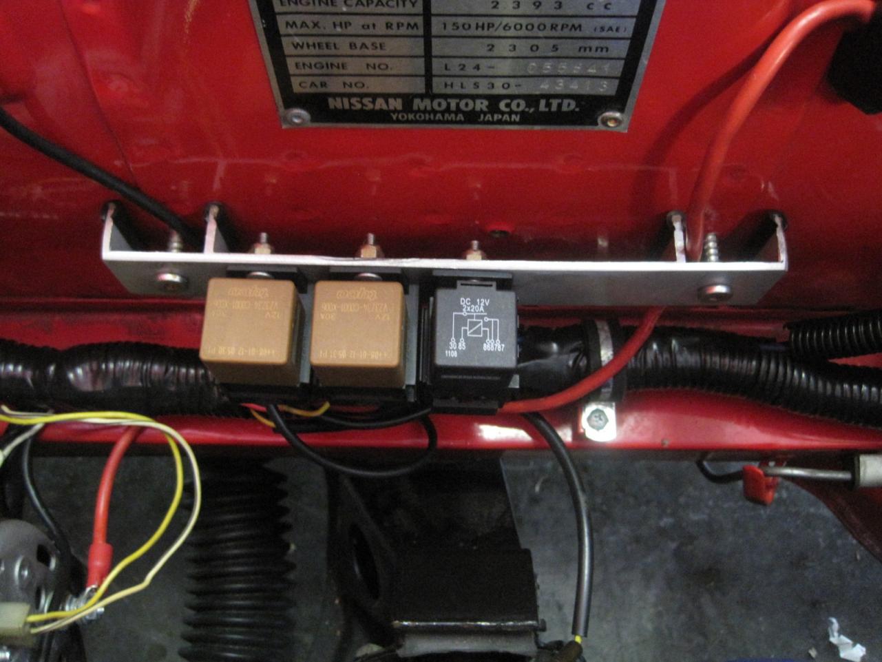

June 20, 201212 yr Author comment_393555 There's probably many ways to wire this, it depends on what you want in the circuit. I wanted a ; on/off switch accessable enertia switch incase of the worst scenerio fuel pump relay fuse I found the black/white stripe and green wire plug behind the heater panel. My car is a 9/71 and was wired for a pump, but didn't use one. This plug was used to tie in a loop circuit that would have a fused link before it went to the pump. I decided to cut off the plug end before it got to the loop and put in a on/off switch. Lot's of advantages here-emergency cut-off, maintenance cut-off, fuel smell deterent. Just the other day I was troubleshooting my blinkers, which requires key-on, I just switched off my pump during the process. Next I found the green power wire above the passenger side kick panel so I can wire in a fuel pump relay and inertia switch. Both items can be found at Summitt or Jegs-I chose a a generic fuel pump relay. I wanted to tie everything in right there at the kick panel. The inertia switch comes with three wires; Normal open normal close ground I tied the power wire coming from the relay to the normal/closed wire on the inertia, and then connected the ground wire on the enertia switch to the green wire going to the back of the car to the pump. The enertia switches are only 25$, and it is a nice safety feature. The relay got mounted next to my headlight relays tied into my fuse block. Link to comment https://www.classiczcars.com/forums/topic/42960-triple-mikuni-thread/?&page=4#findComment-393555 Share on other sites More sharing options...
