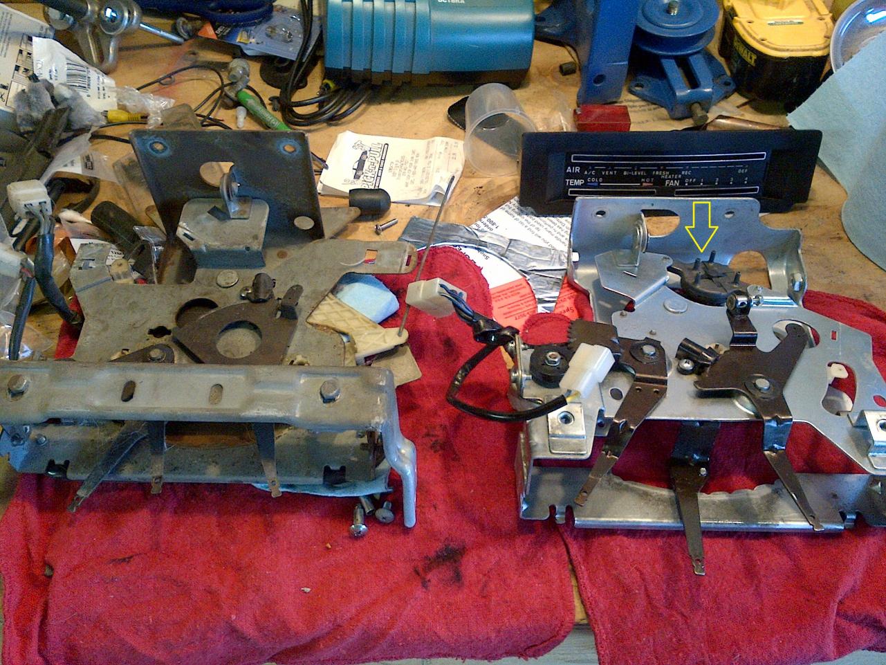

May 4, 201213 yr Author comment_389086 Okay, I got this thing fixed. None of my vacuum lines were cracked or off their barbs, all the HVAC door motors were working, hot/cold cable adjusted properly and so on. That only left one thing. The control head.The way it works is it has two disks that rotate relative to each other. The bottom one has 8 hose nipples on it. The top one is toothed, like a gear. Apparently the upper disk has a variety of passageways in it, and rotating the selector knob lines them up with various nipples on the bottom disk. Don't ask me how it got that way (It seems virtually impossible) but the disks were mis-aligned. I put the selector on VENT, where air was blowing out the vents I wanted for AC, pryed the toothed lever up so it wouldn't rotate the top disk, and rotated the selector lever to the coldest (furthest left) AC position and set it back down. I then tried it in all the other positions, and air came out the right vents, including defrost. I simply cannot imagine how this disk got mis-rotated, but it did. Someone installed a new control head and didn't line it up?It wasn't from hitting a pothole, it took considerable effort to pry the lever up above the top disk. Now, here are TWO things I realized that will HELP you diagnose YOUR system when the air comes out the wrong vents.When the selector is on VENT, ALL of the vacuum ports should be connected to vacuum. Every vacuum motor should be actuating. When the selector is on RECIRC (far right, past defrost) NONE of the vacuum ports should have vacuum.I still have ONE issue, which is the AC quits coming out the right vents when I floor it and lose vacuum. My guess is I'm missing a one-way valve up at the vacuum reservoir, or else it's stuck open. Alternately, a small but continuous vacuum leak somewhere could cause the reservoir to be depleted. This one should be easy to fix, can use a smoke machine if necessary. HTH Link to comment https://www.classiczcars.com/forums/topic/42925-air-blowing-out-wrong-vents/#findComment-389086 Share on other sites More sharing options...
May 4, 201213 yr comment_389118 Is this the disk thing your talking about? I put the yellow arrow over it Link to comment https://www.classiczcars.com/forums/topic/42925-air-blowing-out-wrong-vents/#findComment-389118 Share on other sites More sharing options...
May 19, 201212 yr Author comment_390508 Yes. That's it viewed from the bottom, seeing the barbs the hoses go on. Mine had more barbs, is that perhaps one for the automatic climate control? Link to comment https://www.classiczcars.com/forums/topic/42925-air-blowing-out-wrong-vents/#findComment-390508 Share on other sites More sharing options...
