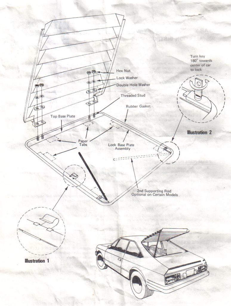

March 30, 201213 yr comment_385725 These are the instructions that came with mine in 1980. I think SBlake has a photo of the key. Bonzi Lon Link to comment https://www.classiczcars.com/forums/topic/42785-interpart-louvers-install/#findComment-385725 Share on other sites More sharing options...
