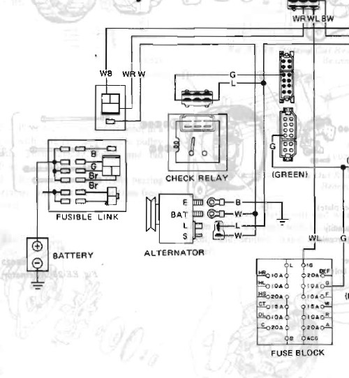

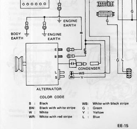

March 21, 201213 yr comment_384824 Glad you got it fixed. Not sure what your comments mean though, since all of the internally regulated alternators from 78 to 83 are wired the same way, and the FSM diagram is correct I believe. Just posting, with pictures, for any future alt swappers. The top of the T is S and up and down part is L. Of course, in the FSM drawings, the T is upside down, maybe that's the issue. I copied two, from 78 and 79, just to show what I mean. Link to comment https://www.classiczcars.com/forums/topic/42413-still-no-charge-from-alt/?&page=2#findComment-384824 Share on other sites More sharing options...
