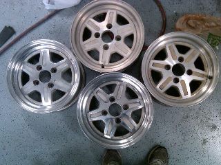

Bought some 280zx wheels. Been working on a couple of them. Not an expert by any means. post-21670-14150817856639_thumb.jpg 2 are buffed 2 are not. I used an air angle grinder with a blue roloc disk to remove most of the aluminum ridges on the spokes, then just went at it with some buffs and rouge.
I have the same ZX set of wheels on my 72 Z, they look fantaztic when polished and blend nice with the Z sexy lines.
I cleaned and polished a set just like these for my 280z. Used stainless wool and then used a corded drill with a powerball and metal polish. Then I painted the inserts. They came out pretty good.
