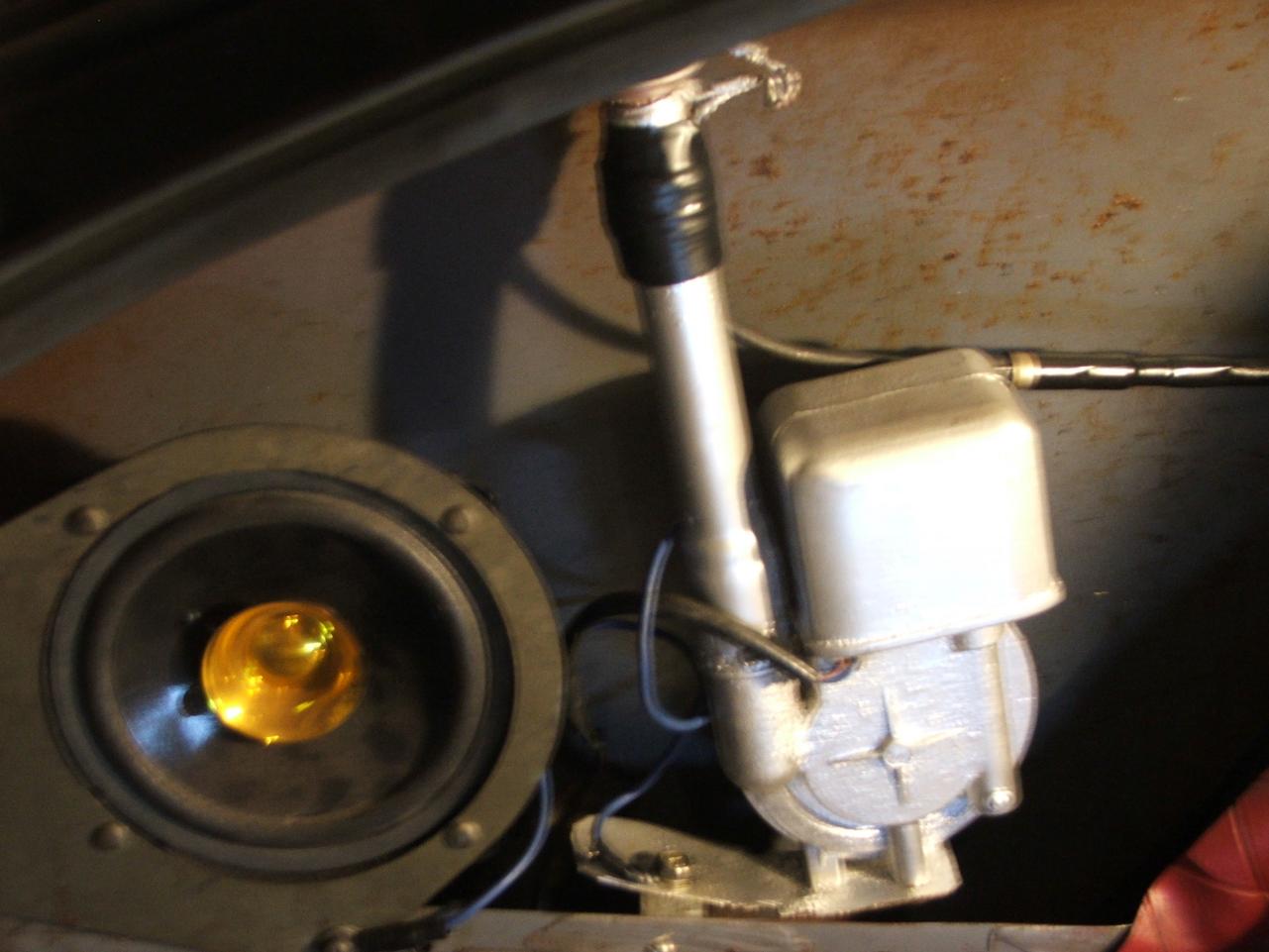

On my '73, in putting my left rear side lamp (running lamp) back on, I noticed 2 extra wires in the same area. One is white and the other is white with a black stripe. I can't remember which was male and female, but does anyone know what they were provisioned for? I was not able to see anything on the wiring diagram, but the wires are definitely part of the original harness.

Radio speaker. + = W/B
Look near the fuse box on the wiring diagram and you'll see them.
FWIW
E
Or an electric antenna. The speaker goes on the passenger side if memory serves.
On my 73, the speaker & antenna are on the driver's (left) side.
Bonzi Lon
2 wires for marker light and 2 for antenna 1 for speaker because the second terminal goes to ground.
