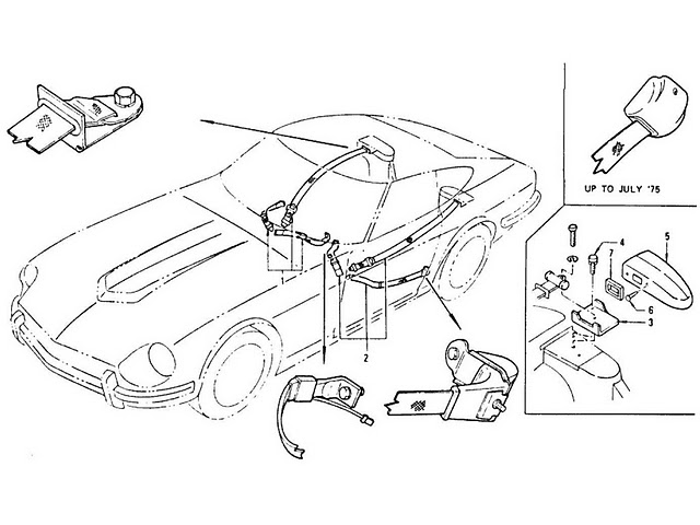

I want to fit some US 280z safety Belts to a UK car.
It looks like on a US car,they fit into a recess in the rear panel behind the two sweater seats.
Does anyone have a photo of this please?

Is it a must to have seatbelts from an actual Z car? I've had excellent results with aftermarket seatbelts. I take it that you have a 2+2. The seatbelts are different between the coupe & 2+2.
Hi
It's the belts in the lower picture that I have, they seem like they will pick-up on the b pillar bolt ok, but I don't have the recess or the hole for the 'longitudinal' bolt.
If anyone has a photo of them fitted with the recess, I would appreciate it.

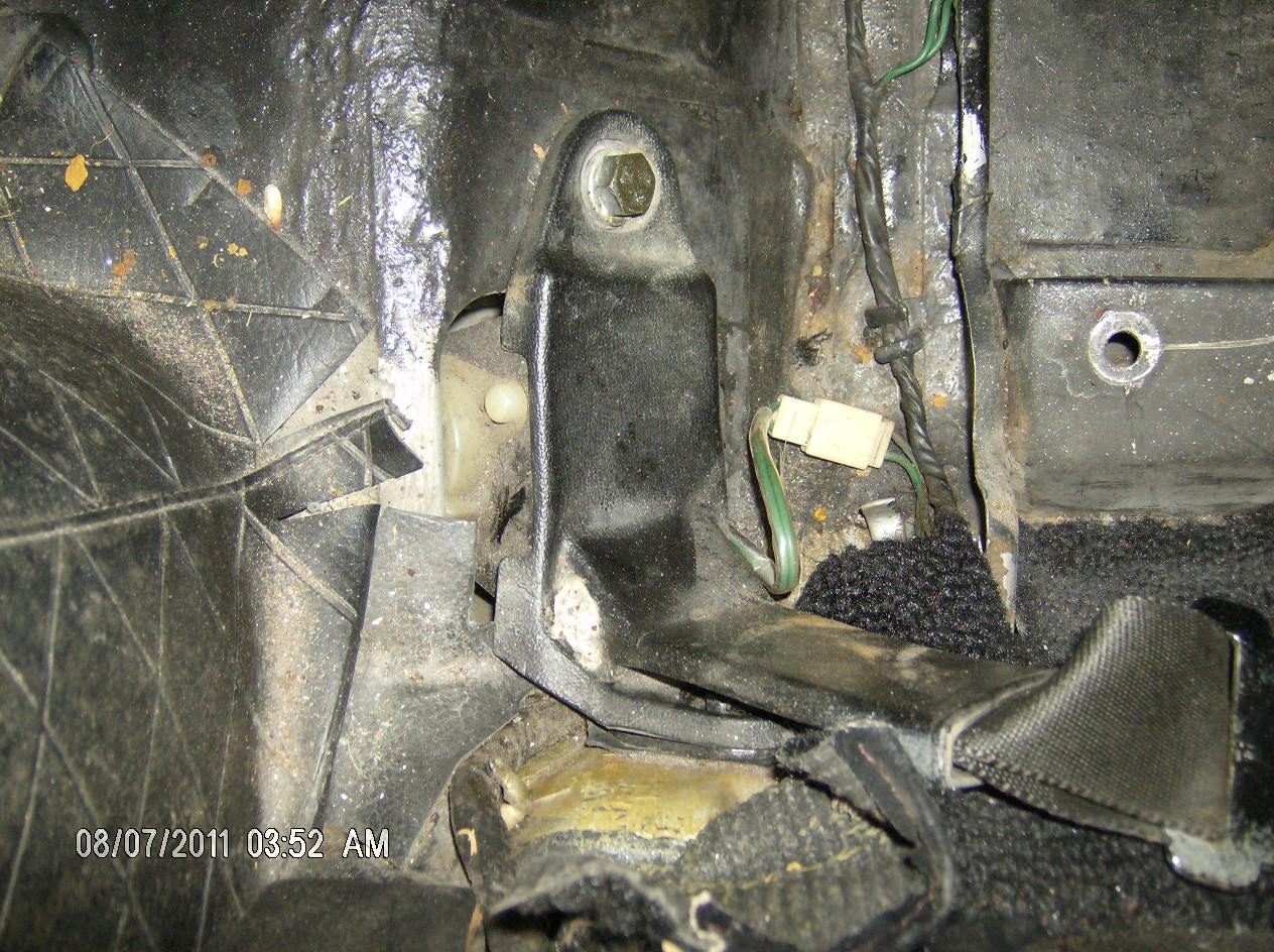

You're in luck, I have the pasenger seat out of my 73 today. I can take more if you need them but my camera batteries need to be charged, let me know.
That's what I was looking for.
Any chance of a few more picks, different angles and the look from behind is possible?
