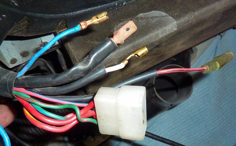

Here is the wire bundle coming out of the centre of the dash on a 1971 240z:
Here is one part of the bundle:
Q, what do the blue, white and red-with-blk-stripe connect to?

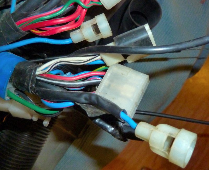

Here is the other part of the bundle:
Q, what do the blue fused leads and the connector with the blue, white and white-with-blk-stripe connect to?

The blue/white probably goes to the fusebox blue/white bullet connector you described in your fusebox post.
The blue with fuse holder might be associated with the fan.
The white, white/black, blue connector is DEFINITELY for the radio.
The red/black might be for the reverse lights circuit.
Just remember to keep the magic smoke inside the wires. Oh, and you might want to do some continuity tests to validate my answers.
