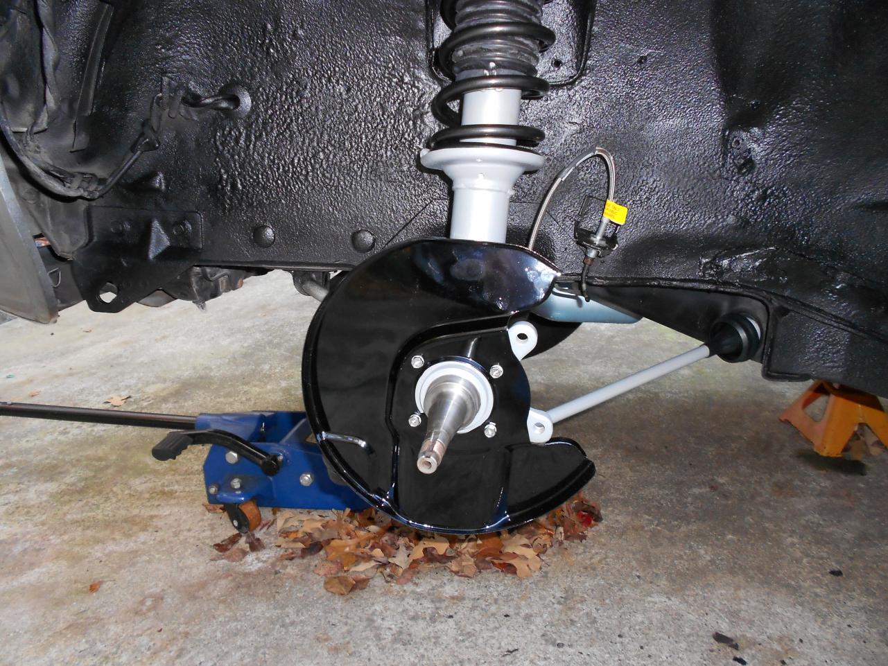

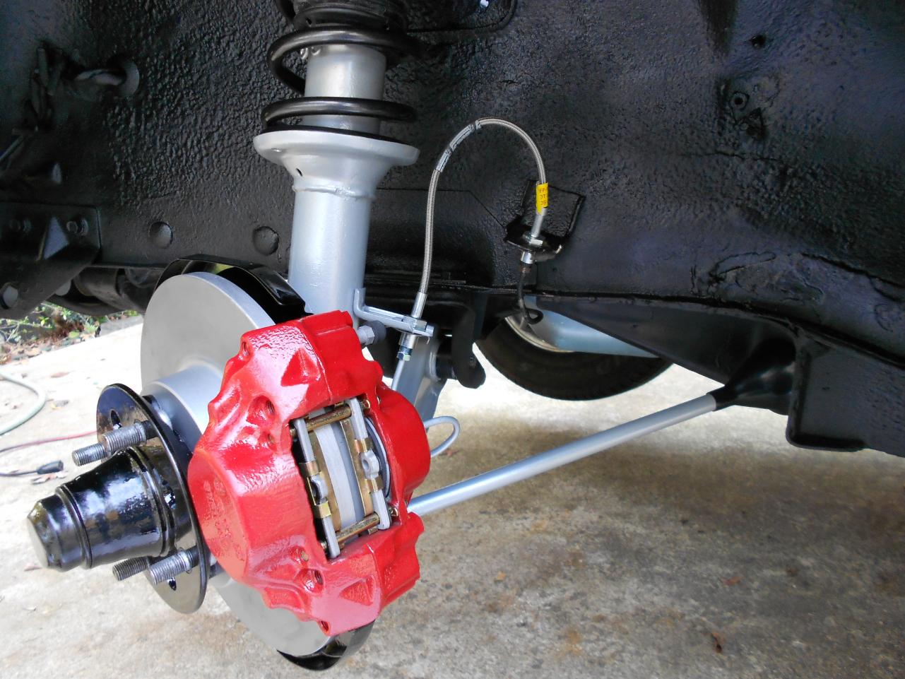

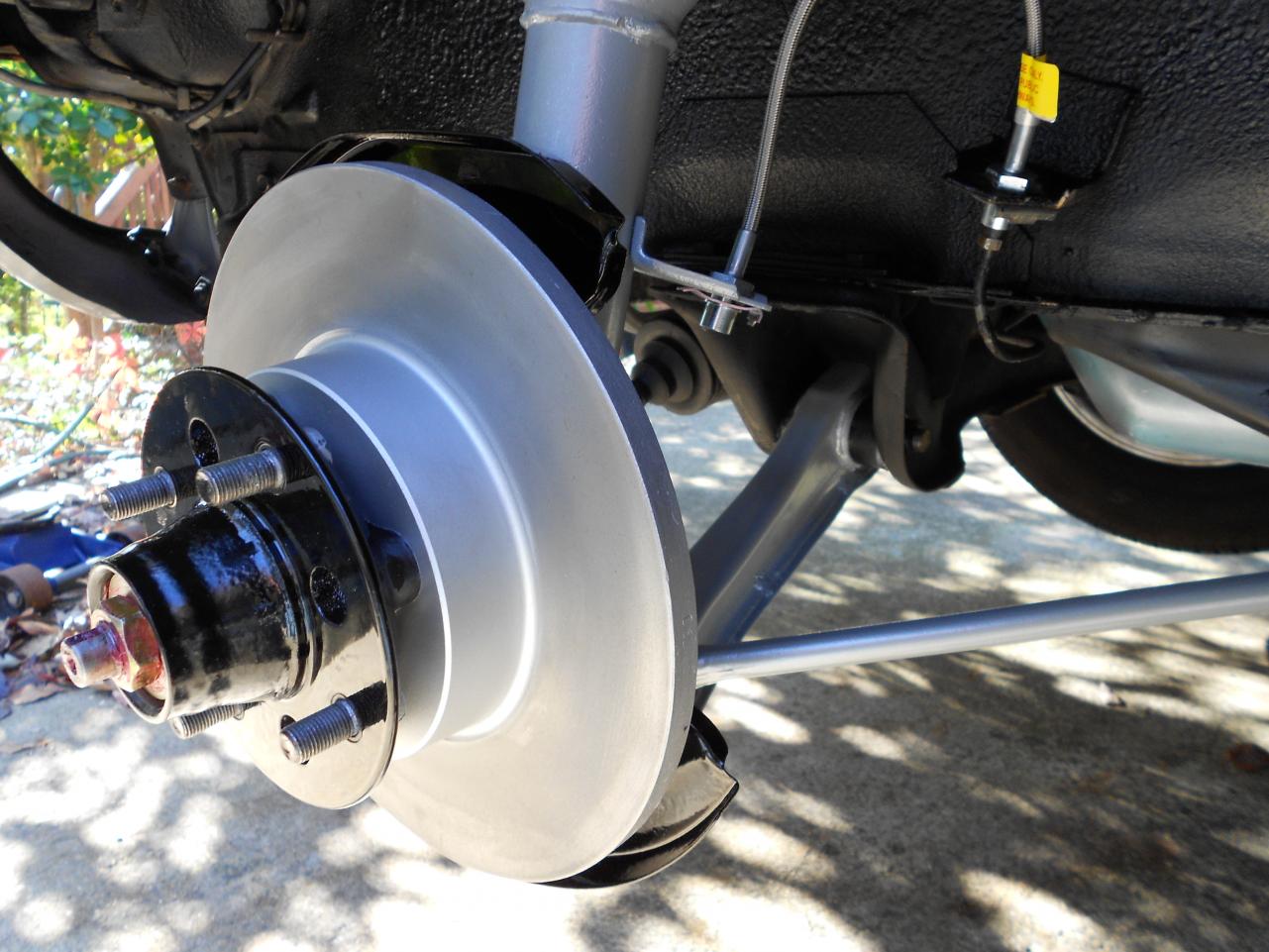

I found a guy to do the strut tube, t/c rod and control arm in silver, backing plate, hub, and strut/spring cap done in black. All parts had to be cleaned up of a fair amount of rust and had the guy sand blast the caliper and a couple other items. For one corner the guy wanted $130. He started out at $260. Sounds high but to do all 4 corners is sounding like $500. I was hoping for around $300. Maybe I need to get a cheap oven and the Eastwood kit.

Went with the $130 powder coat and finally got the parts and back together. Looks like new. :classic: Now on to the rears. I guess I need to take the little yellow tag off on the SS line.

I have a silver Z and rather than go with the standard black, I wanted to bring some color to the suspension. The silver in the strut, control arm and tension bar matches the car. I debated the red caliper for a while and just went with it. I am in quandry with the rear aluminum drums as I am thinking of cleaning them up and just hitting them with clear high temp. I added tokico illuminas and eibach progressives. When you take these crusty rusted parts out and they come back silky smooth - not bad. It does take some $$$.
